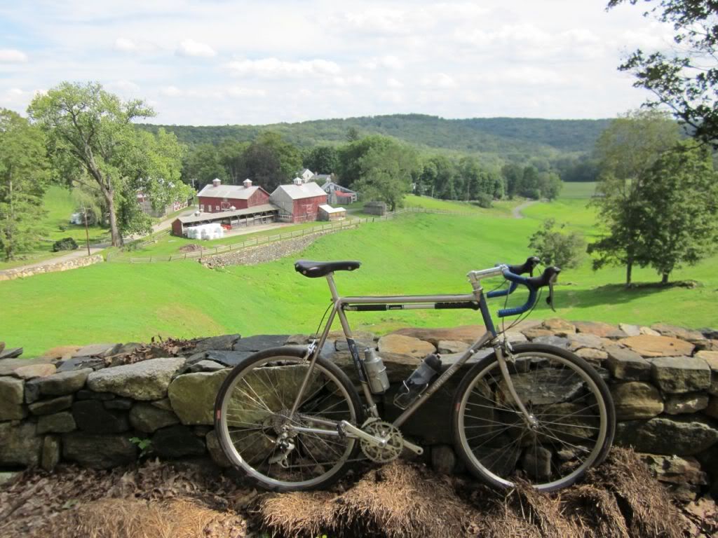

sante 2x9 friction DTs, 94 bcd white cranks with 46/29, rear h3 to grand bois, front novatec (lol) to velo orange, hetres, kog fenders, brooks professional, technomic, random 46cm wide deep round bars, v-o bar bag, carradice
I’ve changed it slightly since this picture, but you get the idea:
DSCN1661 by Taylor Kruse, on Flickr
