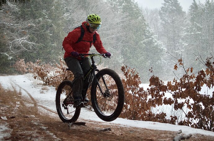

I ride 29+ and I got Kelley on a Krampus because it was on sale and cheaper than replacing wheels/drivetrain on her Ogre. She is about 5’7" and rides a Size Small Krampus, which is a ridiculous looking bike, but she loves it. I don’t think height is absolutely correlated with wheel size, you can futz around on a big-wheeled bike if you think you might like it.
29+ is awesome for momentum. It’s awesome for rolling over everything. It’s awesome for bikepacking, like really awesome. But, it’s not nearly as much fun on shreddy singletrack as a slightly smaller wheel size. I liked my 29er with 2.4" tires better for singletrack, and that’s only a half-inch narrower. I like 27.5+ even more.
I agree with others that 27.5+ with a proper 3" tire instead of 2.8 ought to be the right way to go on your Wednesday. But, the 29+ wheelset is also fun in it’s own way, and if your use is more “Explore the Beautiful Forest” than “Shred The Fucking Forest” you might like it. I’m definitely the former.
Kelley’s Krampus:
