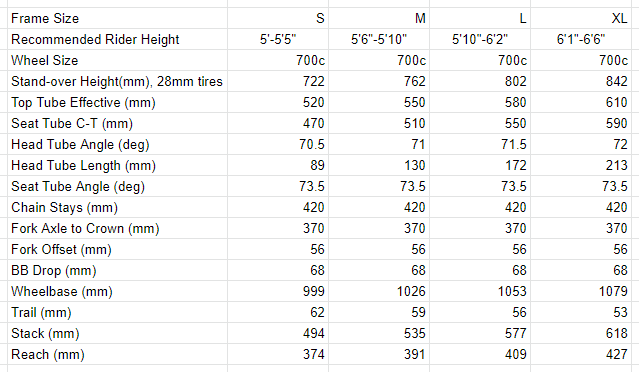

A guess from the nosebleeds
73/73
6-7deg tt slope
858 standard tubing (25.4 tt/28.6dt&st), 9/8 headtube (actually 34)
430x75 chainstay/drop
380ac, 51+ rake
Wishbone SS?
Those are 32mm tires but it fits 35

You’re close, but some key differences. I think the slope is correct (i dont have all the drawings in front of me), but the tubing on the small and medium get 25.4 8/5/8 TT, 28.6 8/5/8 DT, Large and XL get 25.4 8/5/8 TT, and 31.8 8/5/8 DT. HT is 9/8", ST is 29.8->28.6 1.2/.6/9. CS are 420, with tapers and dimples. 38s max, optimized for 28 & 32s

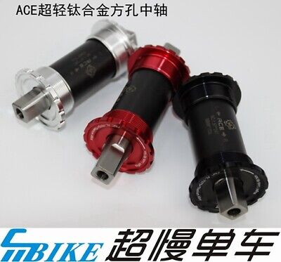

chinese folks started making new high end square taper BBs ?
slightly lighter than White Industries Ti for 15% of the price
the sleeve means it shouldn’t need adjustable preload with a lockring like WI, from there using the external cup tool interface was an inspired choice
