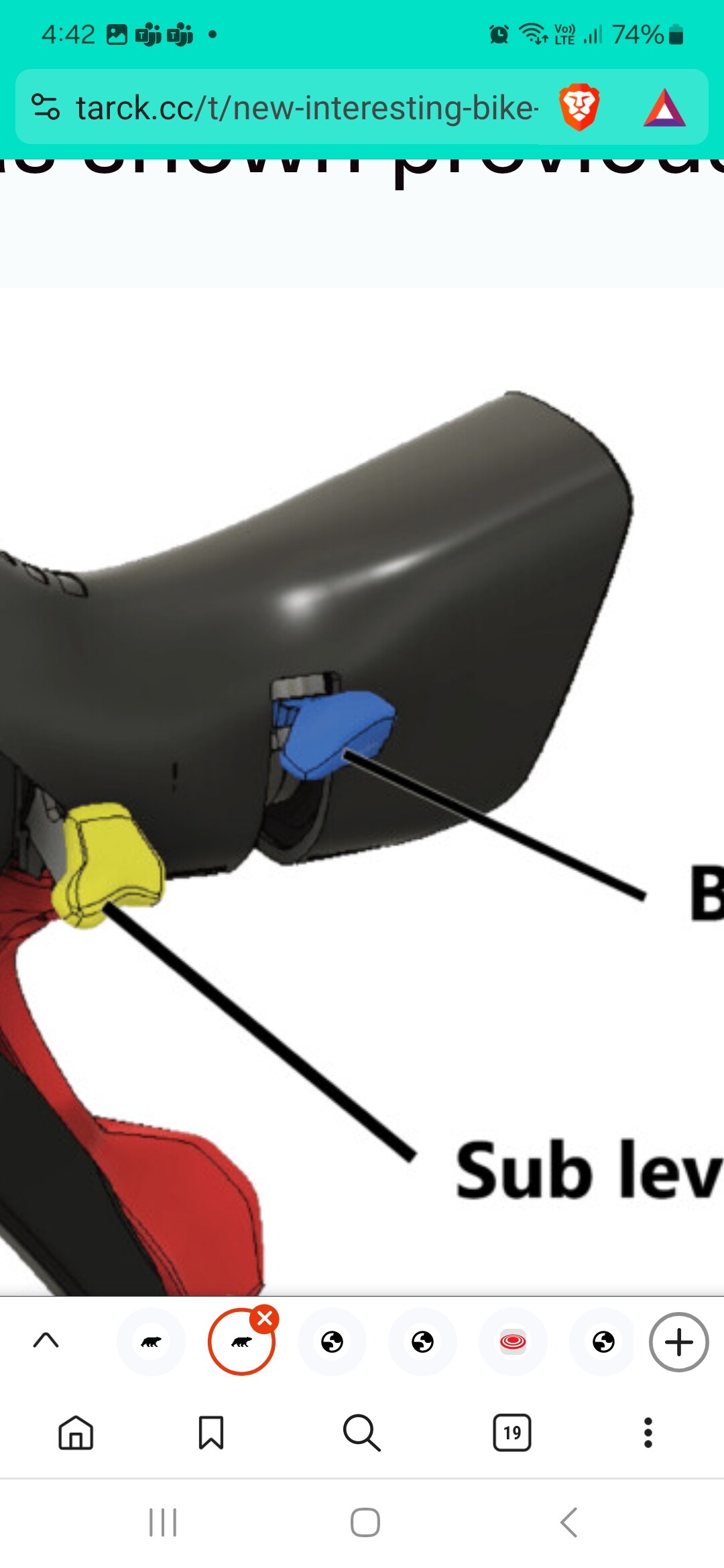

It is stepless, so completely smooth. It doesnt have any microratchet feedback. The bike is currently st the office so the next time im there ill take a video.
Lever A pulls cable, lever B releases tension, just like campy.

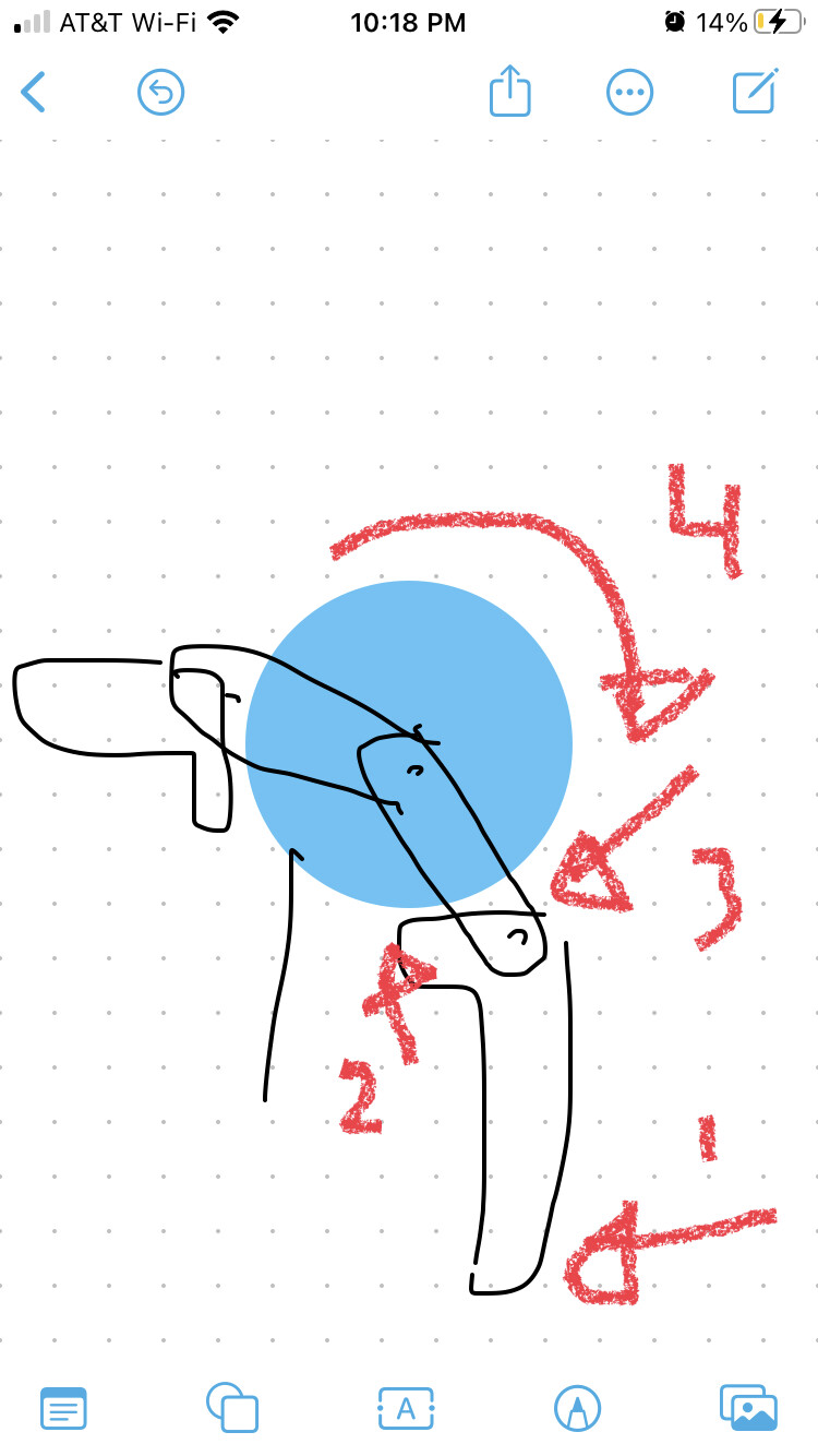

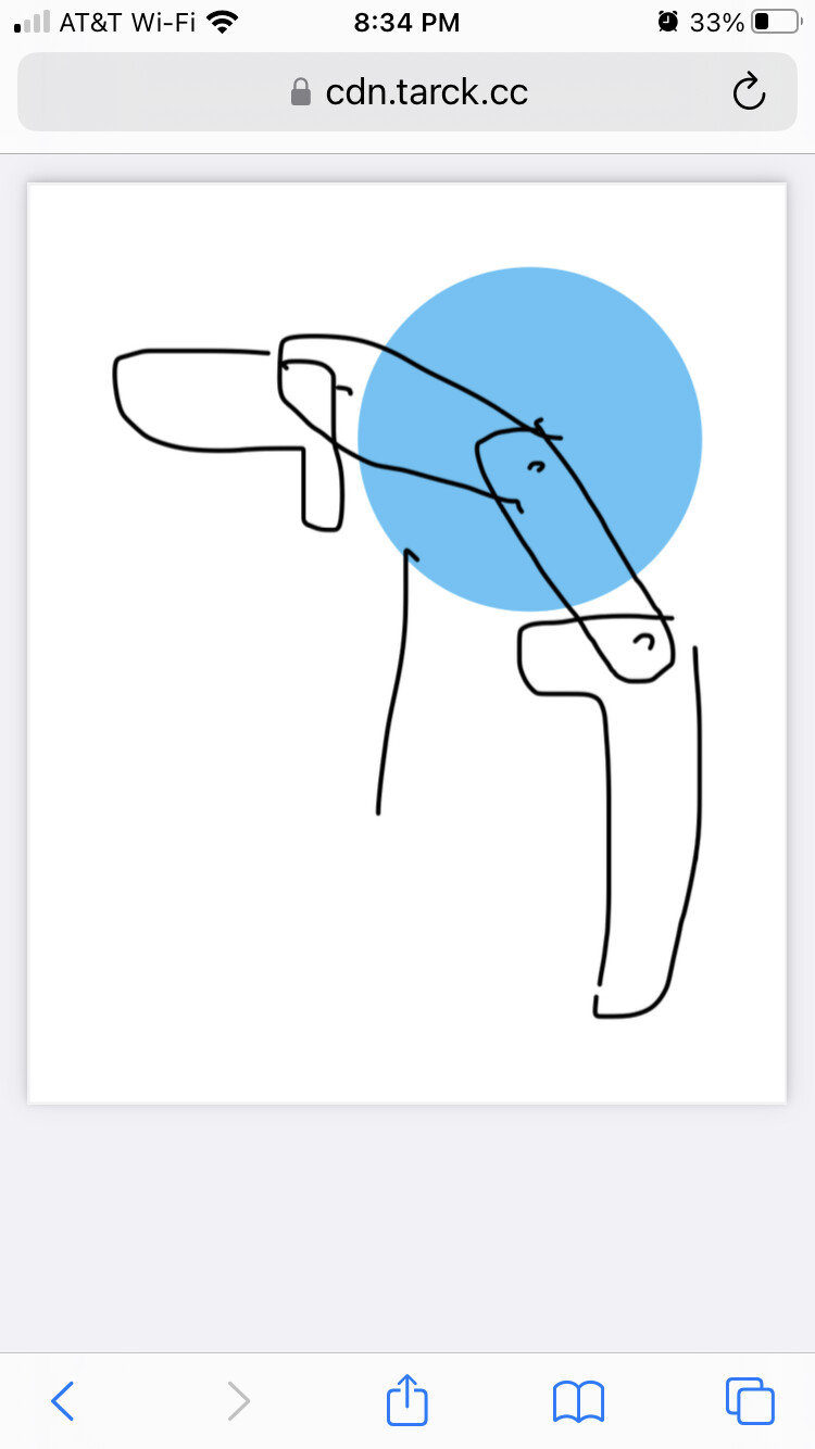

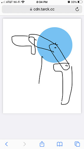

Like this. Springs at the pivot points, the first little bit of travel grabs the drum and the rest turns it
You’re aware that the drawing makes no sense, right? If anything, I’m more confused now.
Blue circle is the little drum the cable wraps around. It’s just like an old school friction shifter except no fixed lever. The horizontal and vertical things are the shift levers. When you push on the end (1), first the outer L shaped piece rotates a little bit so the short part of the L engages with the edge of the drum(2), maybe via teeth. Once the short L segment has engaged, the force applied to the end has nothing to do but turn the whole drum(3-4). Let go and springs take the lever back to its starting position but the drum remains shifted.
One shift lever pushes the drum to take in cable, and the other pushes it the other direction to let out cable, just like pushing on the lever of a regular friction shifter.
I don’t know how they actually do it but this is one concept that could work.

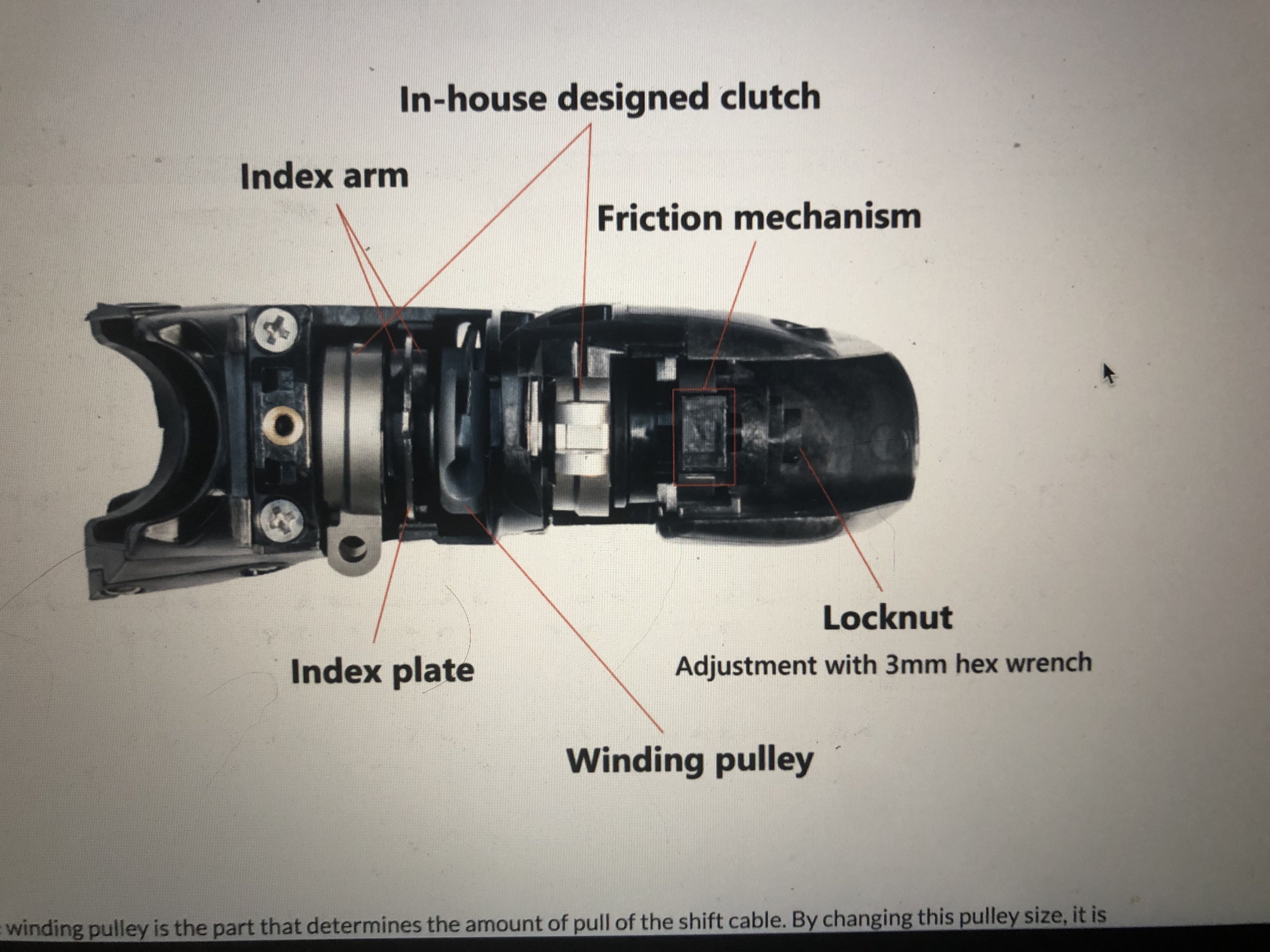

So it basically works like I said except the components are spaced along an axle for better packaging and the lever mechanism is replaced by an “in house designed clutch” with equivalent function.
Yeah I guess that kinda makes sense. I wanted the cable release to work like an indexed shifter, so of course that wasn’t going to work. The “clutch” holds the cable in place whether you are shifting up or down. Like a friction shifter. Lol?

it works exactly like a friction shifter from both a pulling and releasing perspective.
but instead of one lever that you push or pull, you have two levers, each of which are connected to the friction mechanism by a one-way roller bearing (“by an onyx freewheel”). So each lever can push the friction mechanism one way, but can’t pull it the other way - when you stop pushing each lever, a spring makes that lever freewheel back.
Ahhh yes! I hadnt noticed the amount of stroke visible in the LEVER B graphic…
