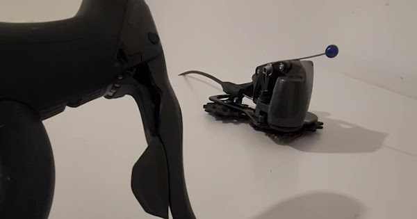

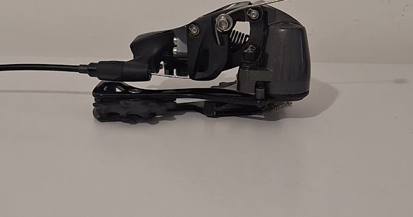

How safe is this? Y’all not gonna hack into my main-frame ?
Growtac Equal Control levers.
