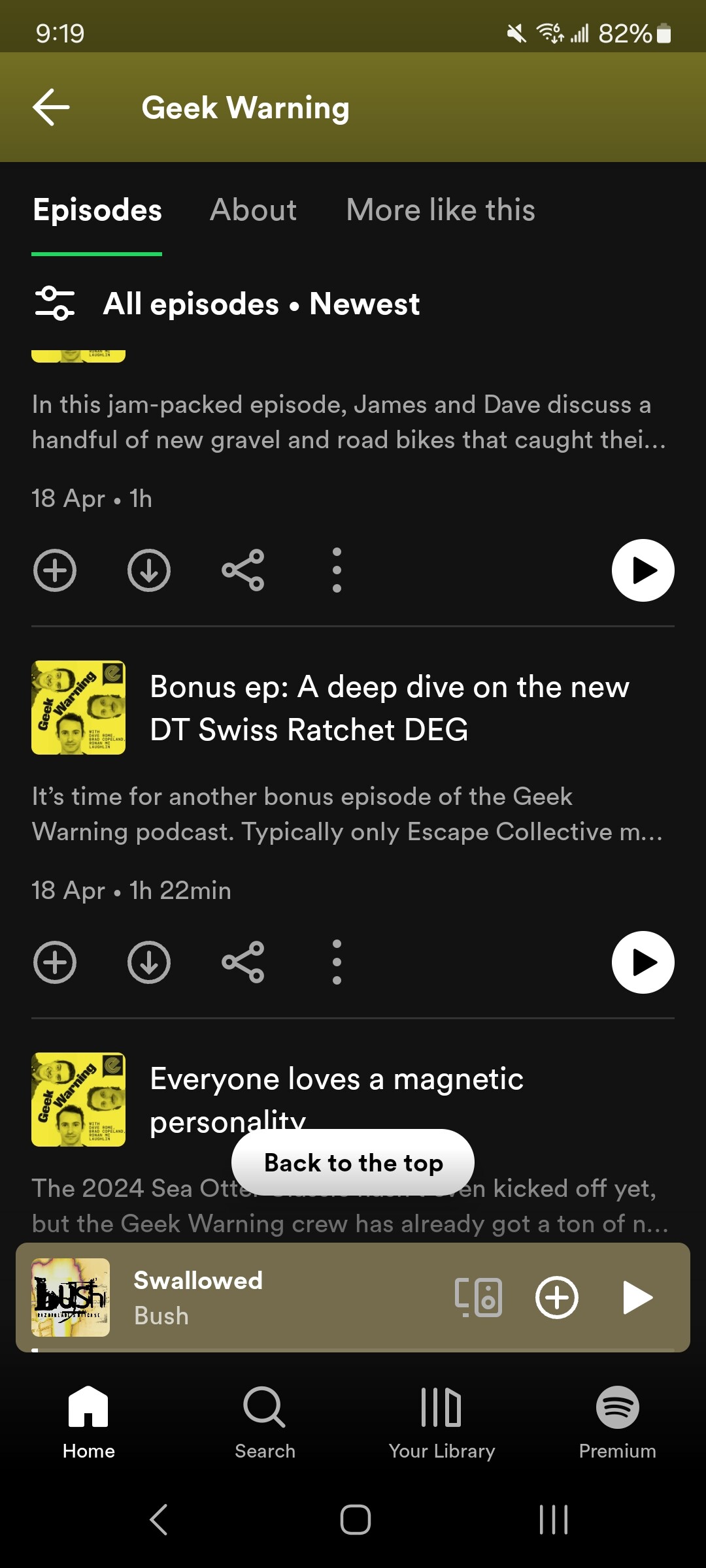

There was a massive DTSWISS episode on The Geek Warning poscast a few episodes ago.
Jesus 82 min worth?

Yeah. Was way TMI for me. I would be wanting to be paid to talk about something for that amount of time if it was my podcast. There has to be something going on. The angry asian has gone so I get the impression the crowd funding model is not able to support them fully.
