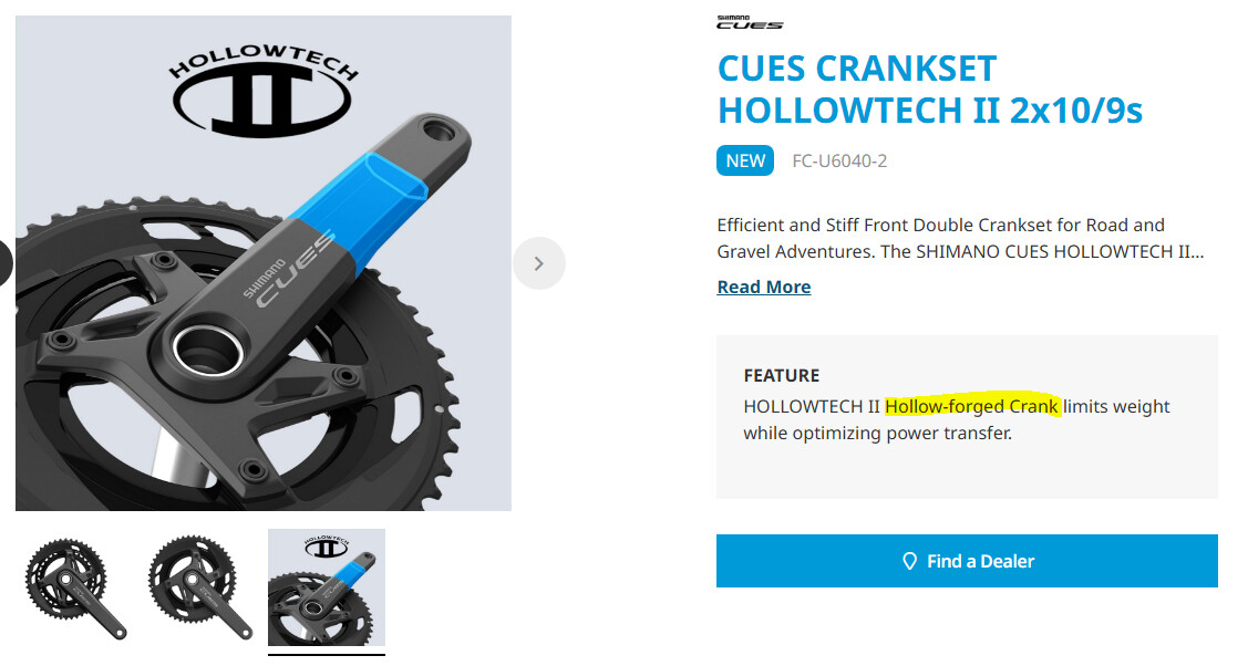

Did I miss this in earlier CUES chat? The arms on the 8000/6000 level CUES cranksets are hollow forged?
This seems at odds with the specifications page:
Can’t find weights for either crankset, seems more like a miscommunication somewhere.
no, that’s correct. FC-U8000, FC-U6040, and FC-U6010 are hollow forged. FC-U6030 and FC-U6000 are not.
The checkmark next to “Hollowtech II” means it has hollow arms. If it’s a solid arm with a weight-relief scoop out the back, but still uses a Hollowtech BB, the “2-piece crankset” is checked instead.
The “Hollowtech crank arm” line appears to be for octalink cranksets that are also hollow-forged arms
I thought HT I was octalink BBs and HT II is crankarm with integrated 24mm spindle and external BB cups, and doesn’t relate to the arms being hollow or not (eg FC-4500 is HTII but C arms).
And a ‘Hollowtech’ crank arm is the one with the hollow forged arms (not sure what the current glued arms are referred to as)
it’s a complete mess of marketing mumbo-jumbo and they’ve overloaded the term “hollowtech” to refer in different places to either the BB or the crank arms, and exactly how they refer to things has changed over time

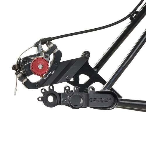

Did you actually make a prototype for that, um, solution?
i didnt make shit.
but yeah surly 3d printed some shit that probably can be ridden for several minutes.
Hopefully out of plastic, because that would have been perfect.
