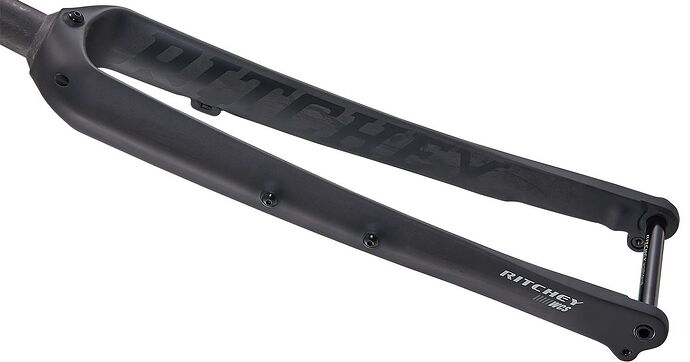

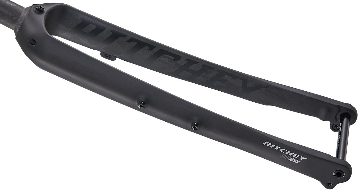

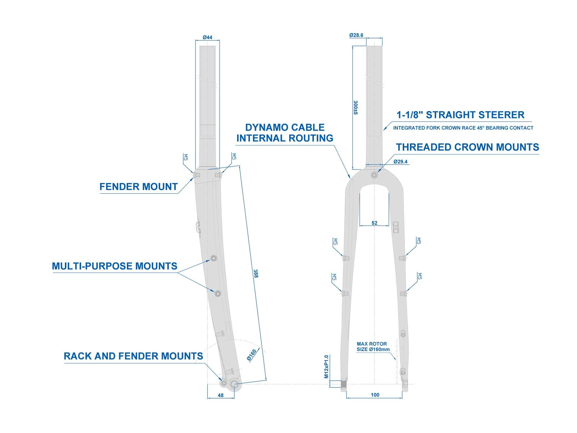

Is this new? Appealing for 9/8" dead-enders (me)
looks like a new name with dynamo routing and 2-pack instead of 3-pack bosses
Ritchey and their OEM have been making versions of this fork for about a decade now without being loud about it
the design essentially produces a tapered steerer with continuous fiber layup to the legs, but compressed vertically so that it occupies the same space as a crown race would — so congratulations metal bike nerds it’s a safe modern construction fork with an integrated crown race
Straight tube and 100 makes me want to buy one to stick in a drawer

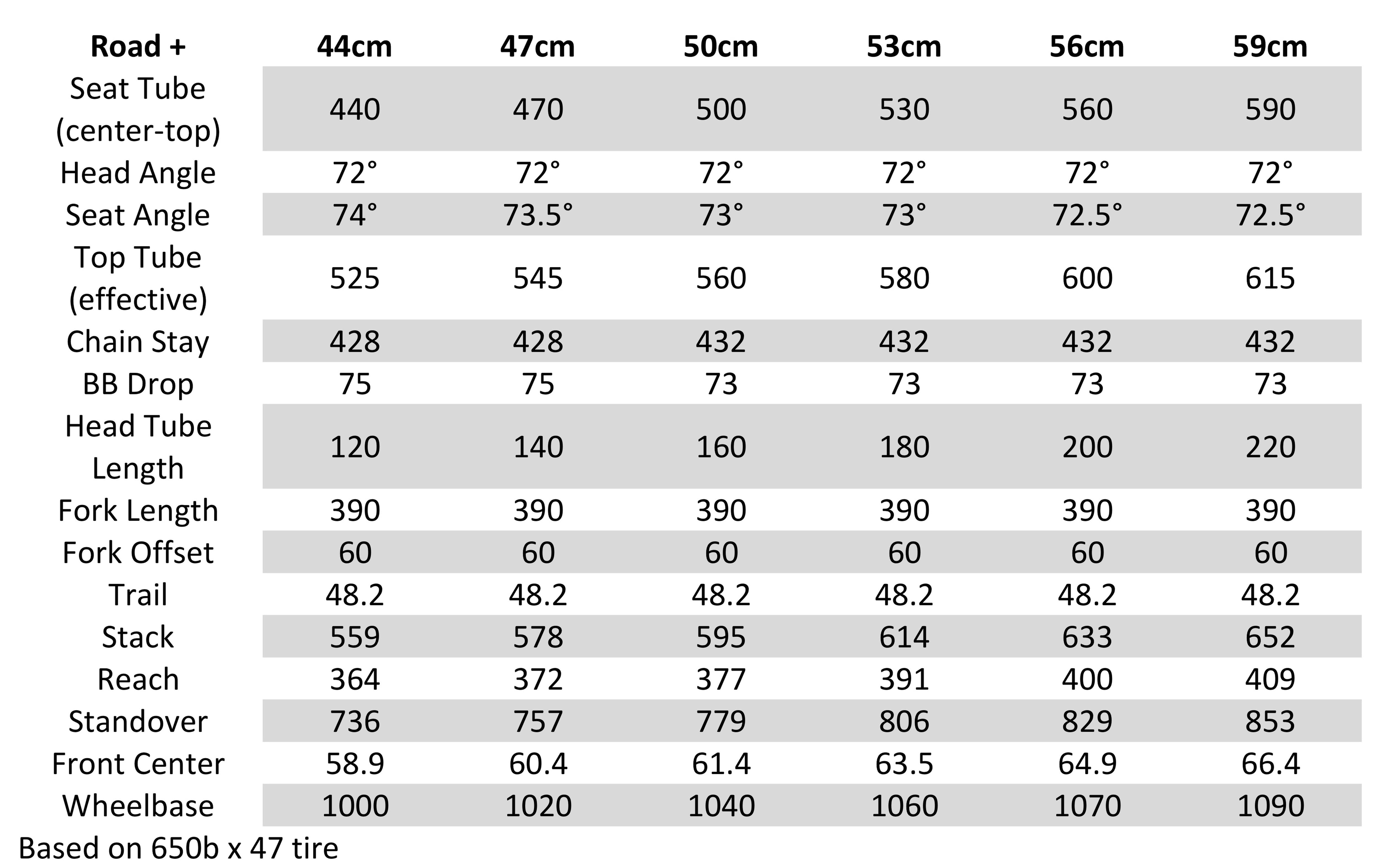

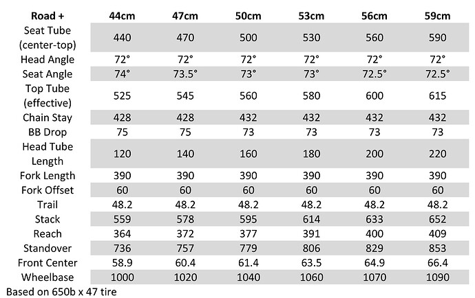

Can you tell me if this would be appropriate geometry as a replacement fork for my BMC Road+? I’m guessing the answer is no, but having a hard time finding any appropriate carpet fiber fork for it. Fork geometry confuses the heck outta me.
You’re going to have a hard time finding anything with a similar 60mm offset. The axle to crown is right but the offset is much lower so it is going to handle a bit differently. I’ll bet you’re used to it after a ride around the block. Also, it will be maybe not as good with a fully-loaded handlebar bag but again, I bet you’ll be used to the handling almost immediately.
It will change the trail value from a median Bush II administration value to a median Obama administration value
It’s the same length so the angles stay the same and nothing else changes
Short answer is you’re gonna be fine
