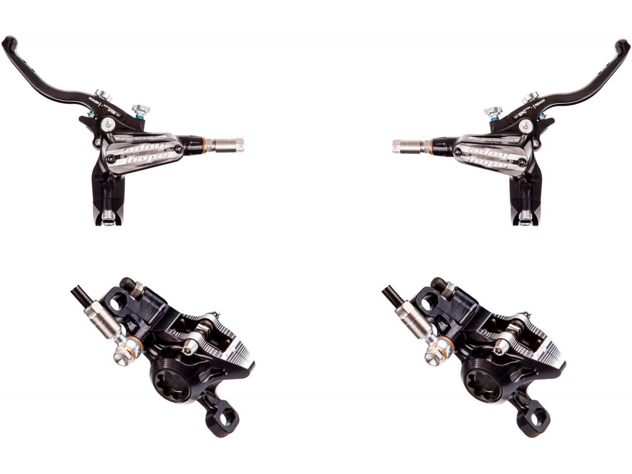

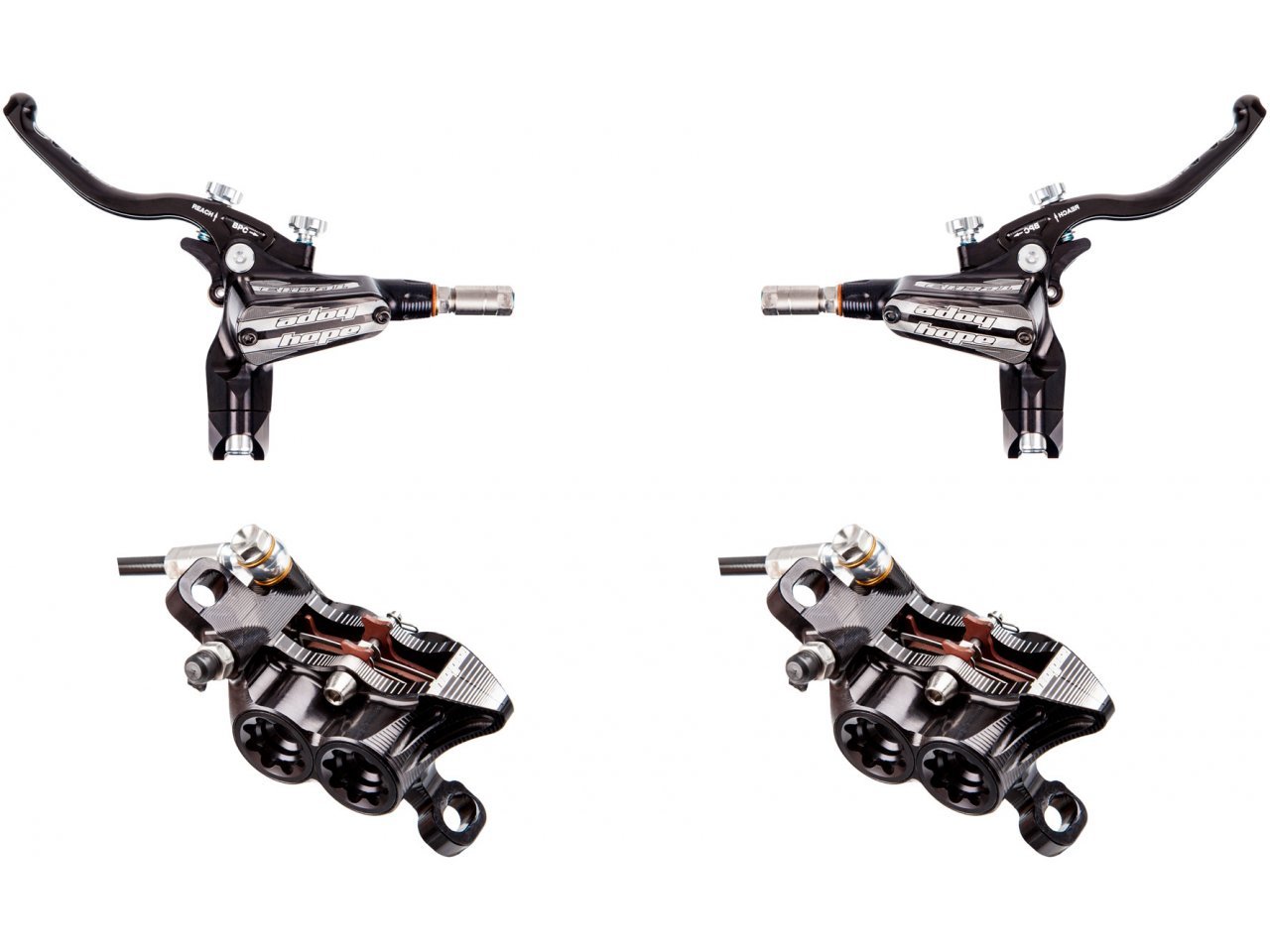

I have hopes on both my mtbs, E4’s on the big one and X2’s on my ht. They use the same lever and everything, E4’s are dual piston and the X2 are single.
Buying them from the UK or Krautland™ wasn’t/isn’t much more expensive than buying a nicer set of Shimano/SRAM brakes. But maybe SRAM is almost free in the US?
From the UK
E4’s
https://www.chainreactioncycles.com/us/en/hope-tech-3-e4-brake-no-rotor-2019/rp-prod185567
X2’s
https://www.chainreactioncycles.com/us/en/hope-tech-3-x2-brake-no-rotor-2019/rp-prod185568
From Krautland™:
E4’s
X2’s
