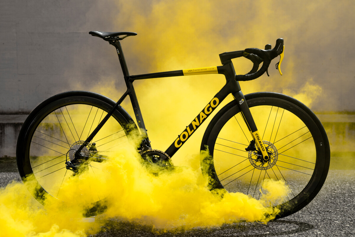

Gaaah It kinda kills me that the legacy Euro companies are doing this kind of thing now. Colnago’s NFT was goofy, the Pinarello forays into gravel make that full sus lefty Cannondale ebike look cool.
I can’t be the only person who has a huge soft spot for the cool, bare-bones alu frames Colnago, Merckx, Basso, et al were cranking out around the turn of the milennium. I guess there’s no way to crank up the Billato shops again and do relatively cheap fatte a mano en italia production, but here’s to wishing they’d at least try it instead of doing stuff like this:
