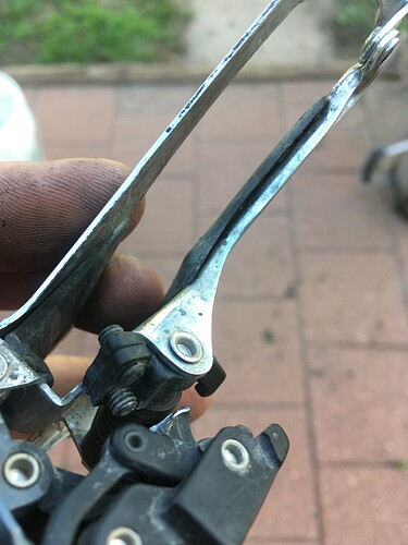

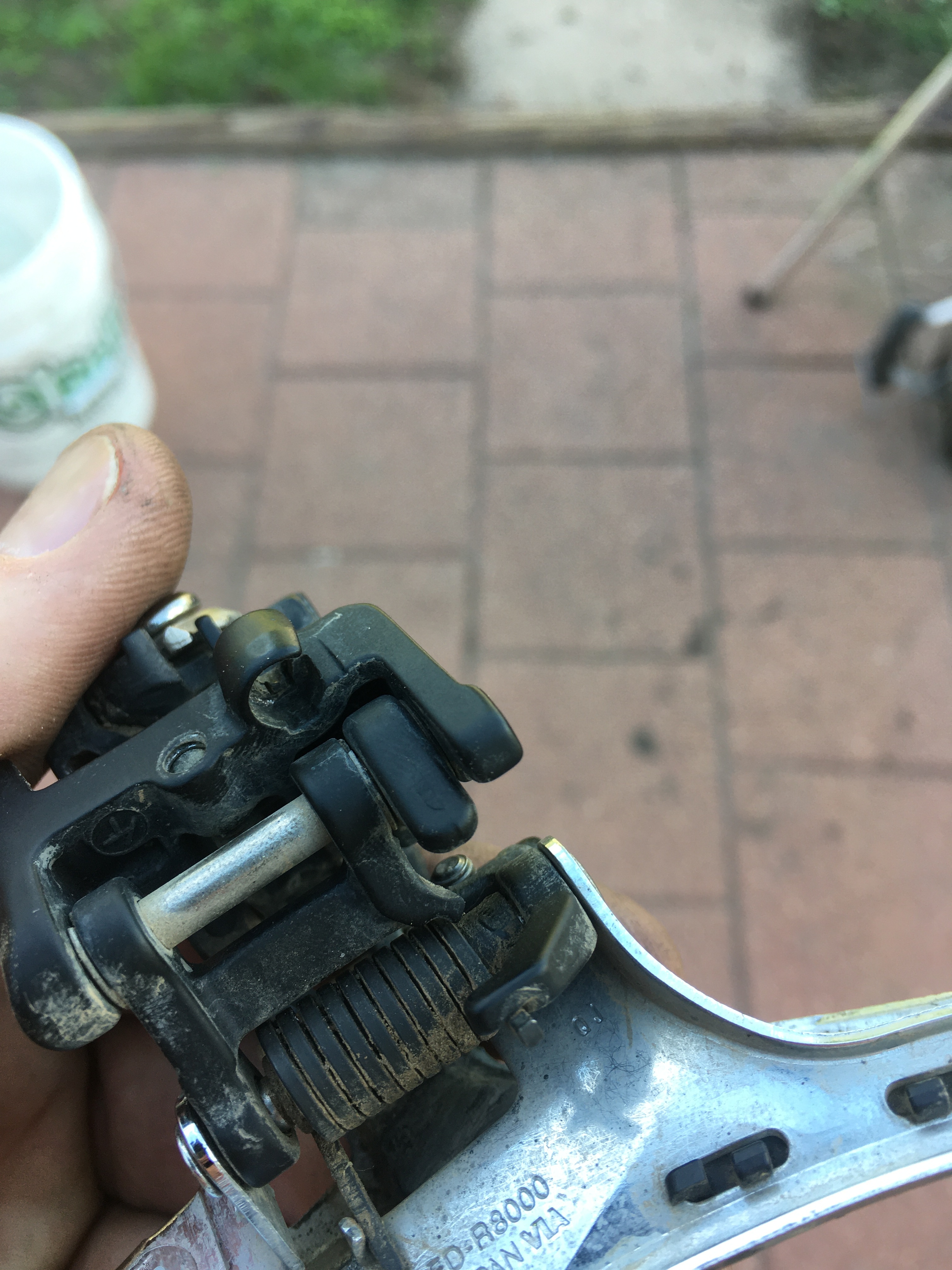

Ugh, bent my pusher cage today. I was pedaling through some bumpy stuff and my chain got too rowdy on my 46t bikingreen ring. It got kind of a crosswise set and my body weight did the rest.
It’s done this in the past but while soft pedalling.
Does anyone have a thing they do to keep this from happening?

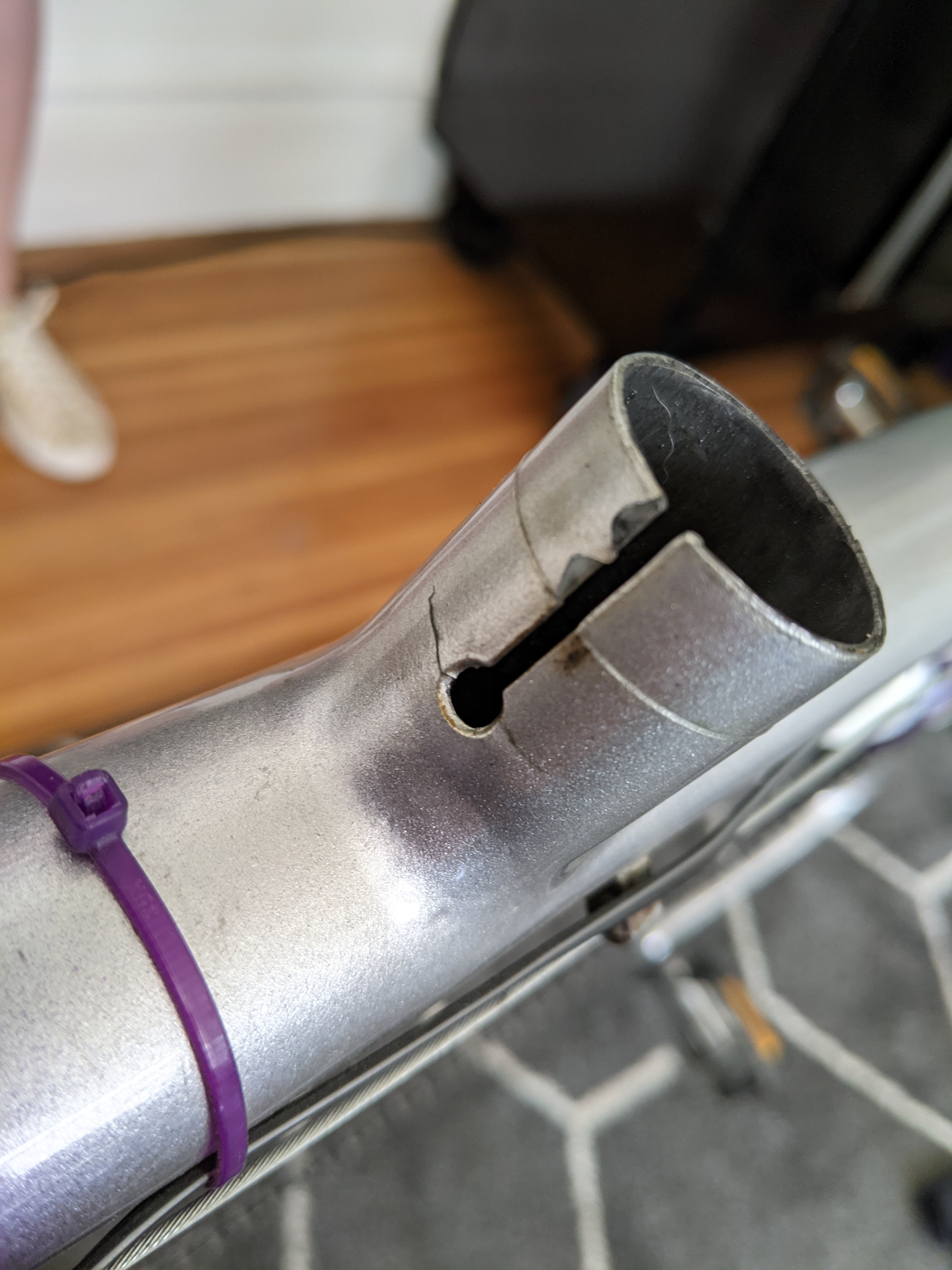

i’m actually in shock. i feel like i lost a family member. hoping repairable?
I am not a frame buildeur, but I see that as 100% repairable.
That’s fixable. You should get it repaired. It’ll be a heckova lot cheaper than a new frame. I too am not a buildeur, but I’ve seen those repaired by flowing some brass into the crack. Another option is to drill a hole on either end of the crack to prevent continued propagation. Worst case scenario, the seatube can be replaced.
It’s pretty close to the fillet though. I think even if we get it fixed, still probably putting a deposit down on a new Co-Motion anyways.
oh sick.
We are just very sentimentally attached to this one.
It’s also really bad timing bc we just bought a used travel Tandem instead of biting the bullet and puting a deposit down on Co-Motion then.
Does it fit well?
Get a new tandem section?
It’s not completely dead; I’d lop off the top of the tube, then sleeve an extension on to make up for the missing height (and get a REALLY LONG chairpost to cut down on the stresses at the top of the sleeve.)
I’ve had 3 frames with this exact failure mode fixed for customers. It’s about as easy as it gets.
