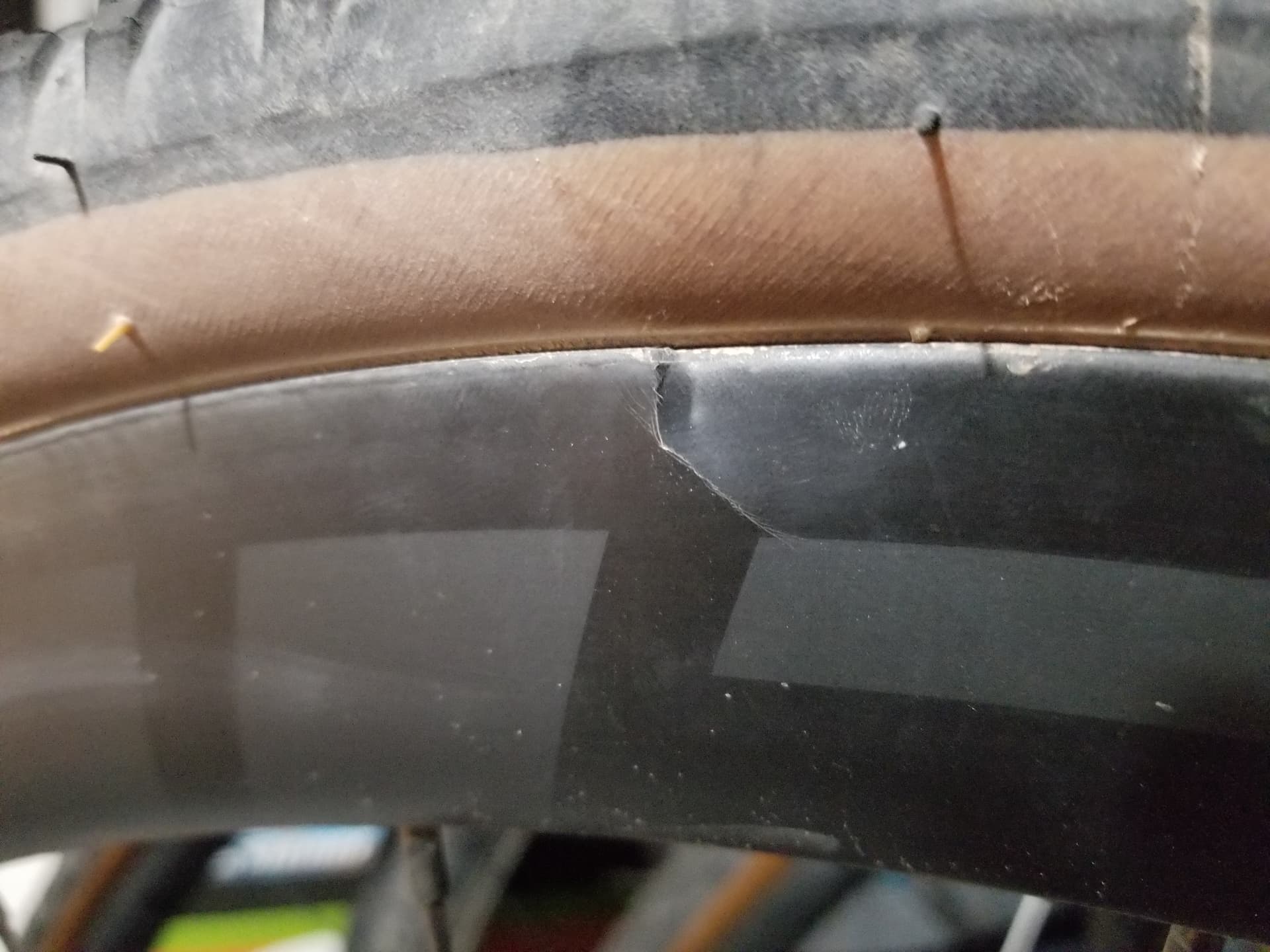

Along with rear tire, just noticed this as I was wiping down my bike. First ride.
Fuucck
How??
Damn. Didn’t you get those wheels like last week?
Oof, hope they have a good rock strike policy.
According to zipp site, protected against nearly everything while riding your bike.
I have no idea how/when it actually happened. I hit some rocks, as one does on a gravel ride. There weren’t any that stuck out as memorable, though.
This was my first ride on these wheels.
Cushcore cx would have prevented this. I’ll never go back. Bombing through rutted powerline cuts knowing that there is no way in hell I’m going to crack a rim feels good man.
I’m definitely coming around to the idea. Tannus vs cushcore vs vittoria?
having dealt with other tannus products i’d put money on vittoria being a better option
I can’t speak for Vittoria but cush core has been top notch. Was relatively easy to get mounted and not too back to remove to swap tires.
