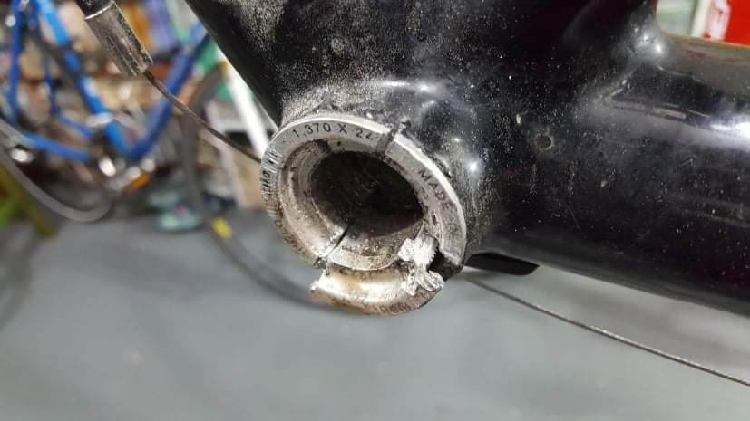

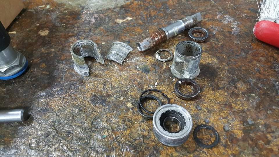

Looks like the other cup came out with non-destructive coercion and they smashed the innards out that direction. Pretty much the only good thing about square taper bottom brackets that are NOT UN2x/UN5x is that you can usually get away with this.

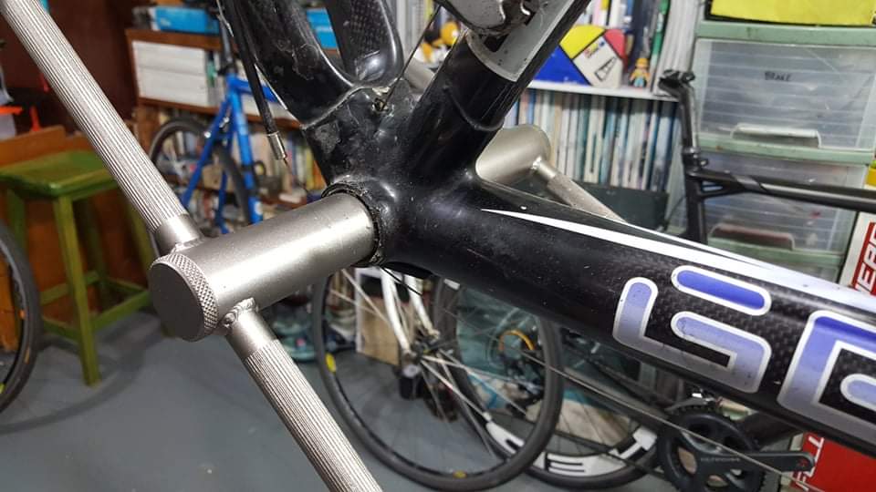

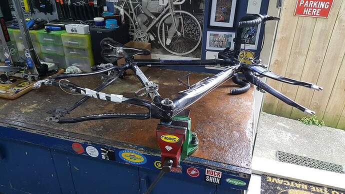

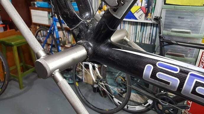

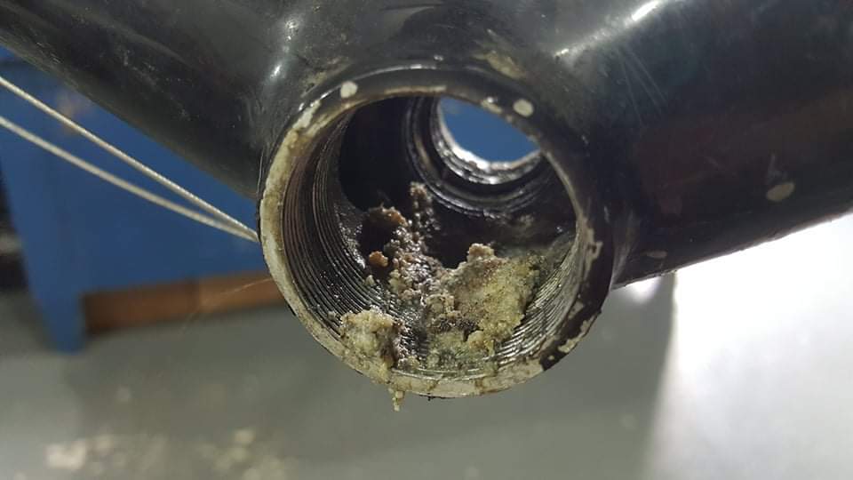

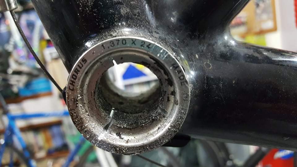

Oli said:

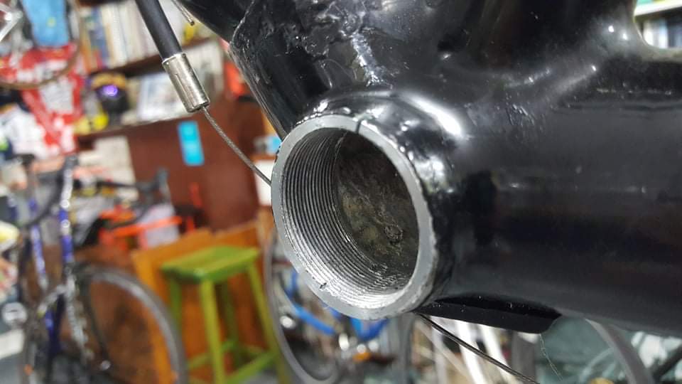

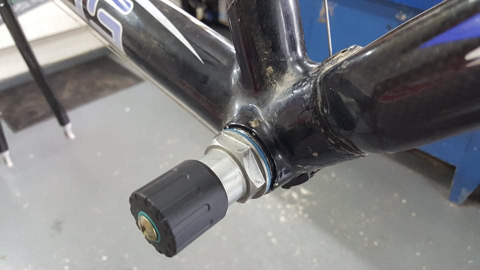

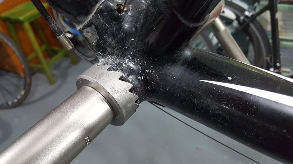

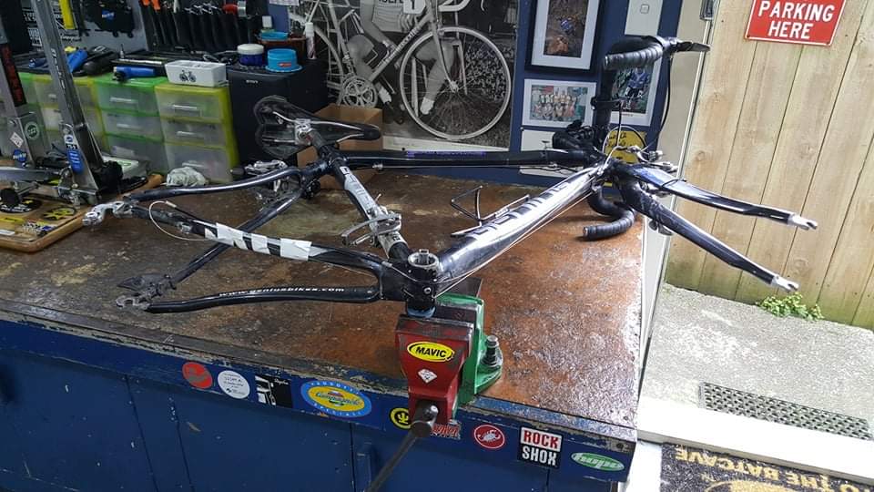

So shot 1 is a TACX tool that screws into the axle and clamps on, but even with the spanner and 1.25m bar it wouldn’t budge but the vice and turning the frame did the job for the nd cup. As you can see in 4 there was massive oxydisation/corrosion in the bb - l’d be concerned for some of the bonding between aluminium and carbon but no way to know how damaged it is. 5 shows the cutting. Once cut it still took a lot of PB Blaster, prying and hammering to break the galvanic corrosion bond and there was some minor damage to the threads and shell, but as you can see in 8,9,10 l retapped the threads and faced the drive side of the shell.
