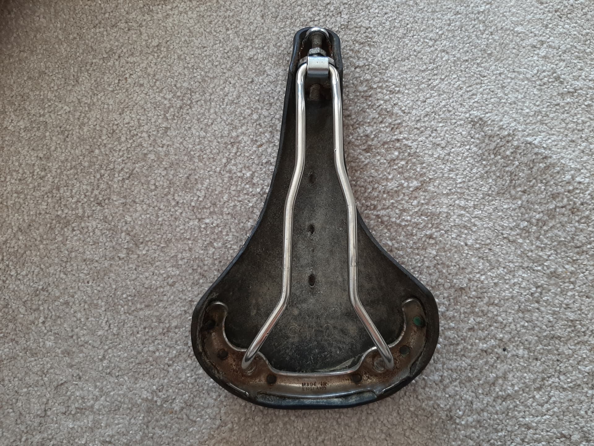

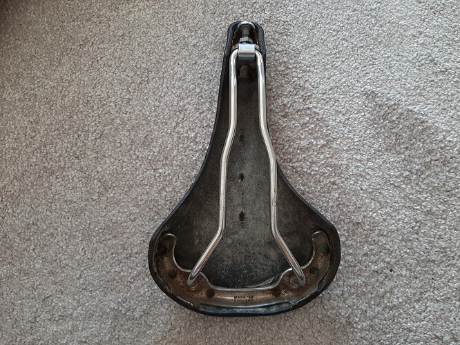

In the meantime, how the hell can I make my B-17 frame straight again? Its a very awkward thing.
might want to try drain cleaner (lye), assuming it’s stuck due to crabon vs aluminum galvanic corrosion
I haven’t had much success realigning brooks rails. You can get replacement frames for them for not too much money, but riveting them back together poses a challenge. We sell people the frames and refer them to a local cobbler for installation.
Thanks. Yep. I looked it over a year ago when I did it, seemed like getting the right rivets was a real pain in the ass too.
Cheers, it certainly is. Ok. How careful do I have to be with that stuff? Will it eat the carbon, or eat the aluminum? How long can I leave it in there for ?
