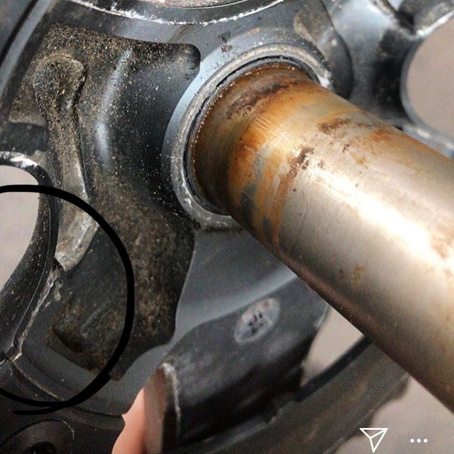

My da9000 cranks creak like whoa
Whoa, my cranks don’t creak at all. Are you by any chance using an adapter?
Naw he probably just has a failed glue bond and it’s slowly falling apart.
You should probably inspect them.
Failure mode leaves a sharp edge. I’m surprised I haven’t seen anyone seriously hurt yet.
Where to pay most attention?
Right around the inside flat surface of the crank is a seam. That’s a glue bond. That’s where I’ve seen the failure that isn’t the pinch bolts. You should check for cracks there too. Creaking is probably the pinch bolts. Or your BB is shot
:+1::+1::+1:
Check here.
Also look around the chainring bolt holes with the rings off. That’s were I have seen voids start.
I’ve only seen issues with da9k, but they were almost entirely started with internal corrosion that slowly separated the bond, which supports your theory. Pinch bolts often appear to be the issue because they will first crack right next to the bolt, but it’s a false correlation to assume someone over tightened. Once the bond is separating, it will crack here when you tighten to normal load.
Regardless, the failure numbers for 9000 and 6800 are very low considering the millions of cranks made that are still out in the world.
It also seems to take quite a bit of time for enough moisture to corrode the inside, which is I think why these failures pop up years after most of these cracks were manufactured.
