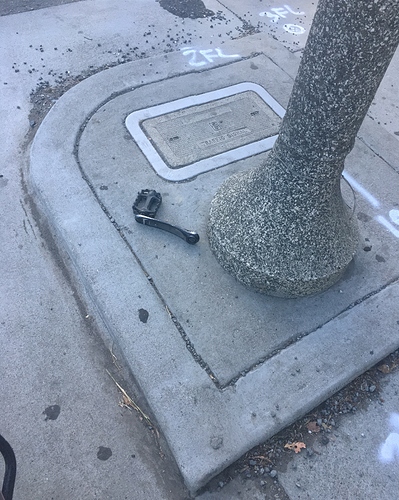

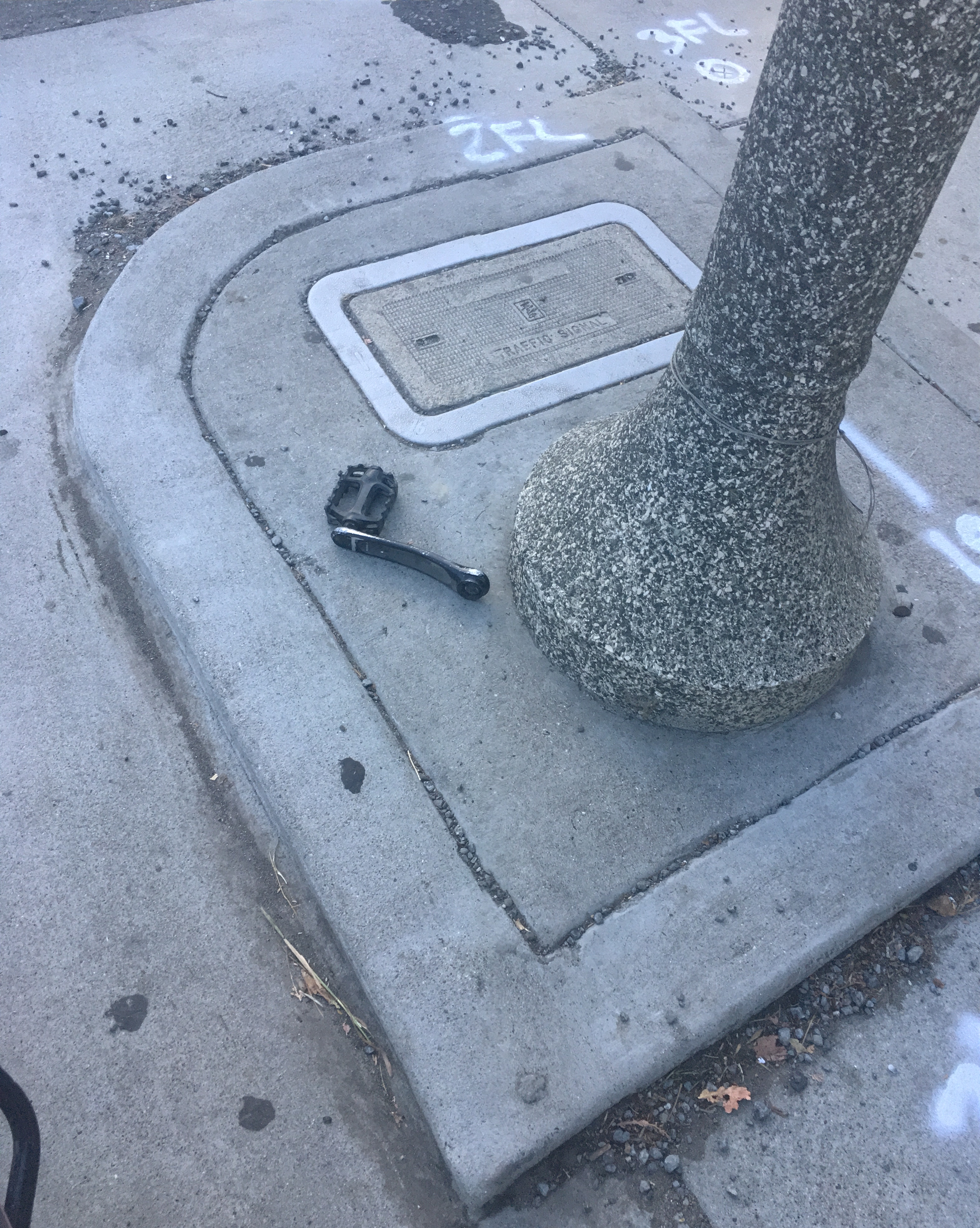

Oh dear. My condolences to the rider of this bike.

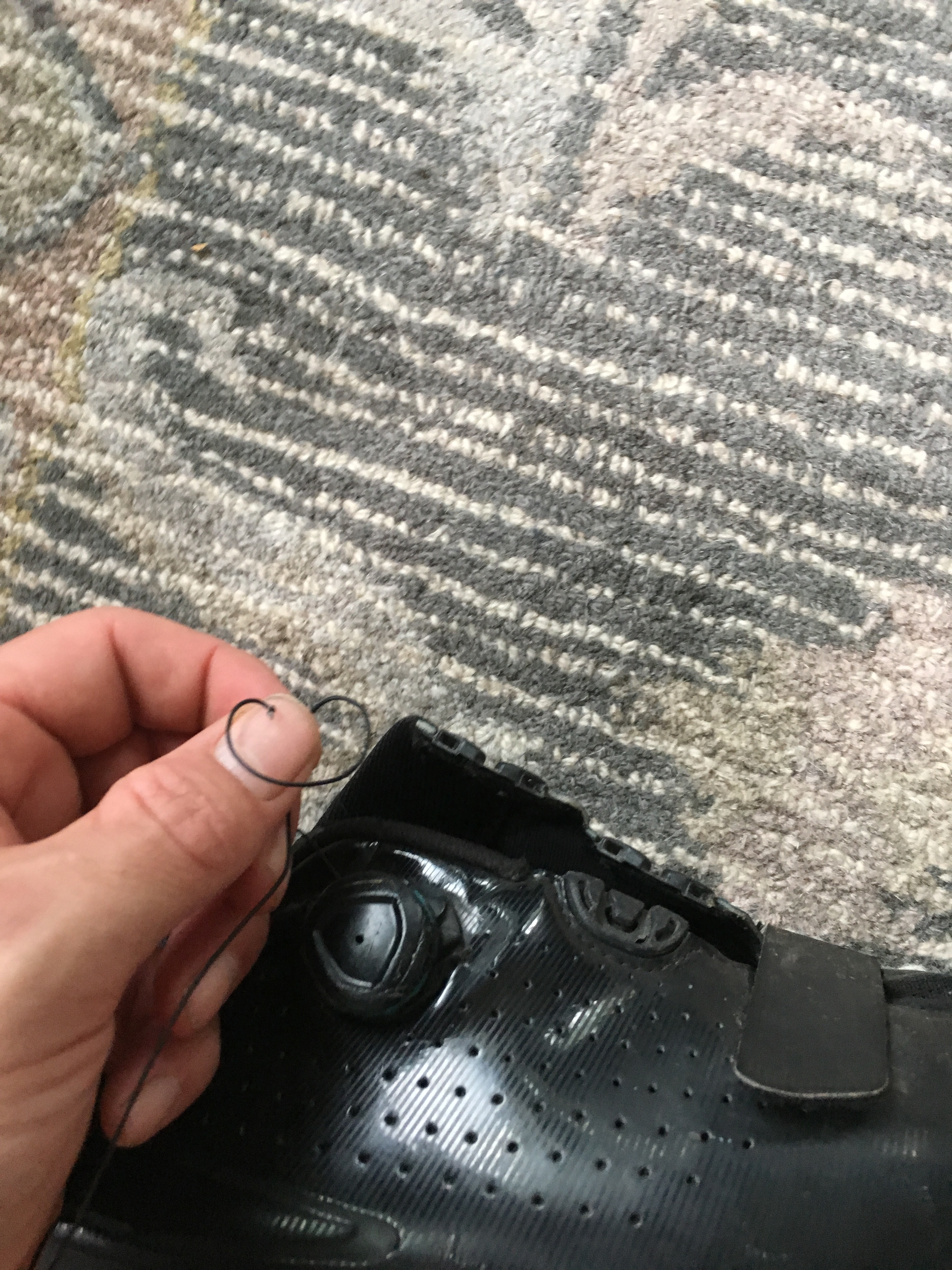

They’re sending me a set of replacement attachments for free but I am very annoyed.
I have to use my B-squad shoes and I hate them. What is even the point of clicky shoes if they’re not super, duper stiff? Flats & regular shoes are far more comfy

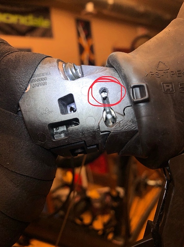

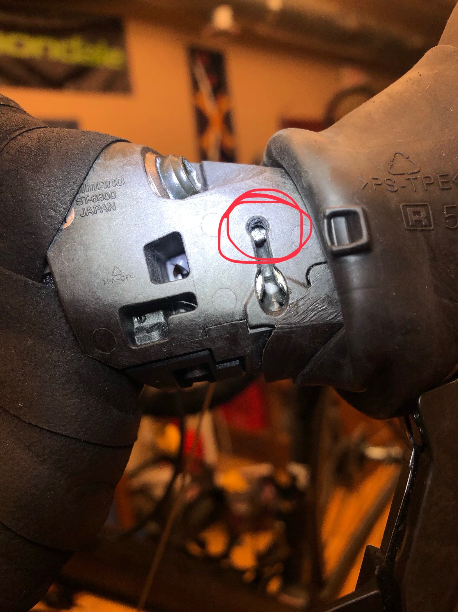

Any ideas how to get this stuck shifter cable out of a 6800 shifter? Can’t seem take these apart

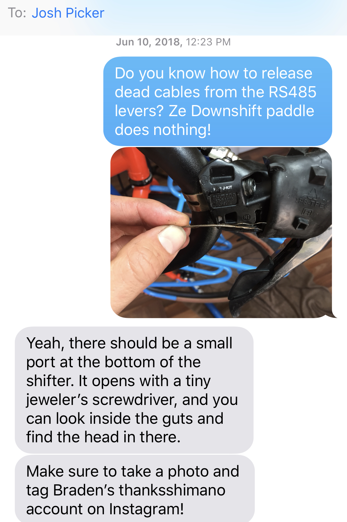

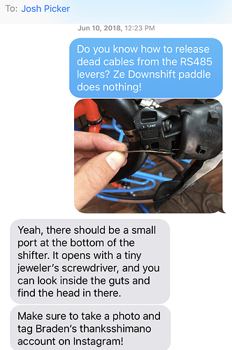

Not exactly the same lever but Josh once came to my house and fixed a similar issue I was having
Those are tricky, for sure. The best way is just to use a pick up pull it out. Make sure there is so tension on the cable, of course, and use your hand to push the cable as you’re picking at the head.
Thanks.
oof I’ve been there many a time
