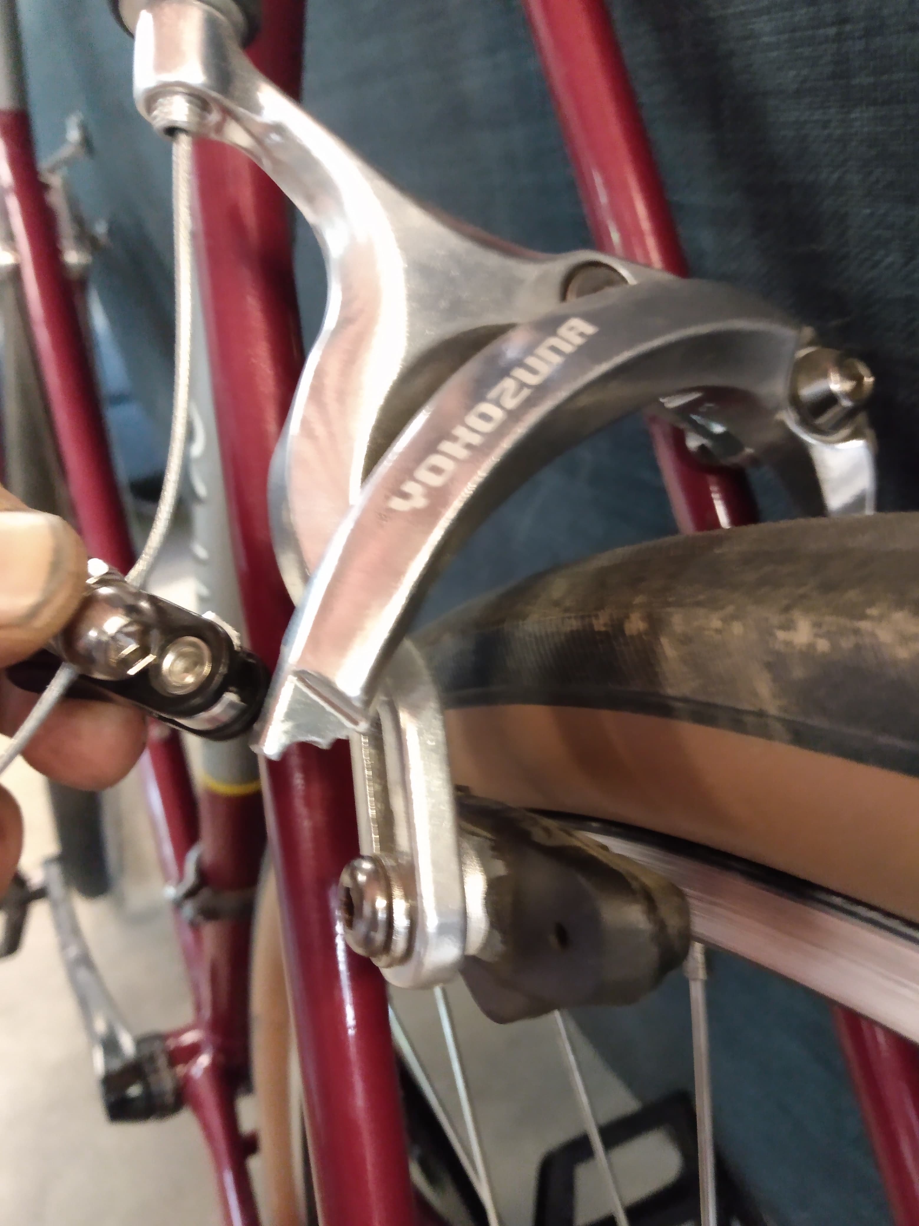

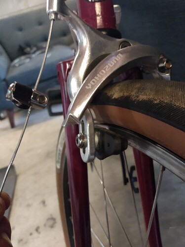

Yokozuna brake arm broke while tightening bolt :frowning:
“Break” caliper heh
this is a good time for it to break i guess
I’d ask you to cool it with the puns. But I’m guessing you can’t stop.

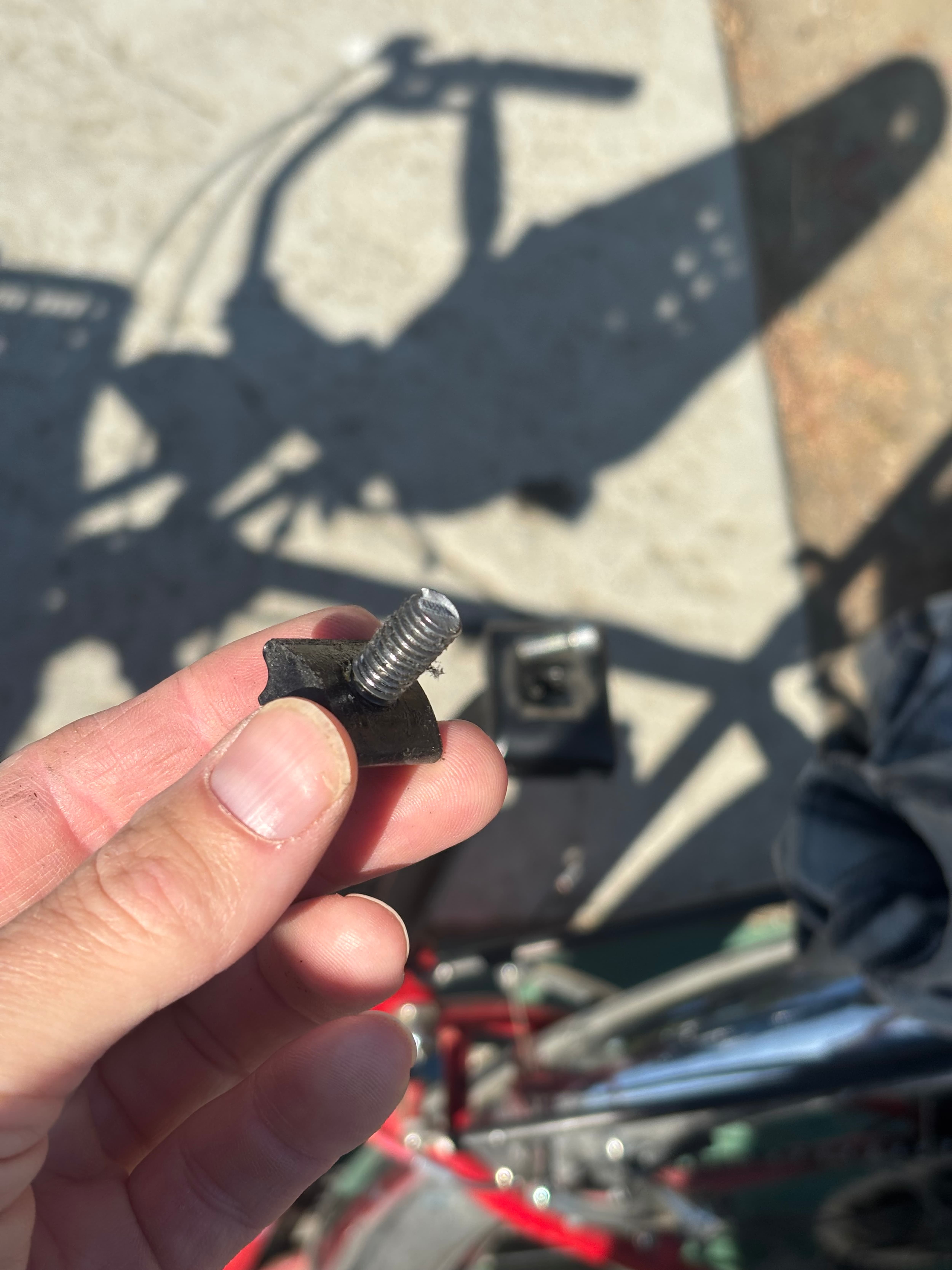

Big snap when I sat down after daycare drop off this morning and then seat and seat post parts yard sale’d all over the sidewalk:
I guess I would not recommend using an amazon special setback adapter with a cheap single bolt post (and I only weight 155!)
the vision in my head of what happened to you is really pleasing me
Taint hugs
glad it failed then and not while riding

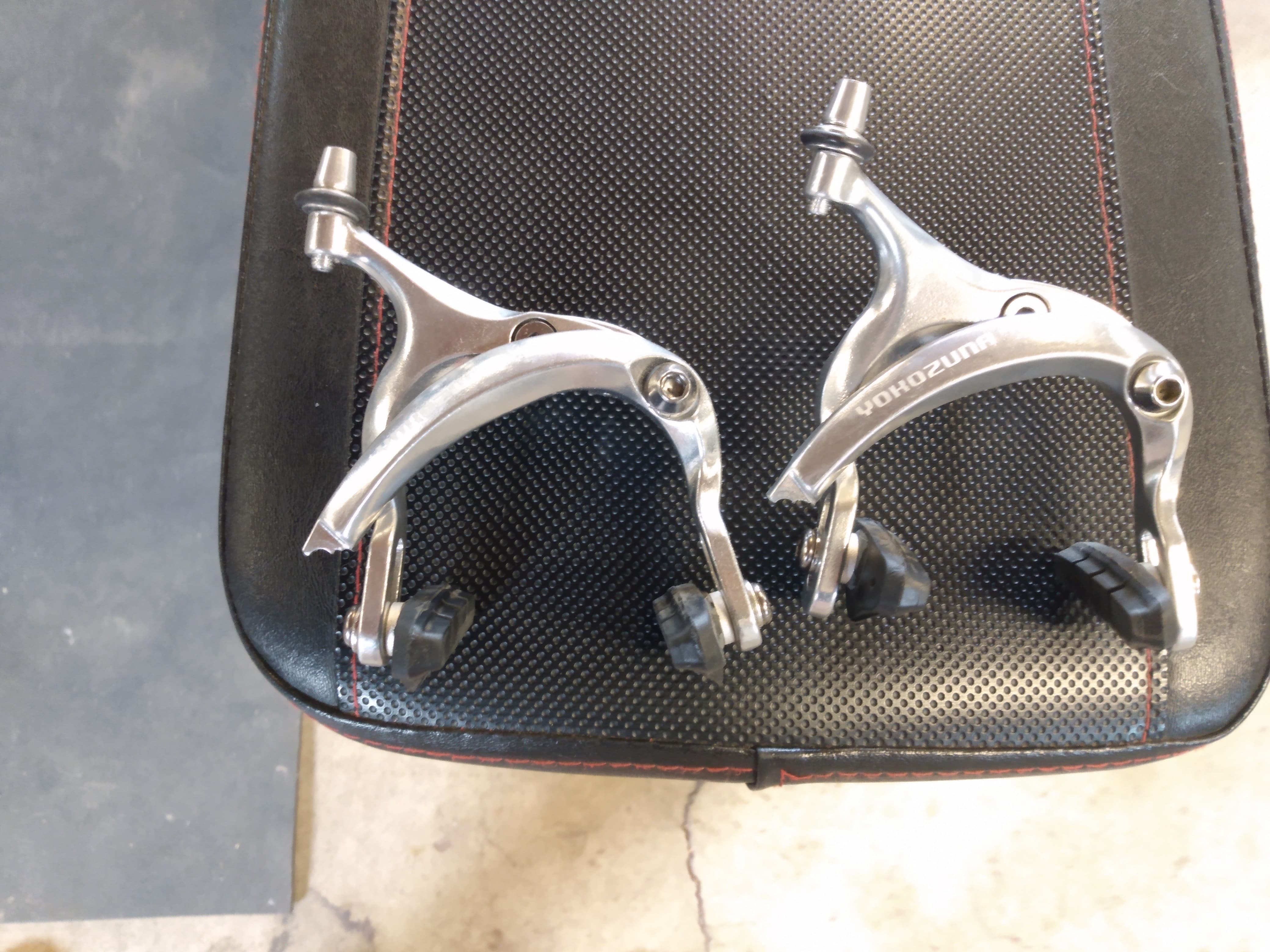

Today the other caliper broke
Now I have a matching pair of yokozuna calipers in the same failureway

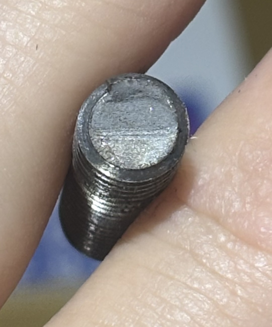

That’s a manufacturing defect
Send a photo to customer service (merry sales?) or the manufacturer
Failure analysis: a crack had propagated fully halfway through the cross section of the bolt. Wonder how long ago it formed???
Merry’s business model has consistently been to dress up cheaper knockoffs as pretend Japanese brands, and price it higher than the mass-market original.

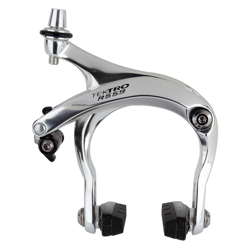

here the arms of these don’t look like the normal Tektro models?
Damn, I thought they were a real brand with their cable/housing kits. But they do brakes that are chinese rebrands (ultimos) makes it seem sus
Are they a house brand?
I bought them from the yokozuna website.
they are indeed different arms than tektros. the main difference is whether the quick release goes around the arm or the arm goes around the quick release. you can see the point of weakness that causes the arm to twist off.
