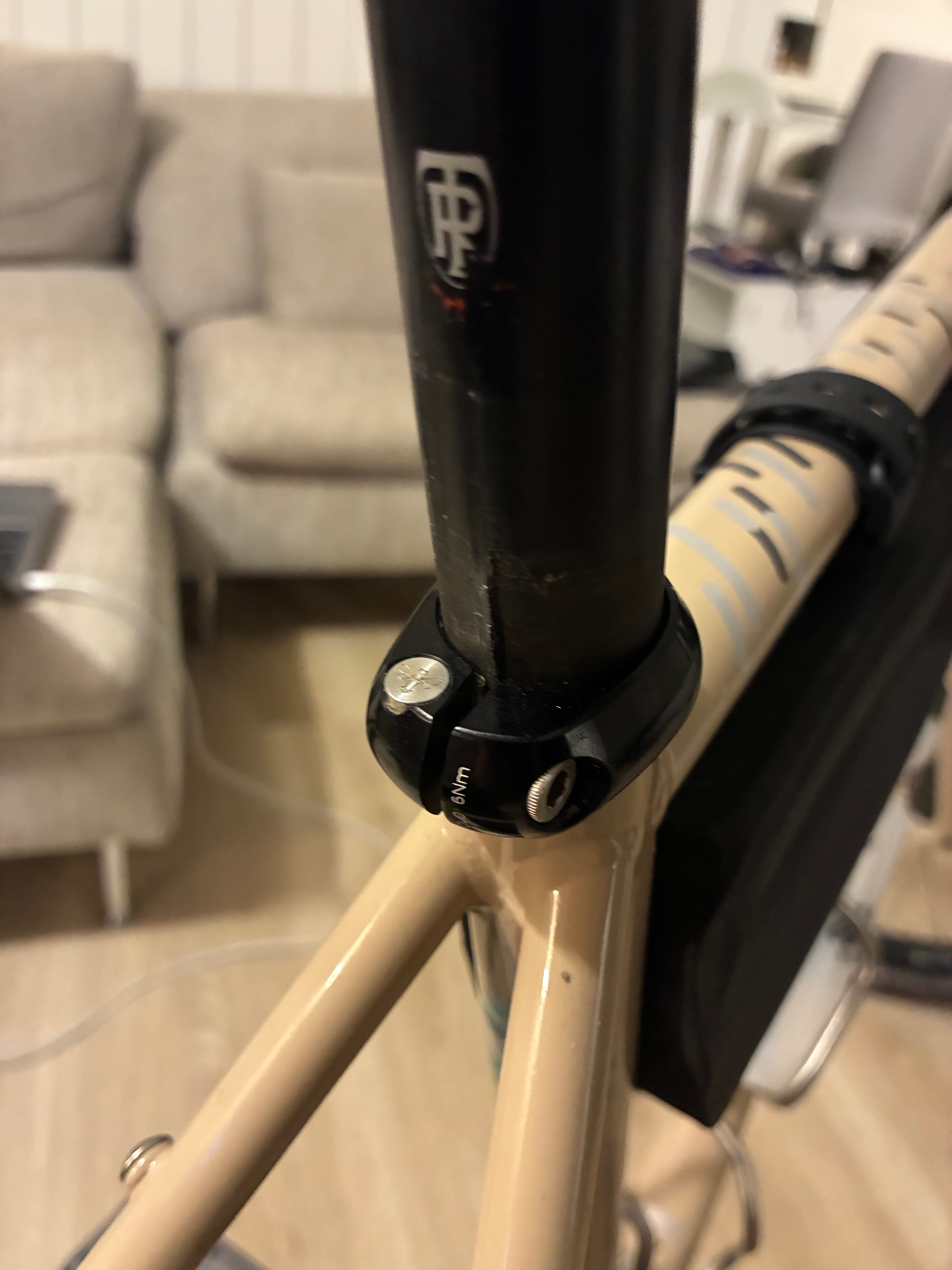

This happened awhile ago but I haven’t been able to think about it until recently. Patient is a Fairlight Secan 2.5. Seat post clamp spec from Fairlight is 29.8 or a 30.0, so I buy a King clamp (foreshadowing) which comes in 30.0. I always use a Ritchey torque key, and just turn down until it clicks like always, not thinking that hard about it. Later on when making other adjustments I see this:
Upon loosening and torquing it again, I realize that it takes way longer to get the torque click from the wrench. I double check this with my nice torque wrench and it does the same thing. On things like stem bolts, both wrenches perform as expected (fewer turns to click compared to the post clamp). So I make a beer can shim for the clamp, but both wrenches still sail past what should trip them at 5nm.
What do?
toss the king clamp off a bridge
acquire other 29.8 clamp

I can’t quite see what’s happening. Is the clamp pinching the seatpost?
I’m vouldn be in a similar scenario. I just got a Fairlight and it came with the Fairlight spec seatpost clamp. But I wanted to match the headset so I also bought a king clamp. Haven’t installed it yet and now I’m feeling like I just threw away $50.
The seatpost is compressing(read cracking) and therfore undersized, requiring the bolt to tighten further than it should to reach 5nm. That seatpost is toast. Try a measured 27.2 alloy post and see what happens.

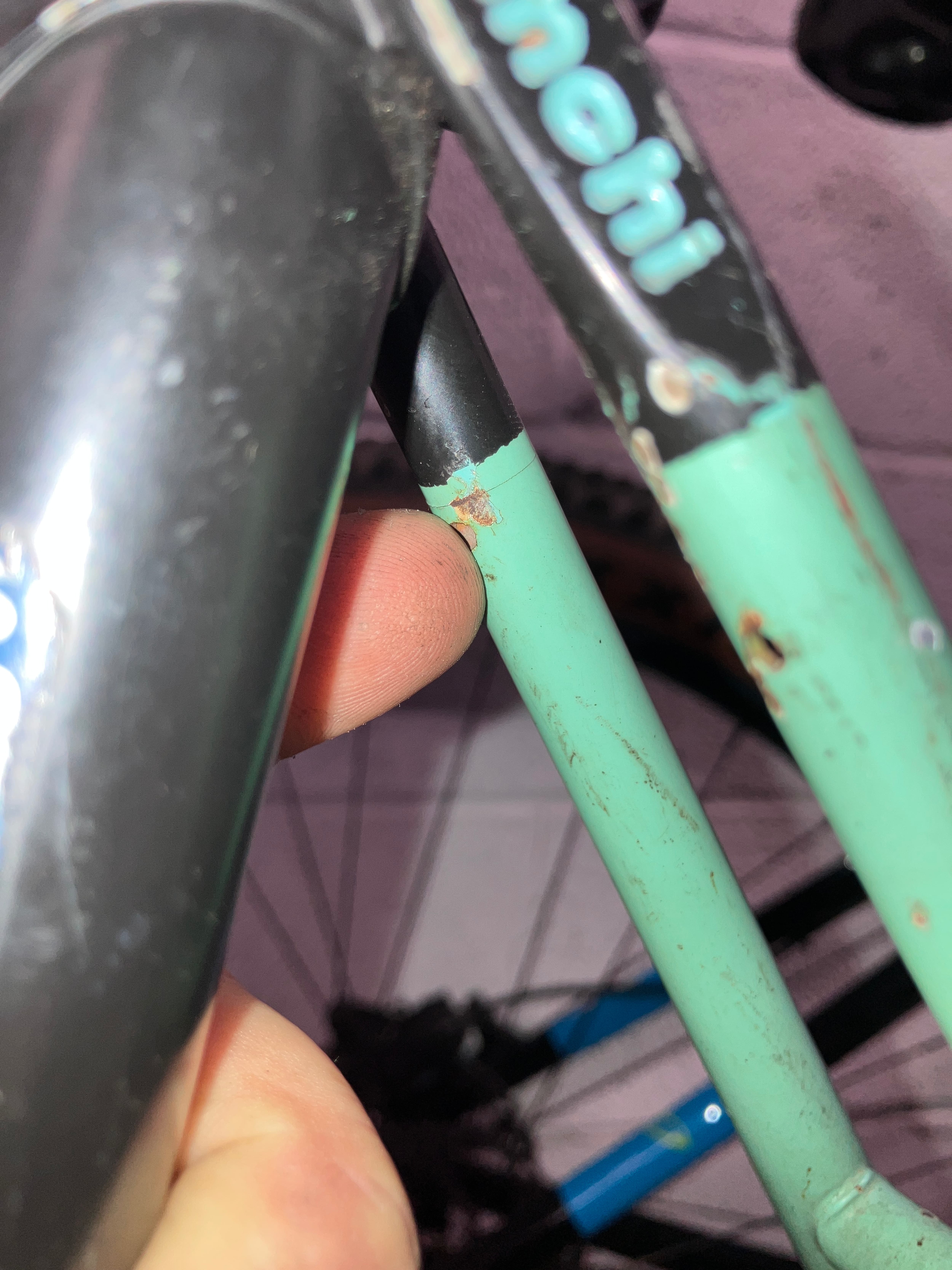

Pulled my track bike down for the first time in prolly 8 years and found
Still gonna ride it
Loose end cap plug?
That’s the theory. Can’t feel any movement when I flex the frame in different ways so not really worried
