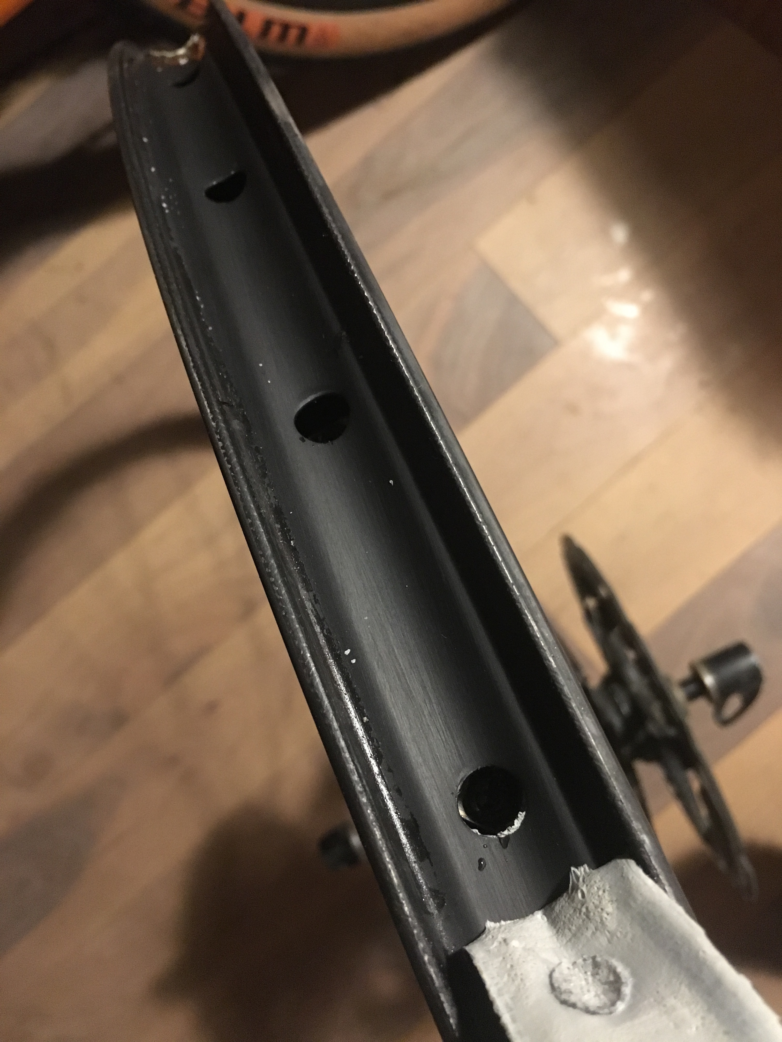

PS here’s the gorillatape coming off. I don’t know what some of you were doing to make this a mess (carbon vs aluminum rims?)
There is some variation in how messy it is. I’ve seem it leave way more residue.
On the bright side after it’s washed with dish soap and hot water Stan’s tape seems to stick to the gorilla tape adhesive residue just fine.

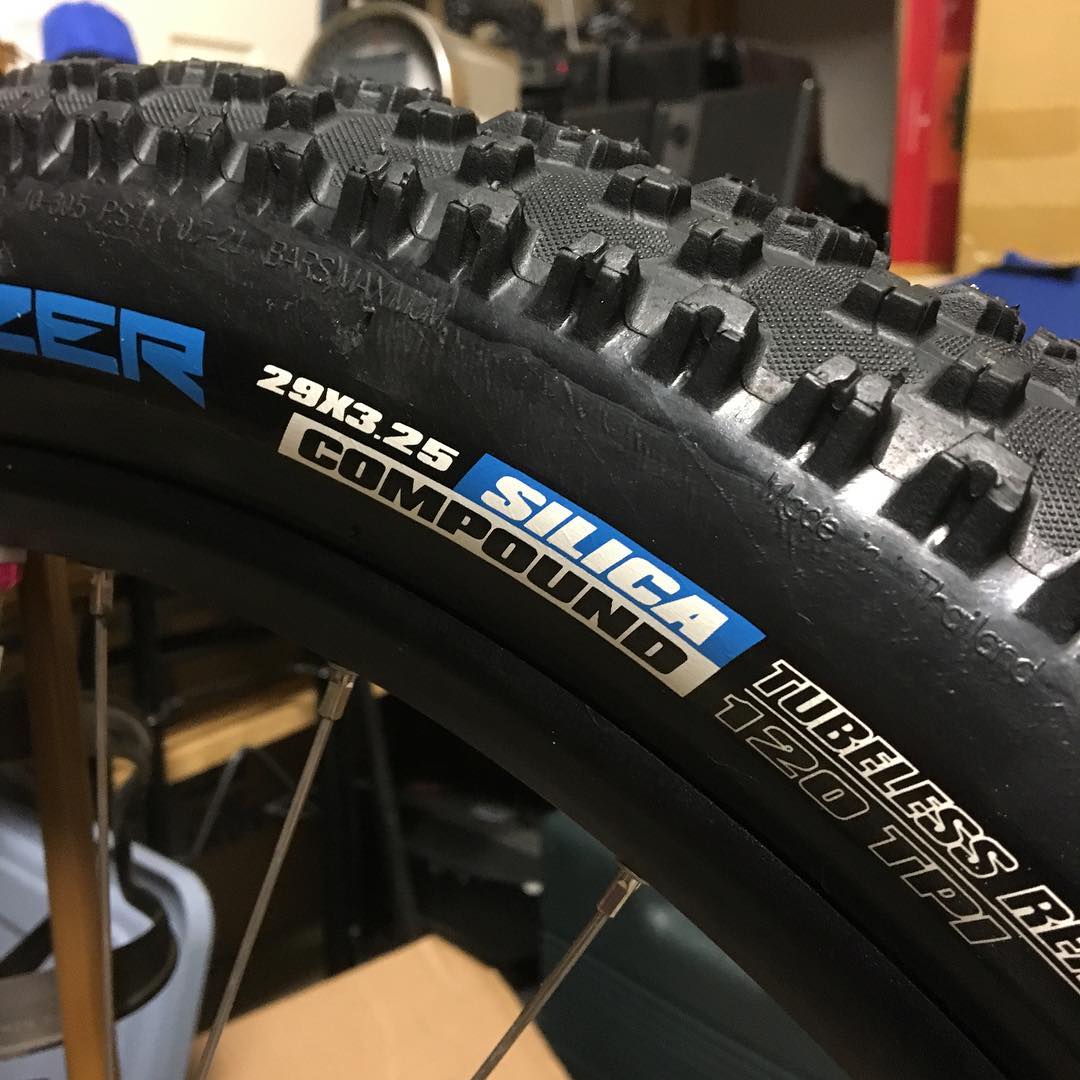

Giving the Vee Bulldozer another try.
I thought about it but didn’t feel like adding a step. Will see how it holds up.
