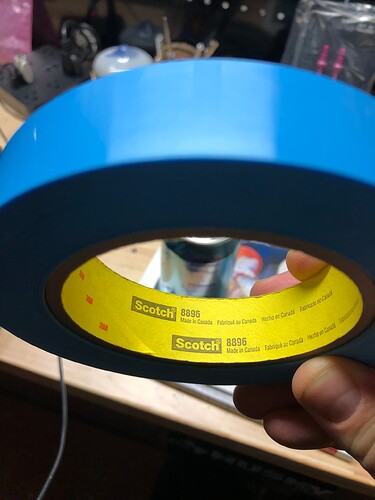

Tubeless tape is just poly strapping tape?
yeah most is tensilized polypropylene strapping tape. tesa 4289 or so is literally stan’s
Scotch 8896 if you want blue
Green powder coating masking tape works well too. Same plastic but the adhesive doesn’t leave a residue.
Anyone know where to find Tesa 4289 or 3M 8896 in 21mm width? I can find 19 (3/4") and 25 (1") on ebay, but had to resort to some genuine Stans for a couple i19 rims recently.
ive always gone a few mm wider than internal width. curved rim bed and all that
Yeah. 21-22mm works great for a 19mm rim. 25 seemed way too wide when I tried it - the tape was half way up the sides of the rim, which made it it hard to get the tape tightly adhered to the rim bed.
Supposedly it’s possible to cut into a wider roll to end up with a narrower strip of tape. I’m not sure my hand is steady enough to do it consistently, but I may give that a try.
i think squirrel set up a jig but basically mount a razor blade X mm up from your work surface and spin to win. let the table have the steady hands for you
