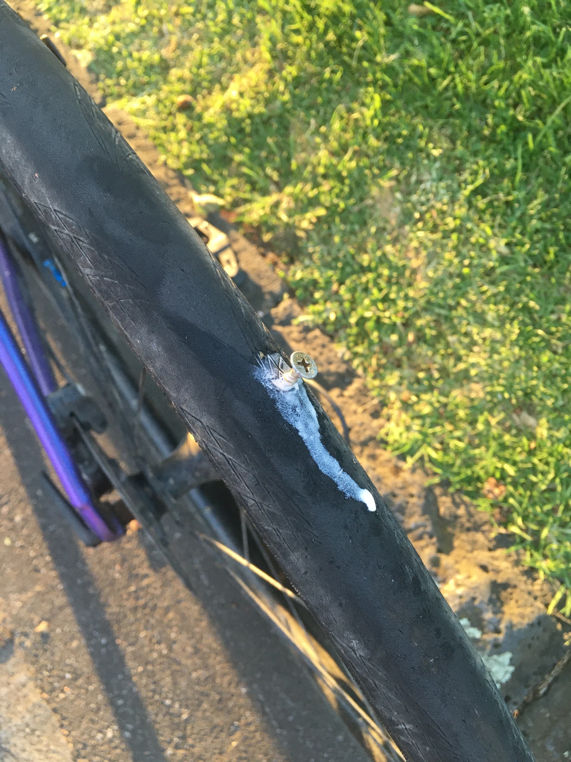

for anyone that’s still on the fence about road tubeless - this 32mm gp5k sealed up by itself without plugging once I removed the screw (it had been pushed all the way in). Maintained ~60psi and I didn’t even have to pump it up afterwards. Orange seal endurance btw
Last night I needed to take off my gp5k for trainer duty, throw shitty giant stock tire back on
Decided to fuck it, threw tube in. Pinched it, went flat very quickly. Pulled tube, said fuck it, pumped up my charger, fully set the bead in 1 blast, no prep. Added orange seal, pumped up with hand pump. Pretty sure it was quicker than fucking with the tube originally.
