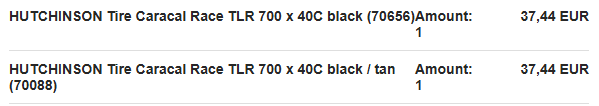

Hutchinson stopped distribution in the US about 5 years ago. The Override is my favorite tire, but I don’t really want to spend Euros on them.
Sounds like a challenge
Why not?
There’s still deals to be had, in the Old World

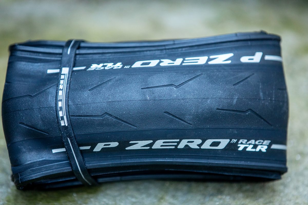

I was waiting for these for a while and then they showed up at BRR and look pretty slow
The 40 mm version of the Pirelli P Zero Race TLR has grown not only in size but also in tread thickness and tread puncture resistance. We see the tread thickness go up to 3.6 mm from 3.0 mm for the 28 mm version and 3.2 mm for the 32 mm, and we see the result of this in the rolling resistance tests where the 40 mm is the slowest rolling P Zero Race TLR.
There is probably a structural reason for the increased thickness, but we’re disappointed that the 40 mm version is becoming more of a fast touring bike tire than a big road bike tire.
GCN reviewed these and the vibe was that they were unnecessarily slow, as per the BRR thing. They didn’t come out and write them off totally cos I think they’re sponsored by Pirelli…
Ah that’s a bummer. Was hoping to hear they were making some fast floaty rubber. I wonder if this is a weird initial attempt to get into some e-bike market.
