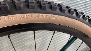

A third tire size has entered the chat
Clearly fake, and amusingly 642 is 700A.
How much of this is because the Pinkbike April Fool’s article has poisoned the LLM models?
