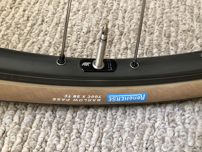

Are you sure the rims are taped up with actual tubeless tape?
Or are they some sort of strange Mavic UST fuckery that no one knows anything about…?
EDIT: just creeped your profile and found your Trance and the DT rims. No strange Mavic-fuckery around.
ok, then you’ve now met the tire that requires a compression chamber to seat properly
It isn’t those. It’s a set of Shimano wheels (mt66) and Maxxis tires. There’s definitely tape in there that covers the spoke holes and they came with tubeless valves installed already. I haven’t been able to get the bead to even sit against the rim. I guess because the tires are 1.9. they just want to sit in the middle of the rim bed.

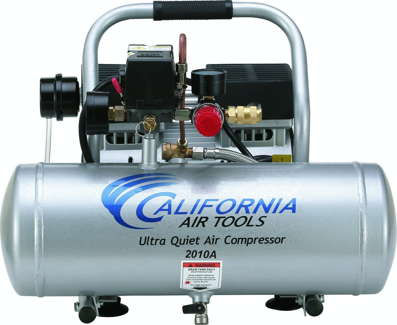

Putting a tube in for stubborn tires (read: panaracer) is the way to go. Also just go right to a compressor instead of a chamber bike pump. Not much more money.
Do I have one of these in a NYC apartment? Do I have Compass tires?!

Having an air compressor is not an issue. Presently, I have three.
