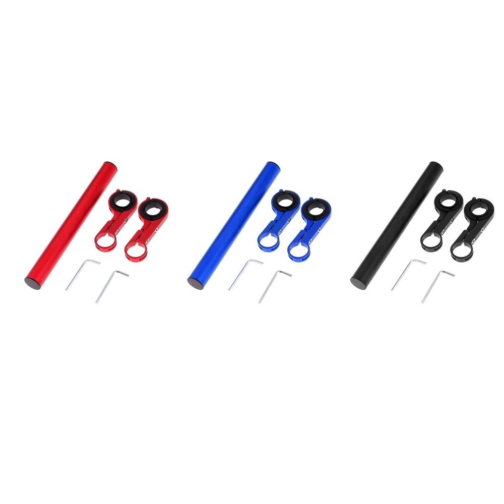

Them’s the tubes, and here is the style of mount I used for v2.0:
I had to finish it with a combination of gorilla tape and grip tape used in strategic locations (so as not to get peeled off by attaching and detaching the ortlieb hardware) to thicken the carbon rod a little. I also had to thicken it up slightly to clamp into the above mount. I used some inner tube wrapped in gorilla tape for that. If you make it neat, it looks good.
This is what I did, a variation of this. I wanted to keep the stem and bag separate since I have no idea where the bars/stem will end up (have already lowered stem 20mm). With some discounts, I’m into it less than $55.
Axiom Trekk 28.6mm seatpost collar (with the lip removed)
Salsa strut mount kit
Salsa strut
Ortlieb QL1 short rail, hook set, screw set
Aluminum stock from big box hardware store
