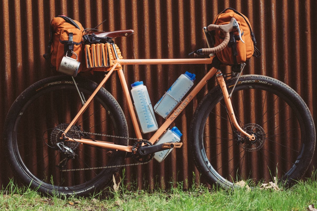

That's a nice rack thread you had there; shame if something were to happen to it again
New phone background acquired thanks
New profile pic
that photo is begging for a Keith Haring treatment
