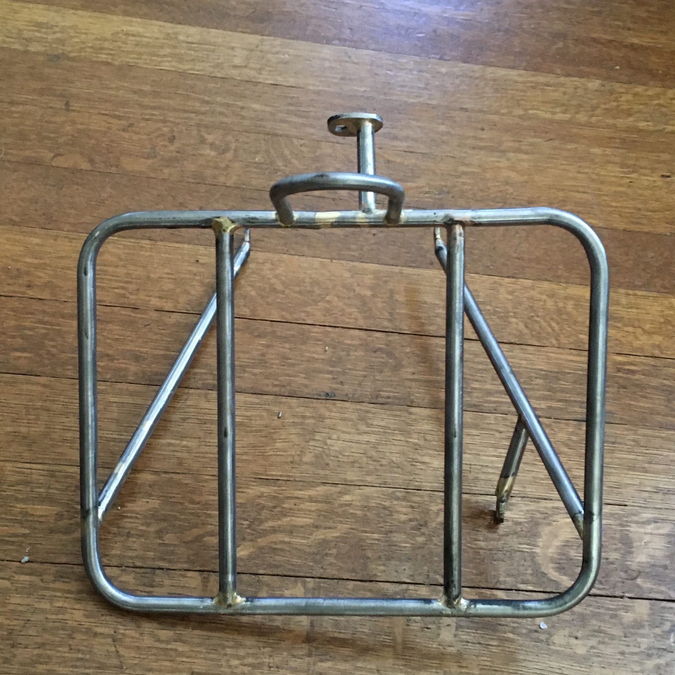

Oh, and my horrible rack workaround for probably-the-year:
The travel agent on the front wheel of my gravel®©™ bike runs into a centered fork crown stay (I had this happen on one of my other machines when I put mini-Vs under it; in that case I replaced the mini-Vs with regular Vs, but that’s not an option with this machine because the tires are huge and the brake tracks are stupidly narrow) so I put a plate at the crown and attached the stay offset to the NDS. Probably not a good plan for a rack that’s supposed to carry a lot of cargo, but for small rando loads (and shopping trips) it should be fine.

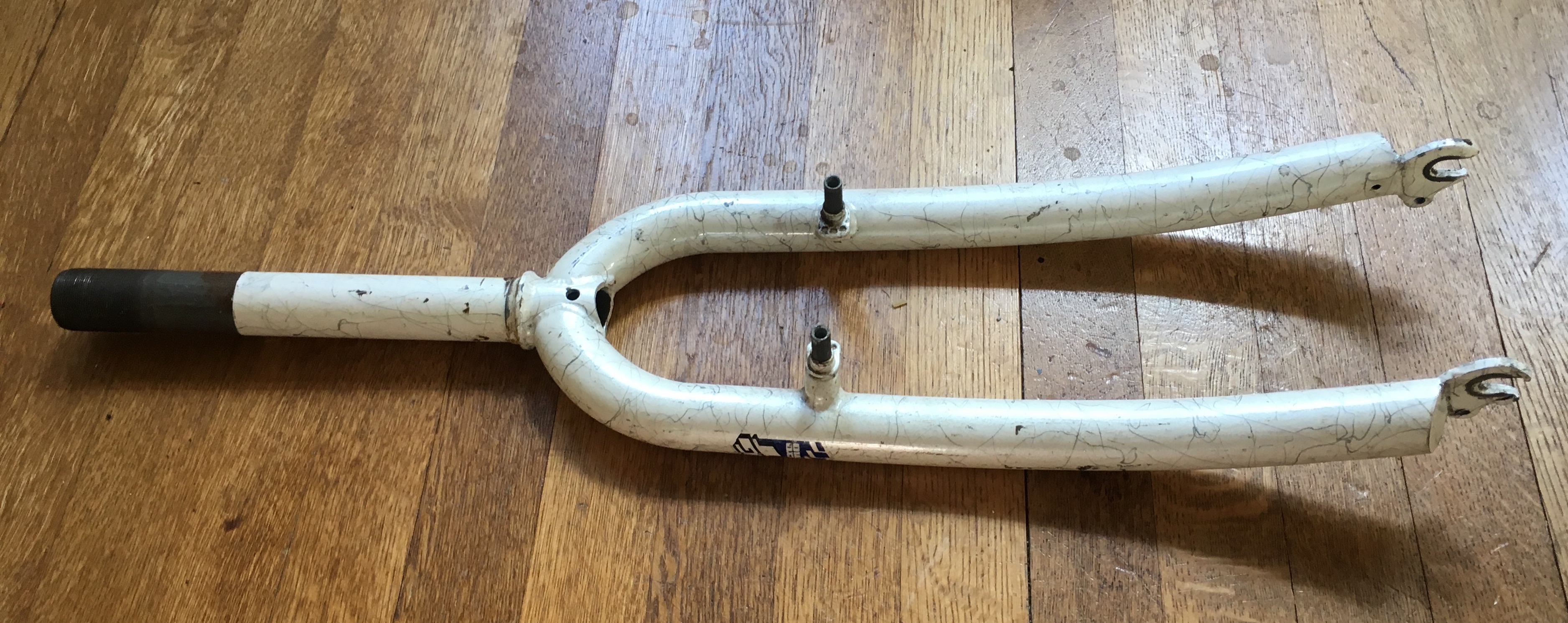

It looks like the fork I’ve got (with the exception of the paint scheme):
(1kg, 210 mm’s worth of steertube, 40 mm threaded – my Talera has a considerably longer HT, so it looks like you could take this fork, lop off the threaded part, and do it as a threadless fork like G-d Themself Intended.) Want it + the Nashbar rack + some brazeons + some puddles of brass?
heck yes
Gimme a few days to glue things up and fling it in a box for you.

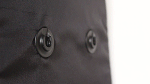

I wonder how it fares on bumpy terrain? The promo video shows the rider just lifting the bag off, so I get the nasty suspicion that a ill-placed root or rock would result in the bag lifting off, rotating forward, then plunging off the front of the rack to its demise.
It’s magnets so idk. :joy::rofl::man_shrugging:t3:
How do they work
I’m not sure about the one I posted but their retrofit magnetic bag does apparently require a twist to release, you can see it towards the end of this video:
It’s a valid concern though!
better not hit any bumps in the middle of a turn then
I mean, currently our best off-the-shelf solution is a couple Velcro straps so things can only get better
Velcro straps are pretty sweet tho
kidding
I have a buddy who uses the fidlock thing as a downtube water bottle. Works great. I’m sure this is fine
Yeah, I think the secret to the magnets is only giving them one direction that easily releases in sheer.

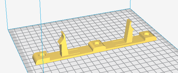

First design exploring something that could snap a rando bag into a rack. It’s designed for a rack with fore-aft rails made from 3/4 aluminum angle stock. For your traditional round tubing it would be a lot lower profile. I have a pile of other ideas but I wanted to explore things that have no moving parts first.

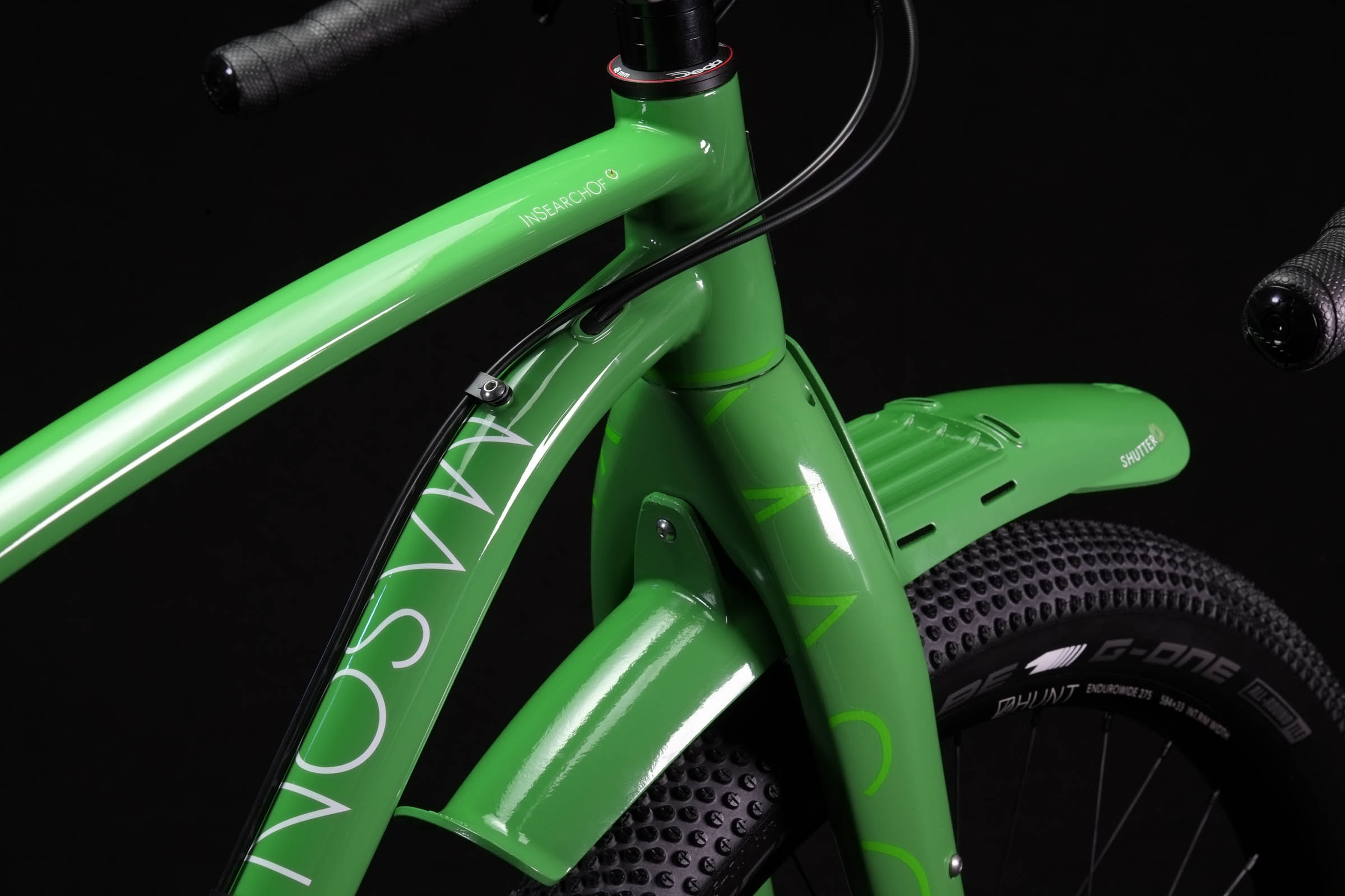

Interesting design that includes dynamo wiring hole:
http://www.bikepacking.com/news/mason-cycles-insearchof/
Looks dorky
