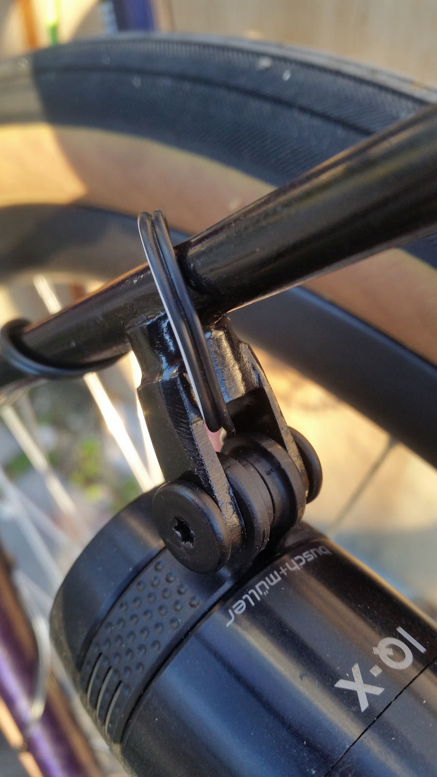

That looks really clean, I can’t figure out how its attached to the strut though, have any disassembled photos?

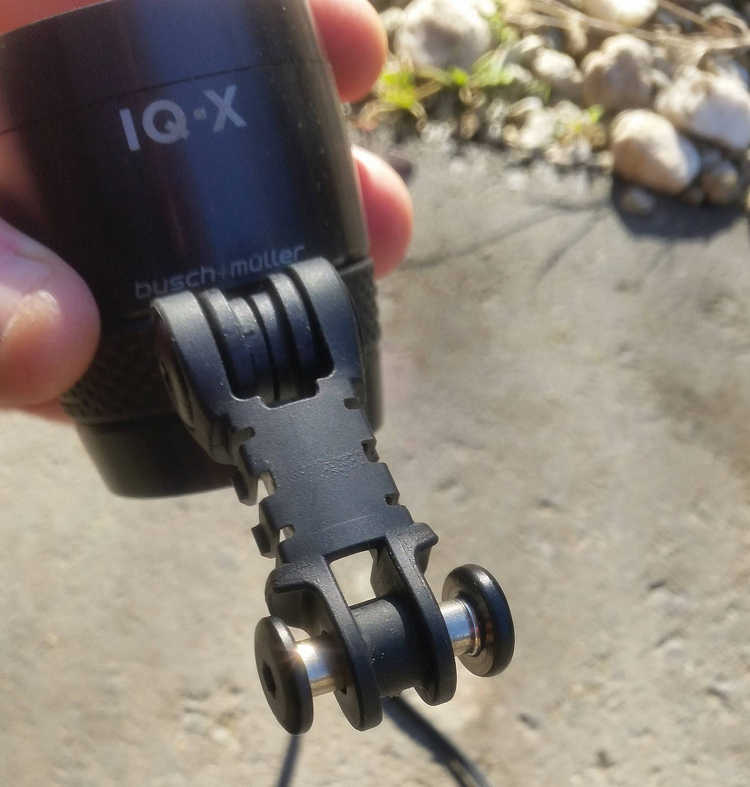

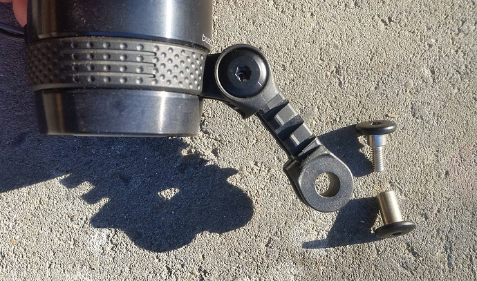

Yep, everything below the platform is custom, I didn’t use the included struts that are meant for axle mounting. For the light mount, I measured up the IQ-X bracket, so the holes are sized for the torx bolt shoulders and the spacing matches the light or the dogbone.
The mount is a larger OD tube brazed to the 3/8" strut, and plates brazed to the larger tube to get the mount spacing required.

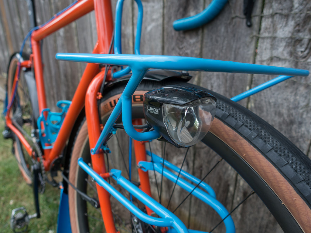

Oh nice, that is almost exactly what I wanted on my Orc rack.
Ended up with something slightly different that works well but I love what you did and kinda wish I had something like that on my rack.

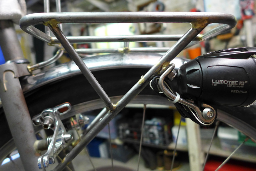

I guess the one advantage of the orc design is having the light as high as possible so slightly less wheel shadow.
On your design the plates could be extended further to move the light up a little higher.
I really like what Dan Boxer did with this design but Its nice to have the adjustability of the sandwich design.
But if I put the dogbone back in between the mount and the light, I can extend the light out and up/down as desired.
Fork placement was best guess from mockups and measuring to allow for one or the other to work acceptably without putting the light way in front of the front rail or way too low.
That cyo premium setup is boss! I only got away with this because the collar can spin on the IQ-X and be setup hangy. Not compatible with non IQ-X lights without some kludging.
