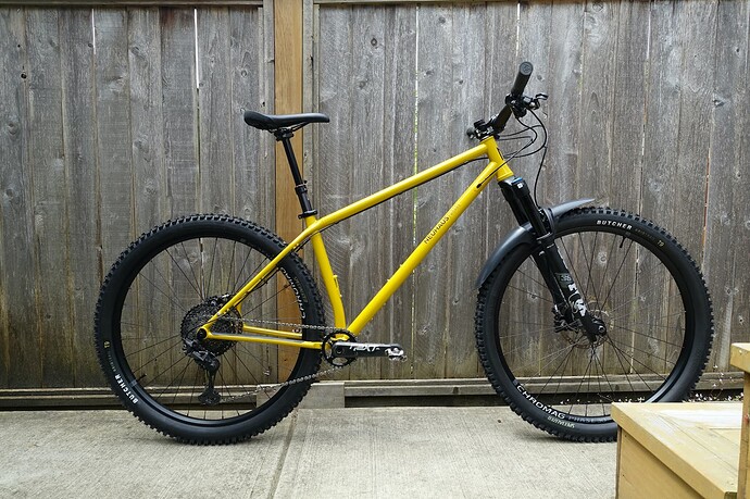

Here’s my singletrack setup for you to do your worst.
Build is:
Frame: Neuhaus Solstice, Large (65 head angle; 430mm CS; 56mm BBD)
Fork: Fox 36 Performance Elite, reduced to 130mm
Wheels: DT350 boost on Chromag Phase30 rims
Cockpit: Chromag HiFi 50mm; OneUp riserbars (20mm) at 770mm
Dropper: Currently a OneUP two ten.
Saddle: WTB Volt
Brakes: Magura Trail Sport, 180mm centre lock rotors and Performance pads.
Tires: Specialized Butcher T9 29 x 2.6
Drivetrain: Next SL cranks w/28t OneUp switch ring, XTR cassette (10-45), chain and shifter (12sp).
Pedals: XT
Cages: Specialized
Headset: Wolf Tooth premium
Bottom bracket: Wheels Mfgr T47 angular
This is a stock Solstice with an added triple boss on the underside of downtube and rear rack mounts added. Premise is a trail bike that can handle my local north shore trails and the odd overnighter using a rear rack etc.
Regrets: If I had it to do again, I’d slacken the seat angle a degree (75.7 to 74.7). If any Tarck judges are keen for a trail tour in Vancouver, hit me up.

Couldn’t find a dropper that fit ?
Good catch. Here it is with the proper dropper:

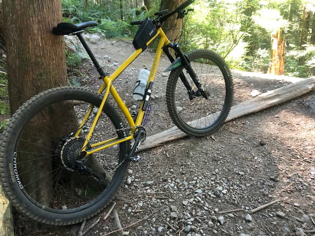

Big/big crosschained though ![]()
