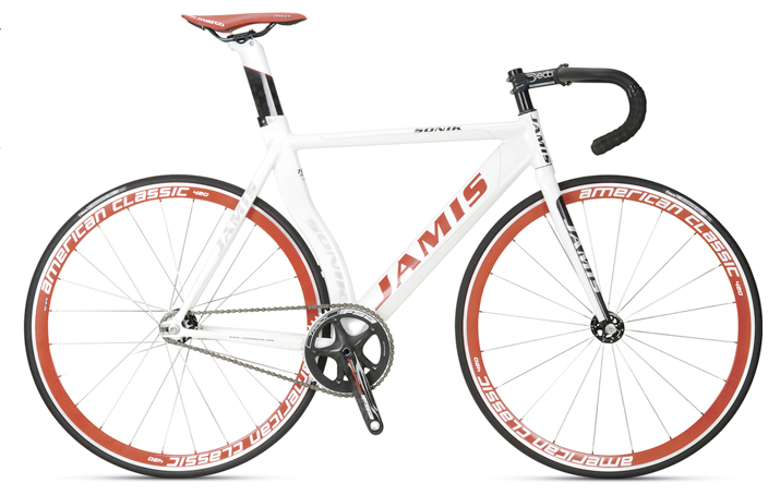

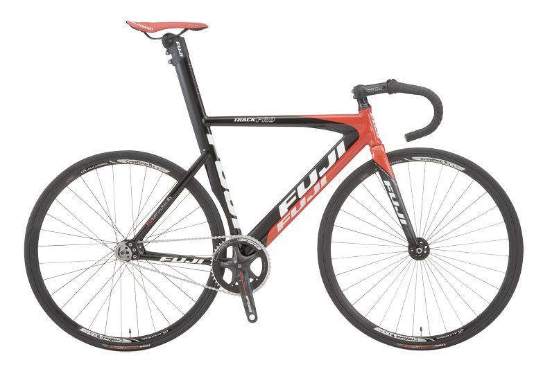

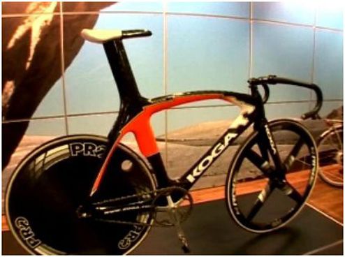

I’m not really talking about compact geometry…at least I don’t think I am. I just don’t know what the hell is going on with my bike or “real” track bikes.
I don’t know much about track racing, but does this have anything to do with it?
Low headtubes for aerobars? Why would they have such stupidly long top tubes then? Don’t you need shorter stems typically with aerobars?
Someone who actually races on a track, help me out.
