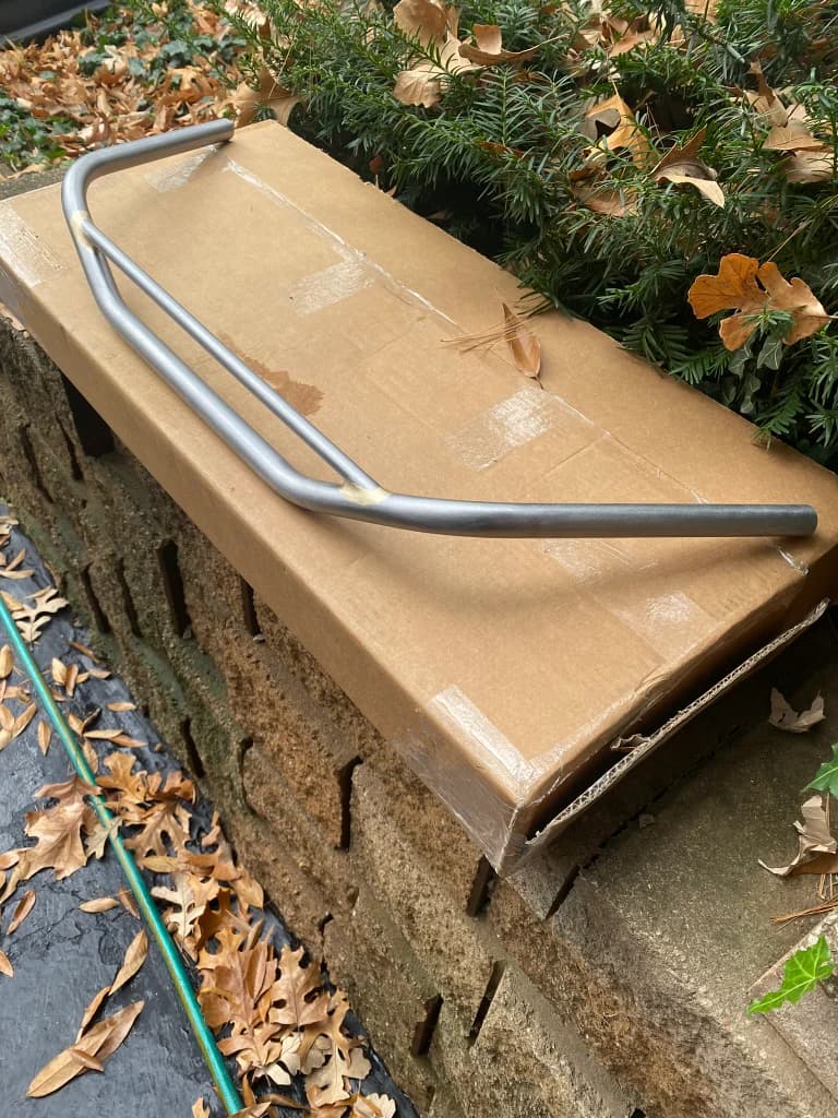

I might be into the bars if he isn’t
@BicyclePears what are the details on these prototype bars? Cromo and 25.4 I’m guessing?
65 degree backsweep, 67mm rise, 780mm width, 22.2 clamp, less than 1000g if i recall correctly.
Man as jealous as my Bicycle Pubes mega-fan co worker would be, those aren’t quite what I’m looking for. Thanks doe.
