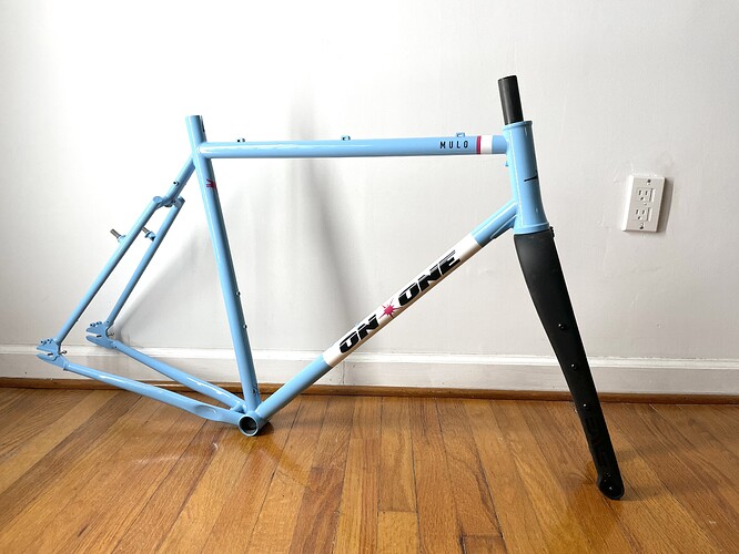

The Mulo arrived. In awe of the gentlemanliness of this lad. Has a chain holder and a pump peg.
If I keep it, I eventually want to shave off the cable guides and canti posts, which would fortuitously necessitate a respray.
whoah that’s pretty cool. did you get the fork with it?
giving me ideas for this never-been-built motobecane fantom cross uno frame I got lyin around the basement
This is one of the rare times where the dither stars aligned. I had that fork on my previous (sold) endpoint, held on to it imagining I’d probably sell it too, then found an absurd stand in frame.
