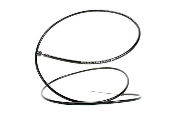

The cable on the Equals is probably a bit heavy given that its the compressionless stuff. They come with compressionless and standard and say that some people chose standard because it can offer more feel, and its more amenable to bending for drop bar curves. The compressionless is fatter and I had a bit of a job routing it internally, not having the appropriate tools.
this is aluminum compressionless housing
it is extralight, slender in profile, and is easily moldable into curves
I guess they aint gonna do a roadie one. Could you swap out inner with something workable?
yes you just cut one of the factory inner cable ends for non-BMX use, and the U-brake straddle ballend fits great in a road lever
the factory housing ferrules are molded in and amazing
it comes with spare loose ferrules too for cuts, the seat inside is “volcano” shaped inside to spread the linear strands into a socket
