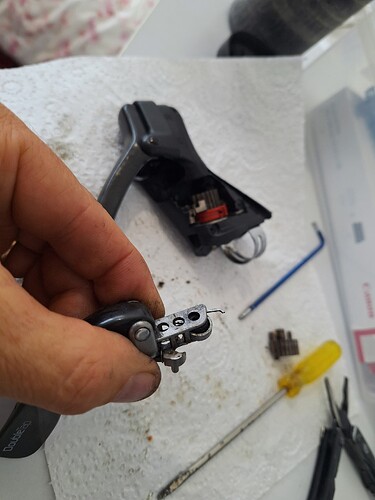

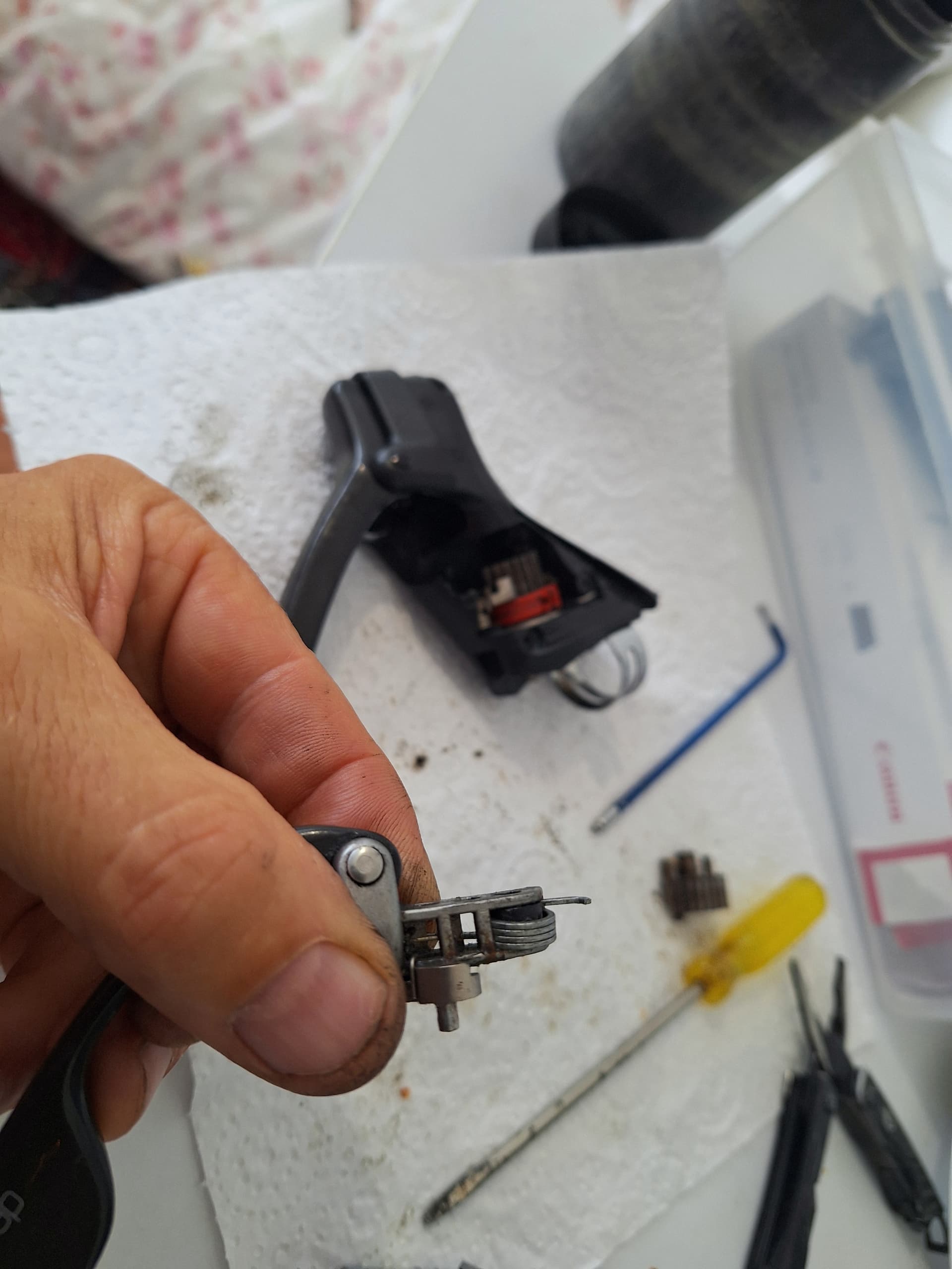

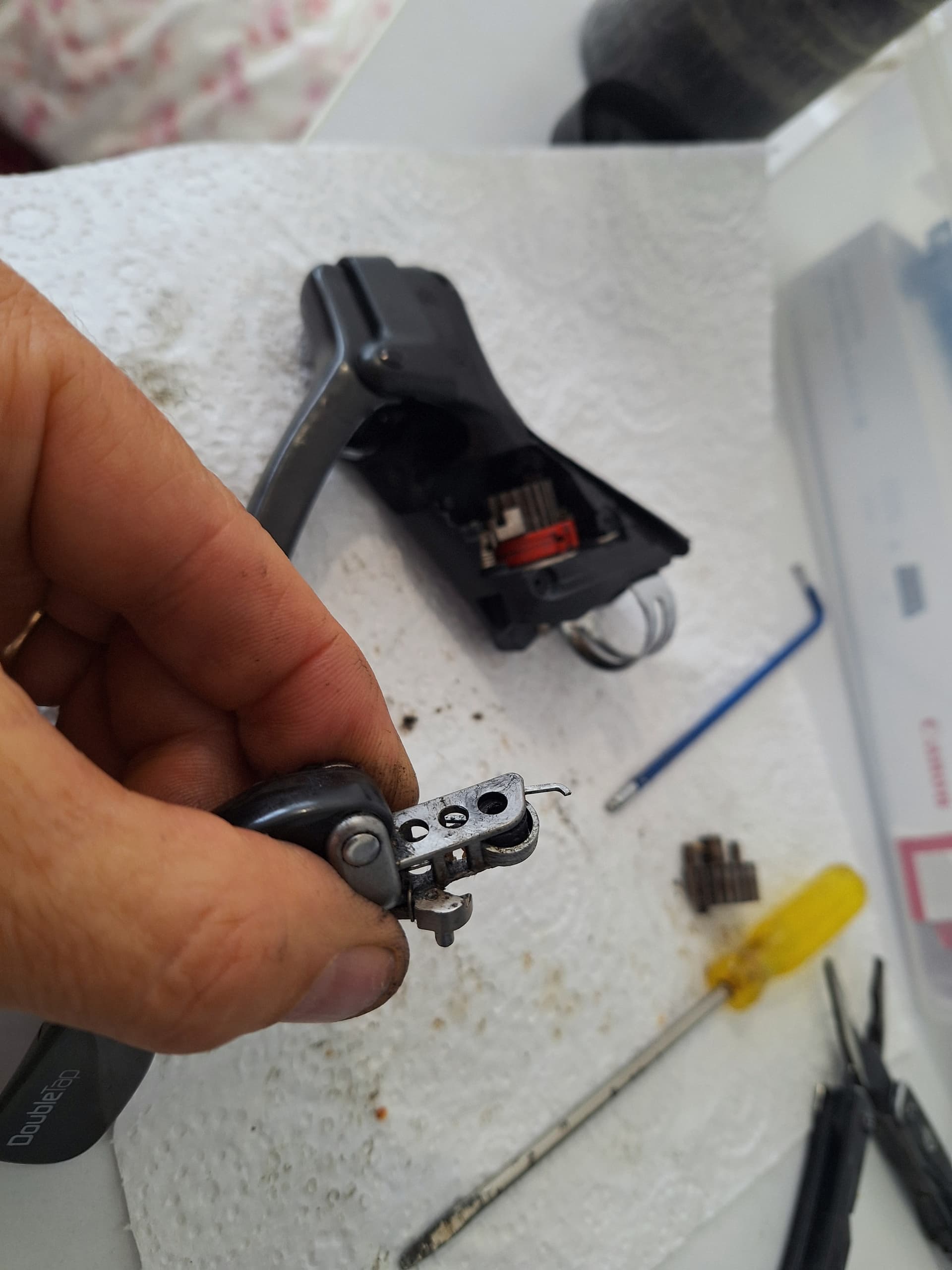

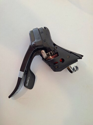

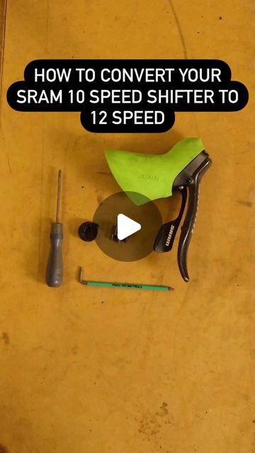

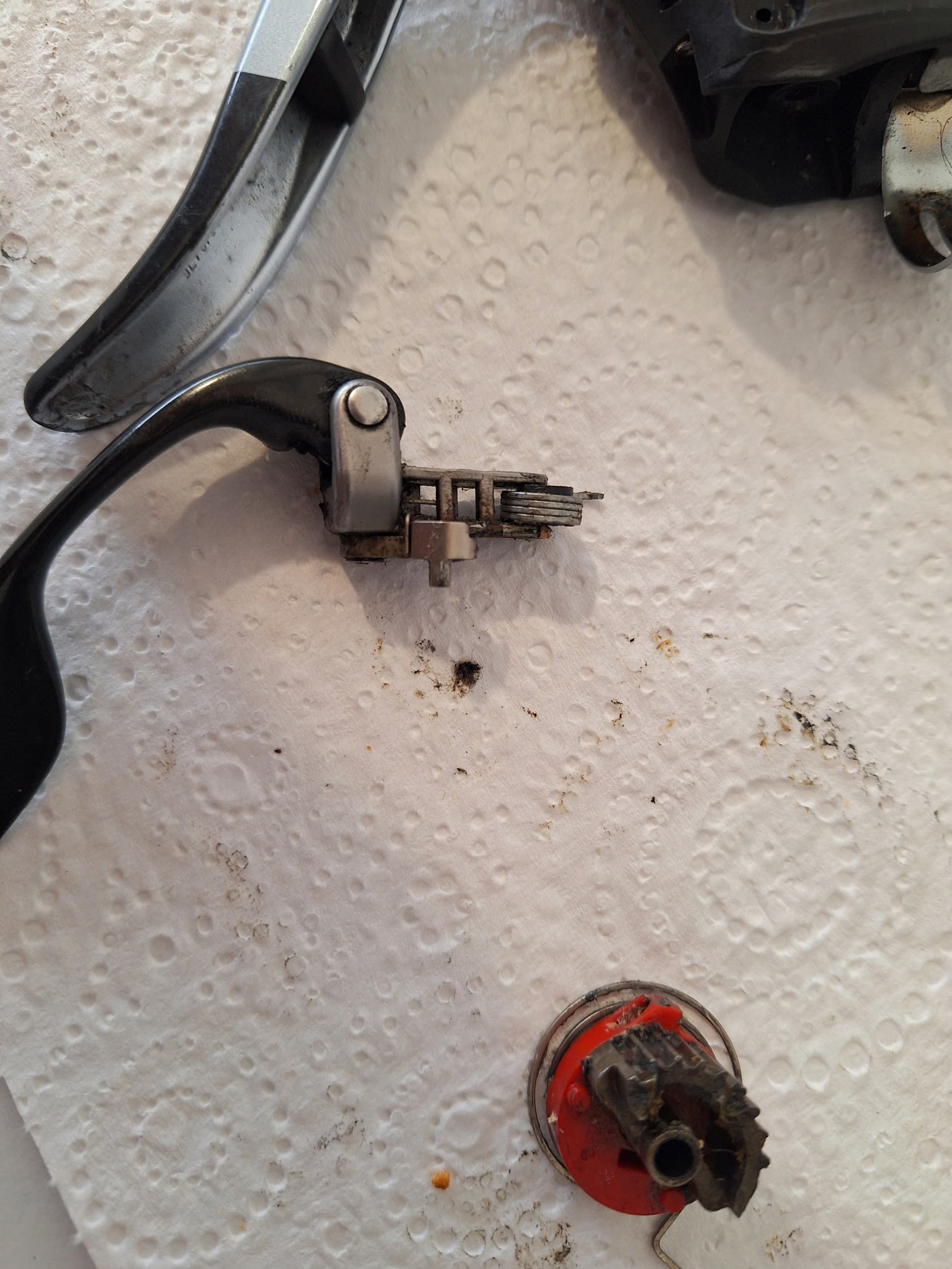

For anyone into up-speeding the ratchets on their sram road/force levers, Ive done three different kinds now. The oldest are the hardest as the paddle is actually 3 loose parts. A plastic bush, a simple spring, and the rest of the mechanism/frame, which sticks together. After swapping out the ratchet to the “up-speeded” one, replacing the aforementioned giblets requires a lot of manual dexterity as you are trying skewer the whole assemblege with this pin that runs through everything, at the same time as you are forcing these parts onto place, against the force of the spring, while trying to keep the holes in the bush and the paddle frame aligned. Tricky as. Doable tho.
Up-speeded with like Ratio Technology parts, or swapping in SRAM parts from other shifters? I’ve got olde 10sp Rival (both silver and carbon levers) and might like to try this.
In this case it was just sram parts. 11 speed ratchet into 10 speed early gen. Ive also done the next gen. Not used the ratio 12 speed yet because I am happy with 11 and didnt want to change all my wheels. I use their big cage tho. They say that if your plastic shift drum is red, its compatible with the 12 speed. Send me a shot of the profile and I can tell u if its the tricky one.
This toot by Ratio is pretty good. Noted the drum in this one is white, and they replaced it with there own plastic black one. As I said, apparently the red ones should work up to 12 speed. Ratio are making alloy drums now too.
