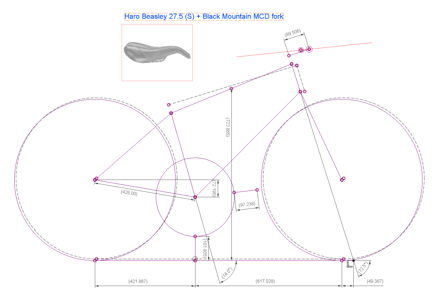

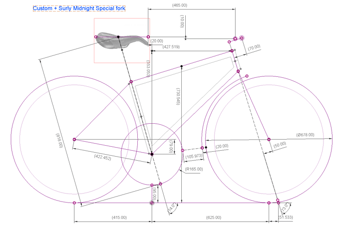

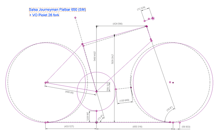

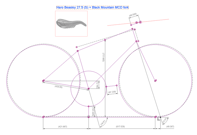

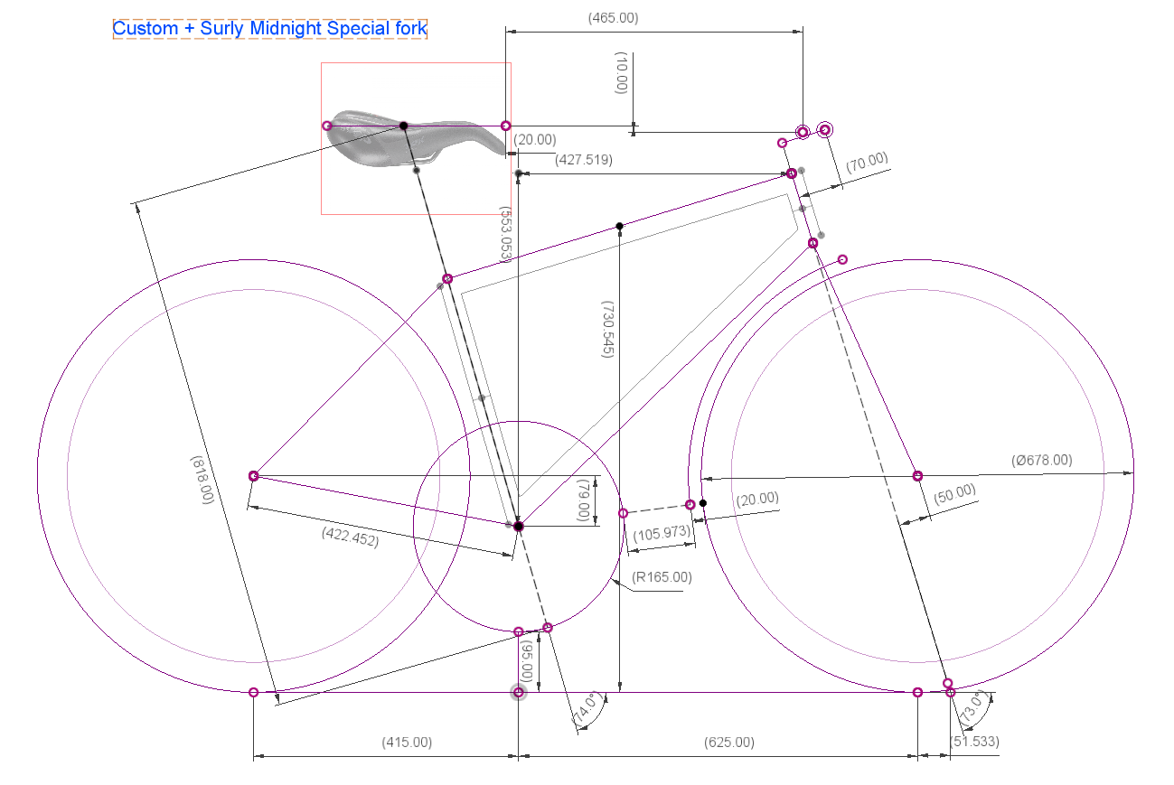

Trying to set up a swept bar thing for someone who is short of inseam /proportionately longer torso, that would do well for grocery/babby hauling and not be a toe-overlapping floppy circus
Here’s what I came up with:

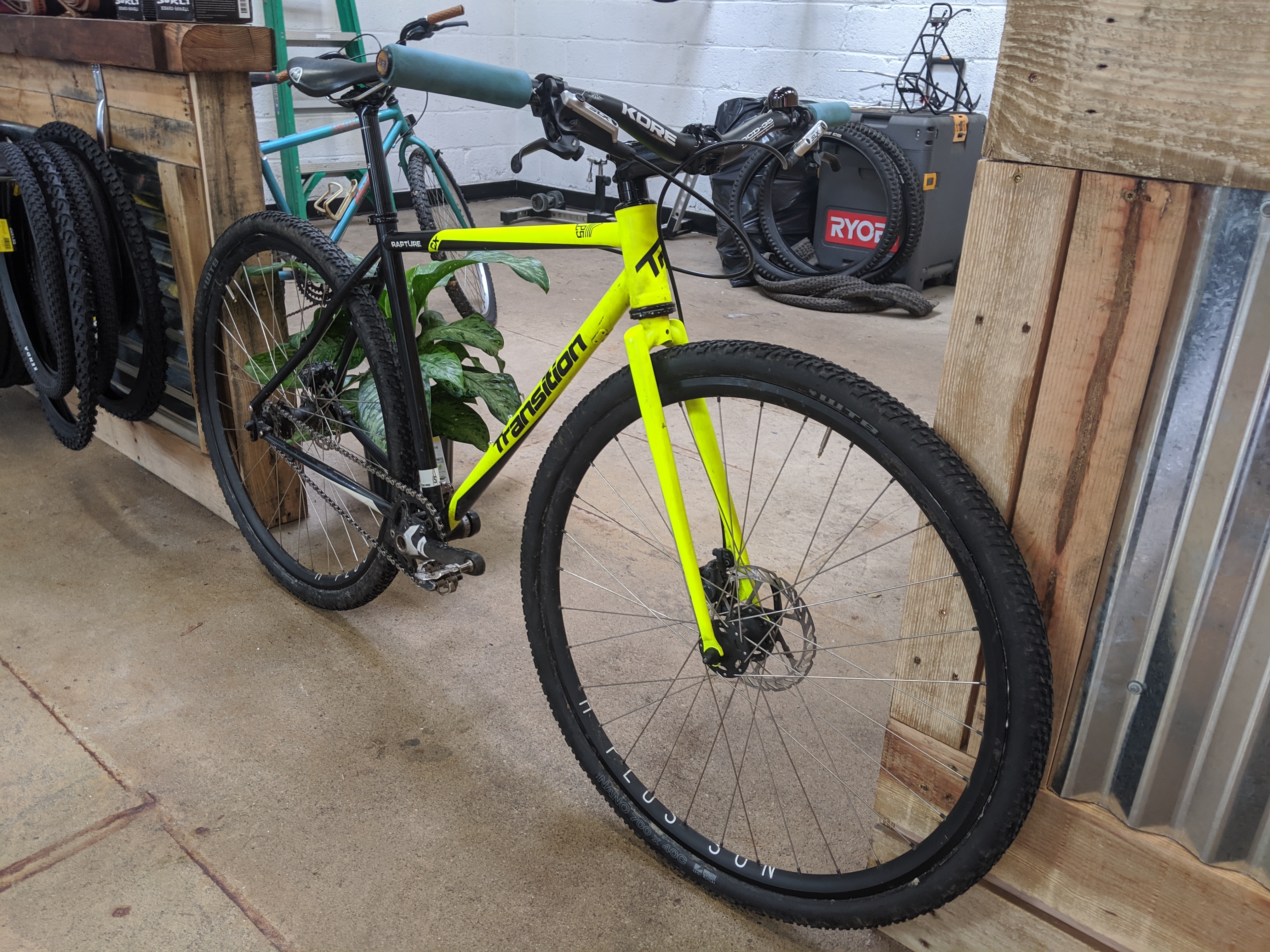

since writing that last post I put flat bars and slx brakes on my cross bike. it’s a start.
Edit:
It’s pretty fun but damn a 49cm cross bike has some serious toe overlap

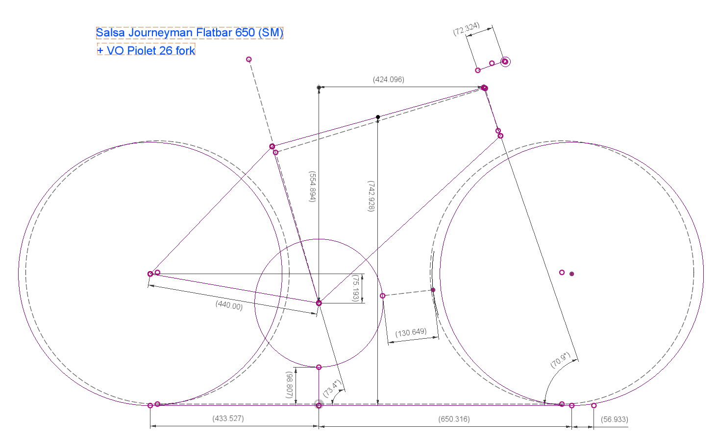

DQ do most low trail bikes run 650b tires for a reason(s), or because that’s just always how they were done? Seems like the Radlawn Nordavinden is the only 700c low trail bike I recall.
Asking for me. Having thoughts of an uprightish low trail commutery bike to run 700x38-ish tires.
Bike geometry is like this for me.
Honestly I think it’s because the set of {people who like 650b} and {people who like low trail} has a very large overlap.
There’s a bit of connection with replacing geometric trail with pneumatic trail, so you’d be looking for fatter tires, and 650b was the traditional way to do that.
The latter.
The contact patch would probably be slightly different due to the different tire diameter, I’m guessing the taller tire would have a longer narrow contact area, but would a 700x38 tire have a similar pneumatic trail as a 650x38 tire? Or at least similar enough that it probably wouldn’t make a big difference?
There’s also the issue of toe overlap, especially since a lot of those bikes had fenders, too. Smaller wheel reduces overlap. That’s also why you see a lot of 26" wheels for smaller frame sizes. 650a is also a thing,but more for the Japanese market for some reason.
Fat tires produce more “camber torque” than skinnies, which is somewhat offset by lowering the trail.
I don’t think the wheel size has that much an impact though, It’s just that 650b will fit in traditional road-ish frames where a fat 700c wouldn’t (or it forces a longer CS length, toe overlap, etc.)
Based on the replies from people who know more than I do, lower trail is a good response to the change in bike handling caused by larger tires with the particular geometry used in old fashioned roadish bikes.
