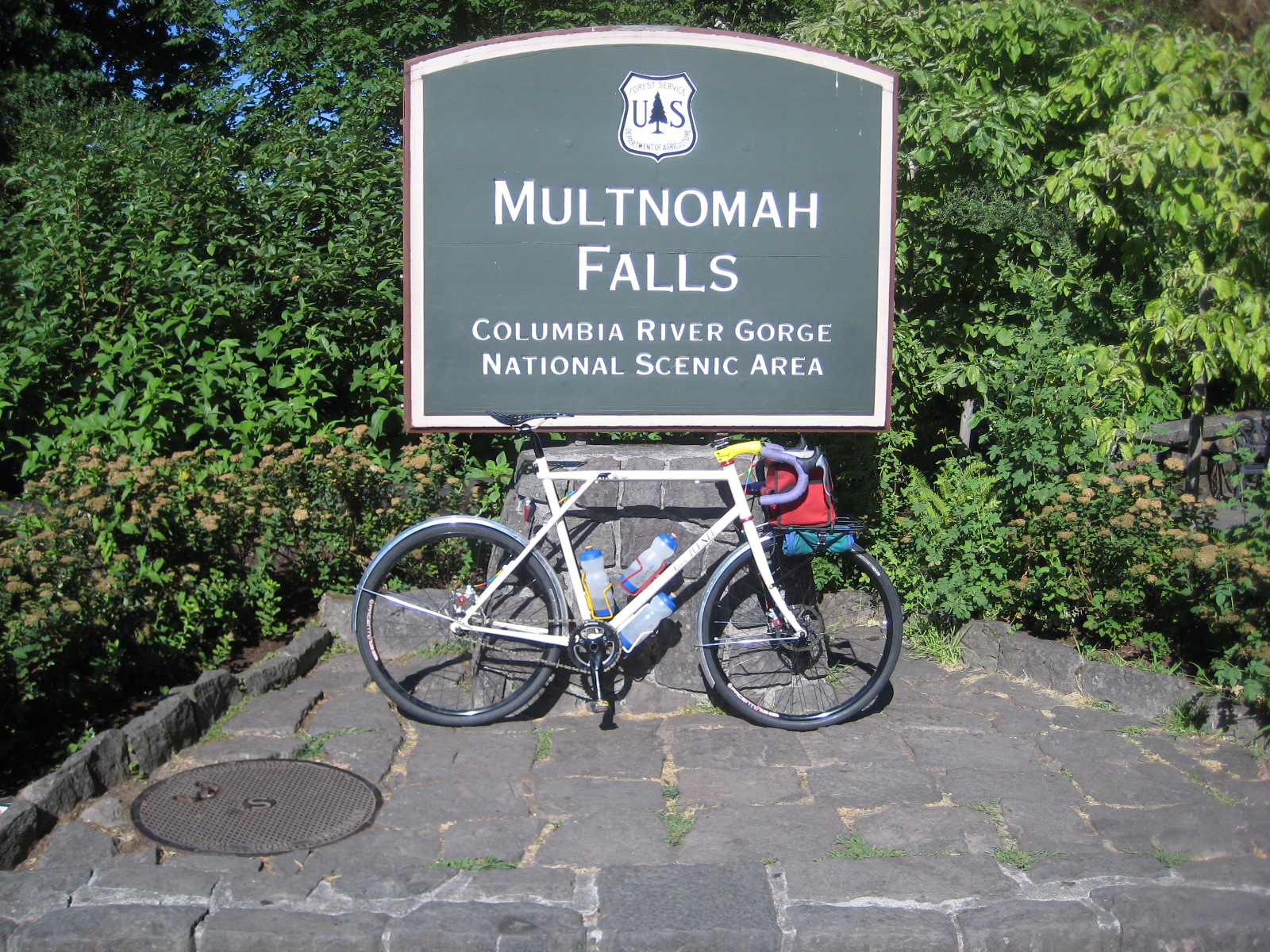

26" monstercross is real and it’s incredible

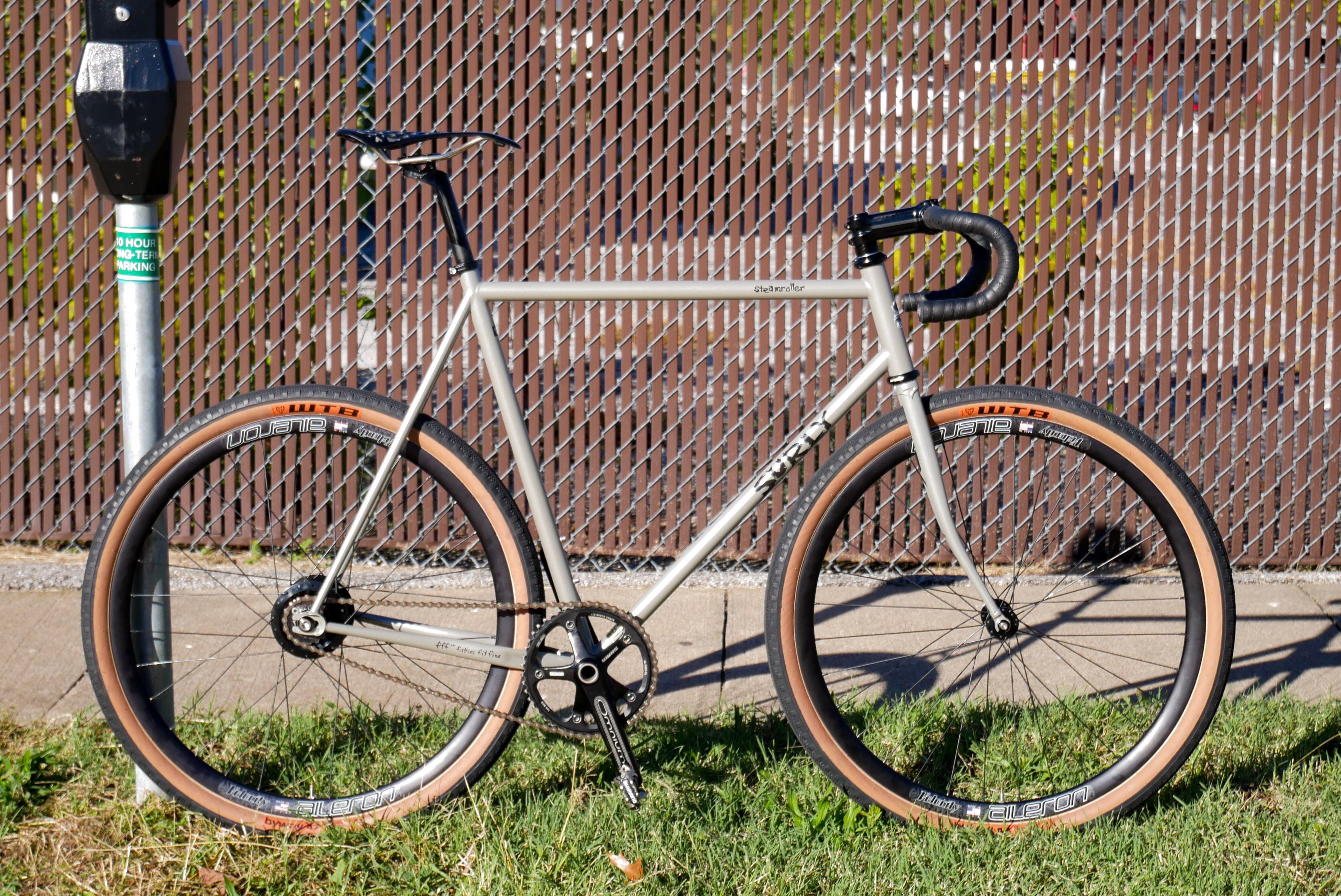

So I’ve got a lead on a Steamroller frameset for pretty cheap. Then I saw this picture and it gave me certain… feelings.
Where’s the hive mind on a 650b fixie with big old tires? Should I accept that I don’t need 48mm tires on all my bikes? Or should I go forth and shred another stupid bike?

I’ve dithered with fat tire fixies for years, and as much as i like my 26x2’s and gears, for fixed, I don’t think bigger than 38-42 is really all that fun. Something to smooth out the ride, but not so much it gets bouncy. Unless you actually ride it on trails, then go crazy,
Also steamroller will fit 700x40s without brakes, maybe with if they’ve got good clearance, VO Grand Cru is good for that I think.

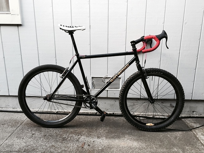

so this bike never jived with me when it had drop bars. It just felt weird and the handling was odd. It’s a 90’s MTB geometry with 26" wheels and a fat city cycles fork.
It’s currently being turned into a fat tired SS commuter bike with a front rack and bag. It’s way more fun than it was as an SS MTB riding it all over the city and it’s going to take me to work through winter on all the little trails and paths and through the epic snow.
I feel bad taking this bike off SSCX race duty, but it never was great at that, and it’s actually being ridden more, which I guess is what actually matters.

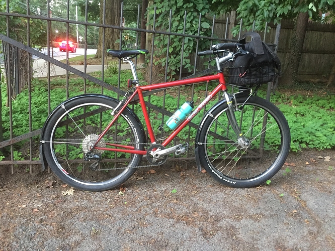

So far: old man mountain front rack, WALD basket to hold a bag, flat pedals, surly open bar with rise.
currently: brake cables interfere with the rack a bit. I was going to consider wrapping the bar with road bike tape and run the cables like a curby road bar that way I can grab the bar anywhere?
also for a bag: velo orange makes a perfect rolltop bag for the front…
at one point i took some IS disc adaptors and cut them down so i could use them between the brake and (new, longer) mounting bolt and that let me go wald basket strut straight from the brakes. probably not the most smart thing ever but it worked until i moves on to a crusty fork. brake bolts never loosened on me either.
