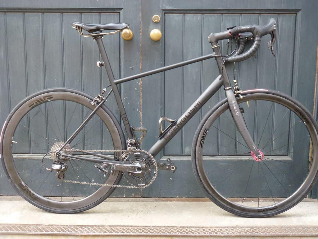

This is what I had on my traditional steel rando when that is what I rode primarily. TBH I would love this again but I don’t know how to achieve it with SRAM E-Tap 11 speed, the lowest gearing that is feasible is the 48-32 11-32 that I’m doing, as far as I know.
What’s to stop you changing your crankset? I don’t get it.
I don’t think I can get my derailleur that low on that bike
Given a 48 tooth large ring has a circumference of approximately 24 inches, the radius at the teeth (inch-pitch chain) is 3.82 inches.
A 46 tooth large ring has a radius of 3.66 inches, so that 0.16 inch is likely not going to make a great difference as long as you have enough space at the bottom of the cage for the 0.16 inch change there.
TL;DR unless you’re already at the absolute limit of your gorilla there’s probably enough room for it to work.
NB: I was always the guy who defended the customers who bought the wrong crank arm by 2.5mm and only found out about it when they took their bike to the shop. 0.1 inch isn’t much, and most people aren’t that symmetrical.
When I first got the black bike, I had mtb cranks and 46-30 rings with Campagnolo Record mechanical. That worked just barely okay. Then when I etaped my bike it didn’t work at all and I switched to a conventional 50-34. Now at the time 10 years ago when I got the bike, there were almost no options for 46-30 rings so I had some crappy rotor ovals on there, so it could have been the rings.
There are a lot more options now so I could probably get it to work. You can see in this picture that my derailleur clamp is literally resting against the bottom cage bolt.
Anyway doesn’t matter, I already have everything for 48/32 11-32 and that’s what I’m doing
