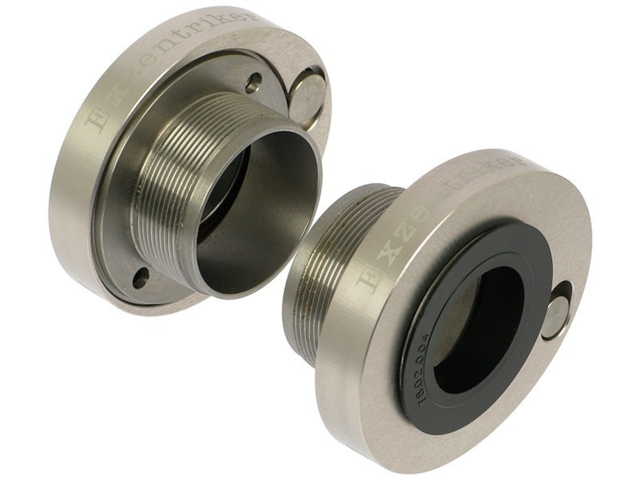

What is the existing BB on the frame? A bushnell might not fit. Although there are plenty of other options.
68mm english thread. it looks like there are options, i’m only doing this if there are supported components from current manufacturers.
edit: and if I’m willing to have a new bb shell / EBB clamp put in the frame - looks like most of what’s available ready-to-install is press fit. Makes sense, more space to work in, but not what I have .

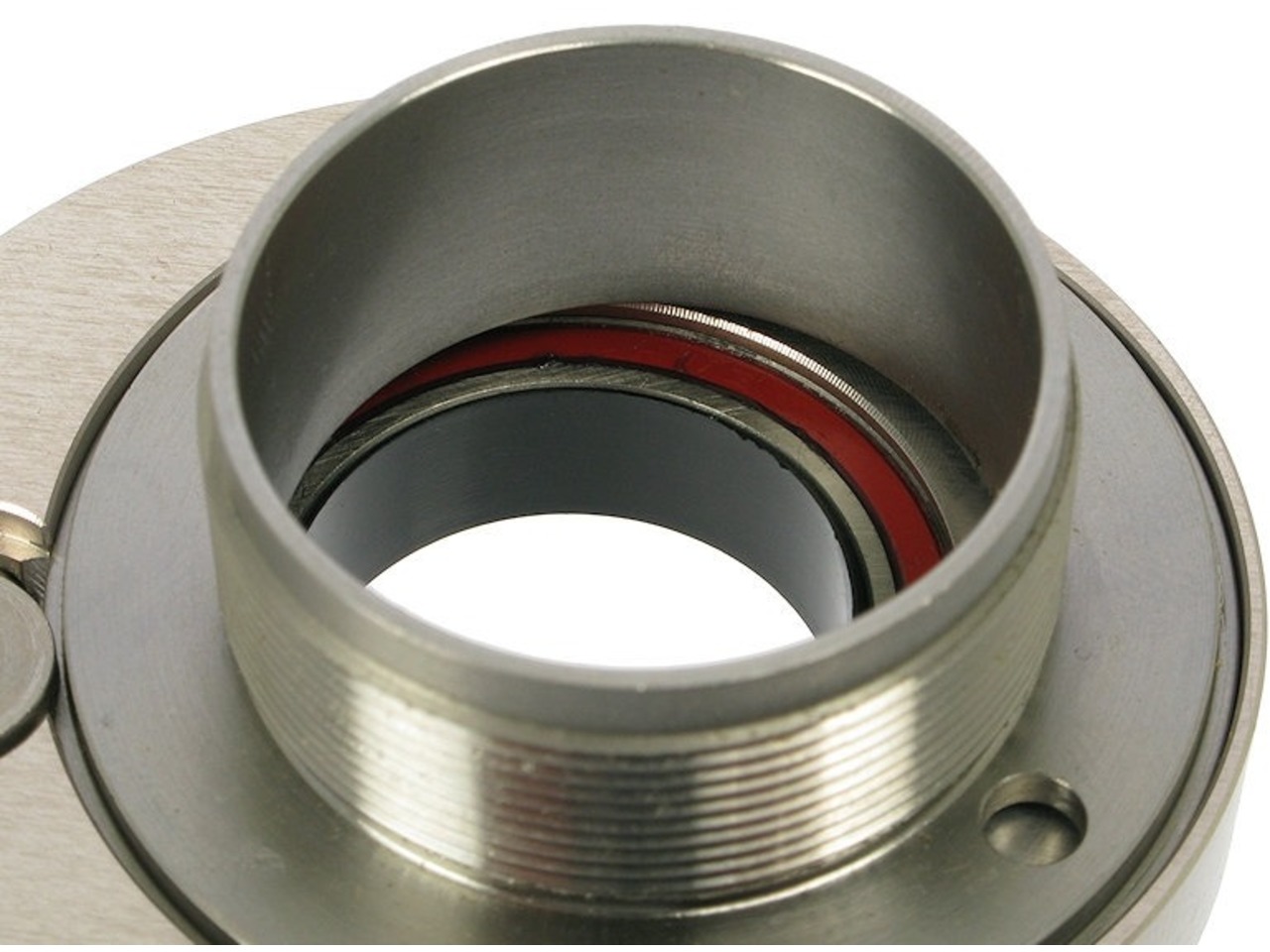

There are eccentric BBs for BSA threaded shells. This one is for a 24mm spindle’d crank.
Looks like it has a 6mm adjustment range, and comes with a 7/8/9 half-link.
I know there is at least one other on the market but can’t recall the manufacturer.
The other option is to trust in tarckbear and go for a magic gear. Which has a certain fun element of fate just choosing your ratio choices. (and/or hunting down oddball chainring tooth counts).
I have done this successfully on two different frames and it was fine!
Phil Wood had one, the problem with these designs is the eccentric is clamping a threaded part, so break out the Loctite.
Phil wood, philcentric
But it’s in and out of stock frequently
