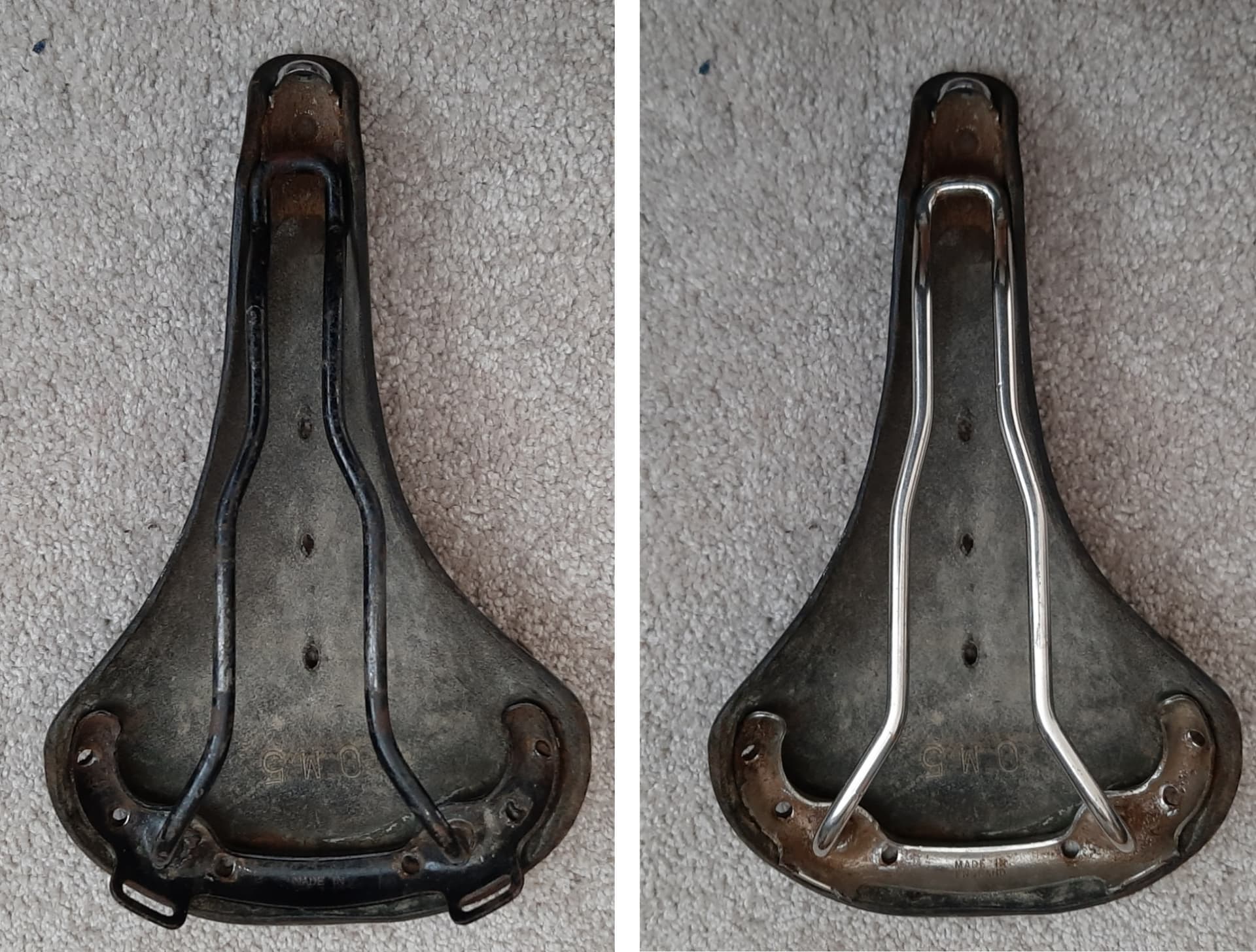

I put out an APB last night for a new chasis for my bent B-17 and within a couple of hours I had 3 potential donors. 2 from my neighbor! Ha ha. That’s the new one on the left. Strangely the steel rivets were easier to drill out of the donor saddle than the copper ones in the original. I might look at bolts rather than rivets as they will be a PITA to get here, try to copy the Berthoud thingo as someone kindly suggested. I better get the neighbor some craft beers… Might get some for myself while I’m there…
I wonder if Brooks ever thought to replace the front part of these things with something made of alloy? Man those parts are heavy.
