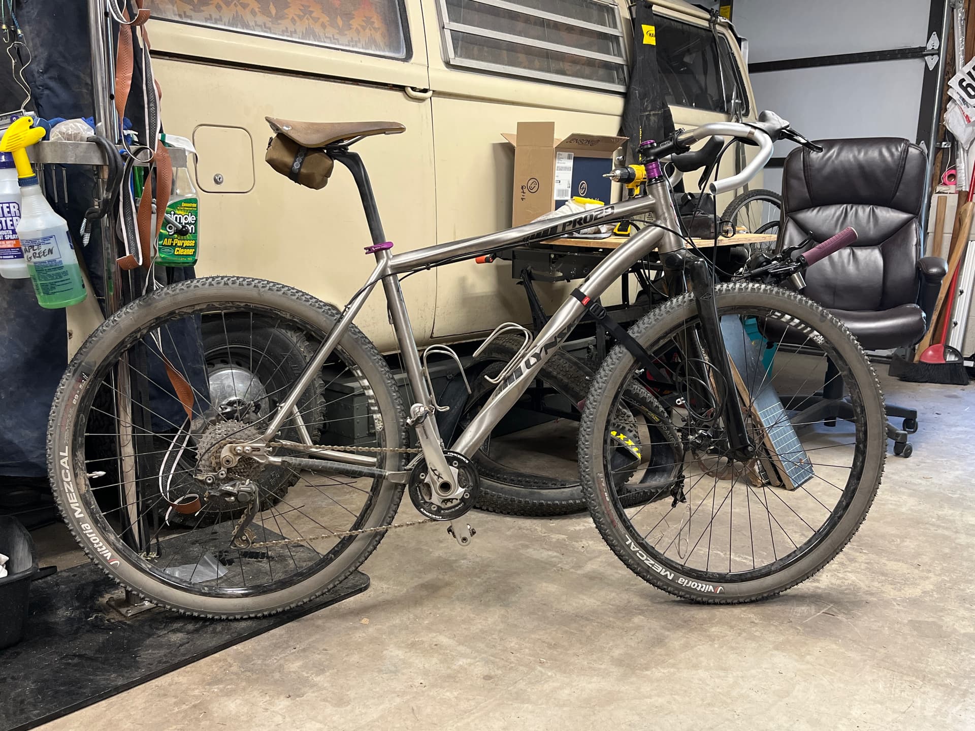

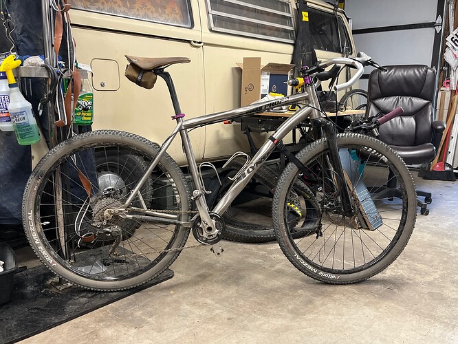

Digging the mock up feel so far. Kind of a goofy look, but it’s making my hands happy. Been fighting numb hands for a few months so trying out some weird stuff.
ht angle looks even steeper now.
this is p much a geared polo bike with drop bars.
You aren’t that wrong. It’s a twitchy twisty thing.

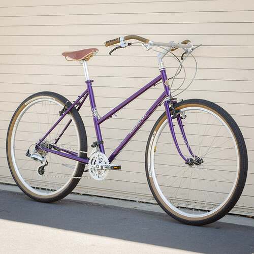

I’m in my even year cycle of thinking “I should dither together an upright bike”, step-thru edition this time around, and then discover that these are going on presale tomorrow. That purple would be pretty great.
dithering is more fun
