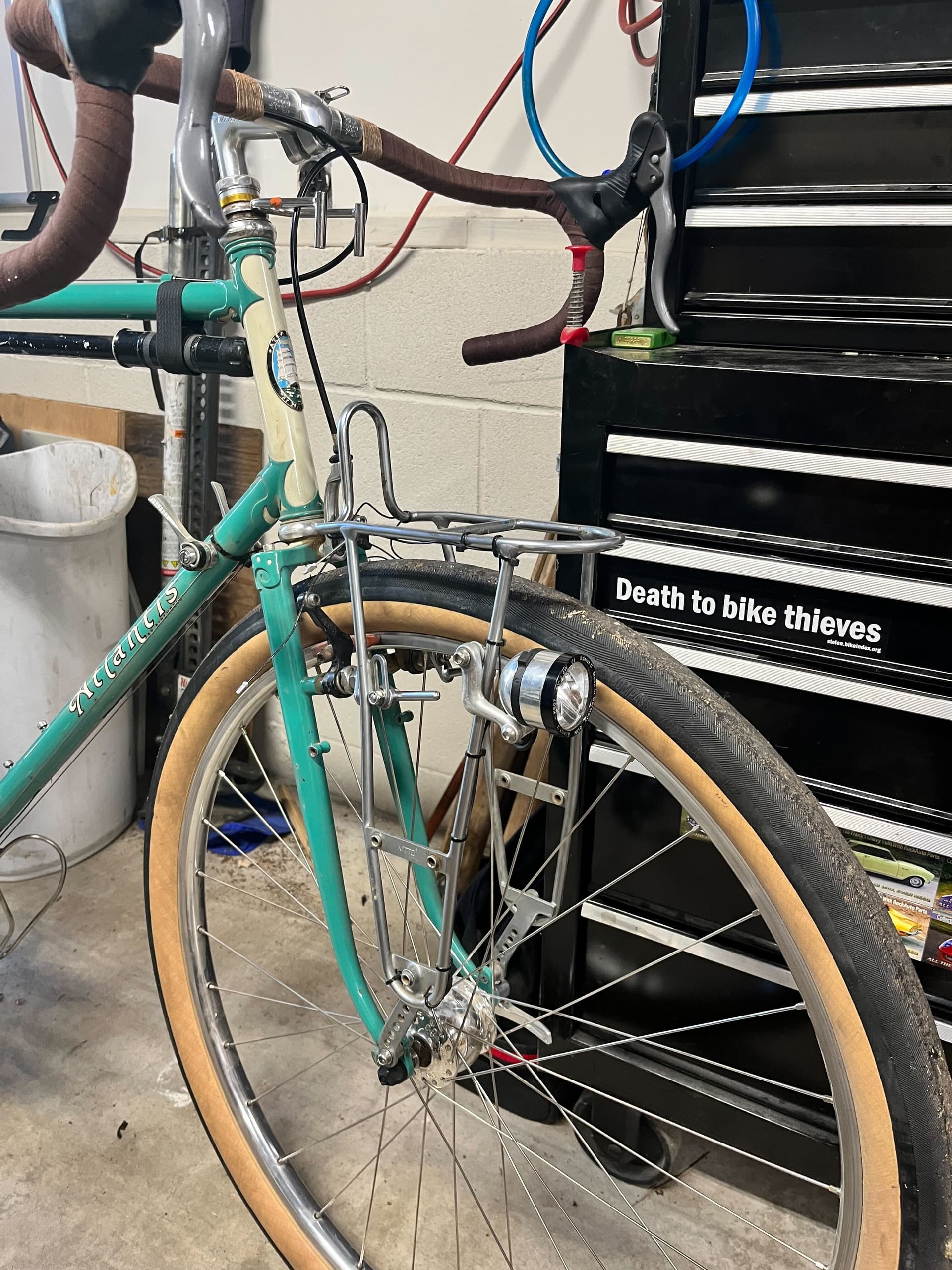

Drilled my canti mounts a bit and moved the rack up higher to get more tire clearance.
I’m ok with it.

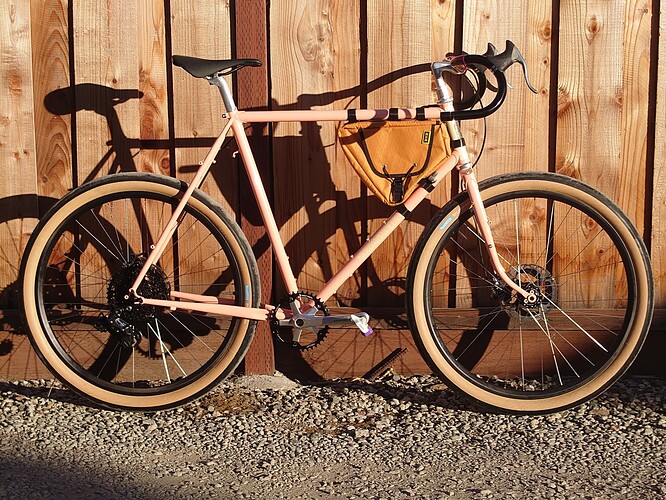

urf ok i need some hivemind help. do you have arcane non-brifter dropbar cable pull knowledge?
i am attempting to enter my fopchariot era:
These brake levers simply do not pull enough cable to run the disc brake calipers. Levers go to the bars before adequate braking is generated, even with compressionless housing, even with the shorter housing run on the front, with Shimano BR-CX77 calipers, or Juin Tech GT-P calipers, or Growtac Equal calipers.
Does anyone know of any plain brake levers (not brifters) that pull more cable than older aero levers? I am not quite yet at the point of throwing in the towel and doing a SRAM doubletap setup.

I have gotten “Super SLR” ST-7700 9-speed brifters to work with disc brakes before, apparently the “Super SLR” of these BL-6403 levers isn’t the same.
I think Paul Klampers with the short Campy arm would work great but I feel like I should not own THREE bikes with klampies.
Dia-Compe 287V were designed for use with “mountain” linear-pull brakes, and as such pull a lot of cable.
Diamondback EXP came with TRP RRL/TRP Spyre and they worked really well together.
Sram S500 might be an option as well. IIRC those were popular for a sec at the end of the fixed gear boom when it conflated with SS cyclocross disc bikes.
ETA: Some guy on bikeforums calculated the MA of the S500 as 2.53
Might not be foppy enough but there’s a Tektro lever that works well with Spyres… the RL340, I think. Should work with the others.
have you owned TRP Hylex yet?
I really really like their hydro levers, the only caveat is that they can extend your fit for braking from the hoods
i have indeed owned hylex brakes at one point in time; i might even have half of a set in a bottom drawer somewhere… The extra-long hoods were super comfy but i’m not sure if the extra reach is going to work on this bike (peep that 70mm stem)
yeah this is kind of the way i’m leaning after poking around.
the other clear option is to pick a caliper that is known to work with short-short pull levers: the immortal BB7. but i inexplicably do not own a set, and getting a set of S500 levers to fool around with looks cheaper than getting a set of BB7s.
