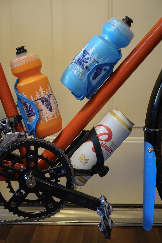

So the Ardunel Looney Bin didnât fit quite as nice on my disc NFE as it did on my canti NFE. I was hitting the chainrings with any reasonably wide bottle or can regardless of how long the spacers were. Decided to give the Wolf Tooth B-RAD spacer/slider a try.
Works fantastic, really happy to be able to fit a 24 OZ beer (and my tallest water bottle + fenders) with room to shift.
Note: removed those nylon washers/spacers after realizing the instructions said that they were optional to be used between B-RAD and frame.

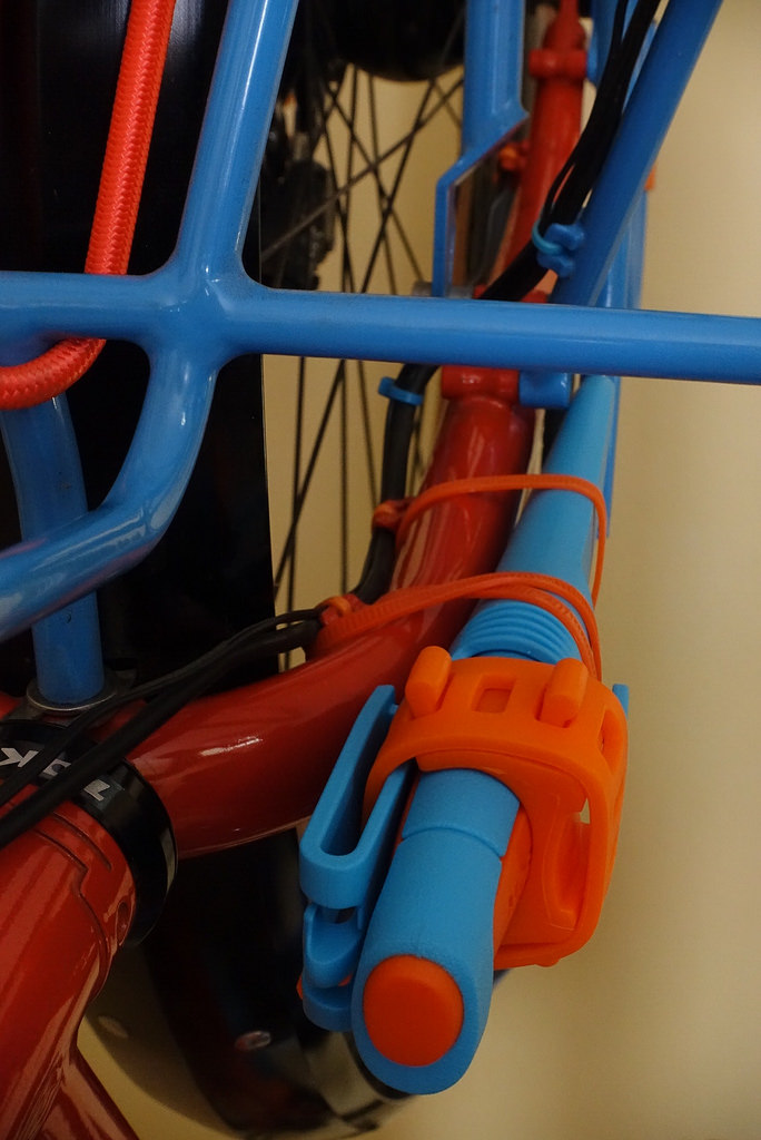

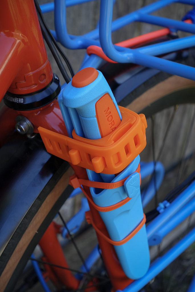

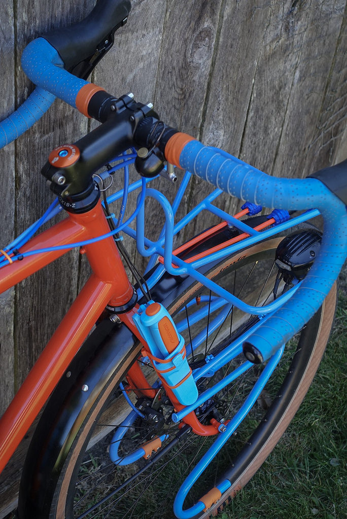

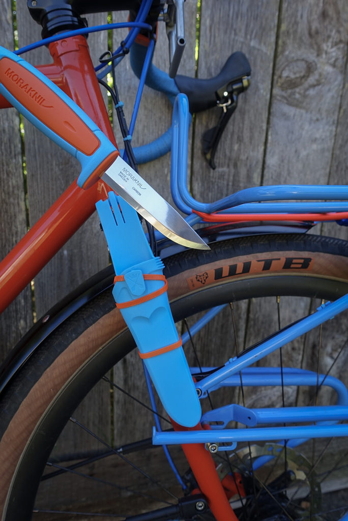

Fred discovered a #Tacticolor knife that matched the Elephantâs colorway.
Then I discovered that the silicone Otto lock mount I had in my parts bin was a perfect retention strap to keep the knife a little more secure.
Crossing the zip ties around the dynamo wire guides keeps the entire thing surprisingly secure.

Holy cow, that knife.
Love how fun Mora are with those cheap bushcraft knives. That is the most boss matchy match game on earth.

[quote=Andrew_Squirrel]Fred discovered a #Tacticolor knife that matched the Elephantâs colorway.
Your bike is out of control and I love it.
