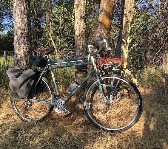

put a cartoonishly large basket on my bike. I like it so far.

[quote=kmcdon]
put a cartoonishly large basket on my bike. I like it so far.[/quote]
Which basket is that? Wald?

[quote=deadforkinglast][quote=kmcdon]
Which basket is that? Wald?[/quote]
Yeah. It’s the “giant delivery basket” and boy, is it huge.

Put a Wald 139 on porteurbike, officially making it a basketbike.

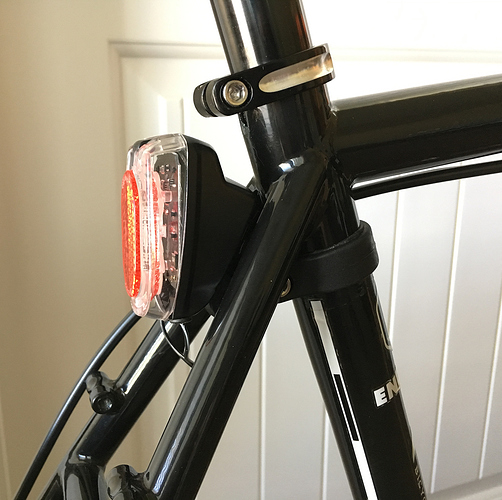

Finally found the little plastic lego things for the Secula, so I rewired and refined the rear light mount on the ruiner.
