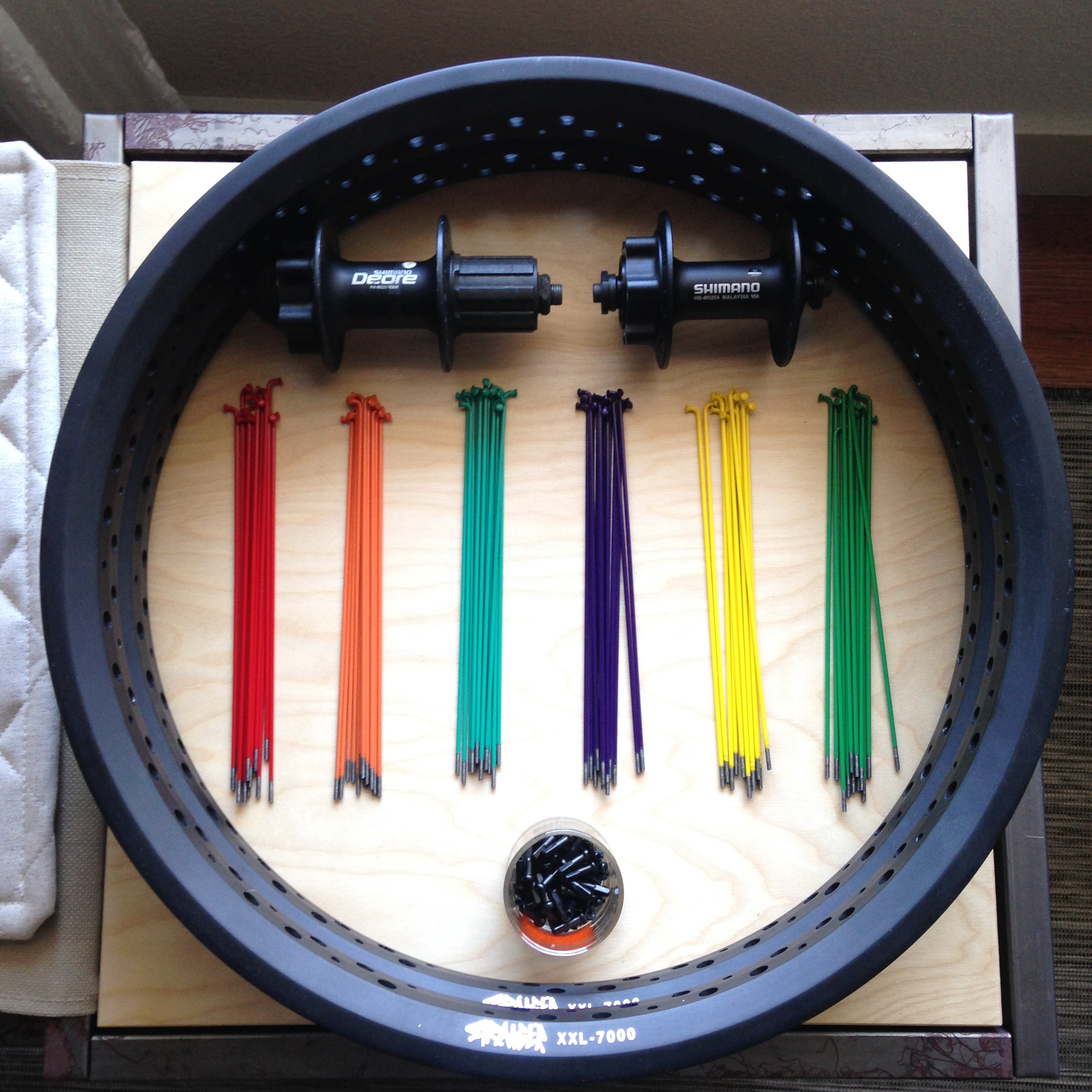

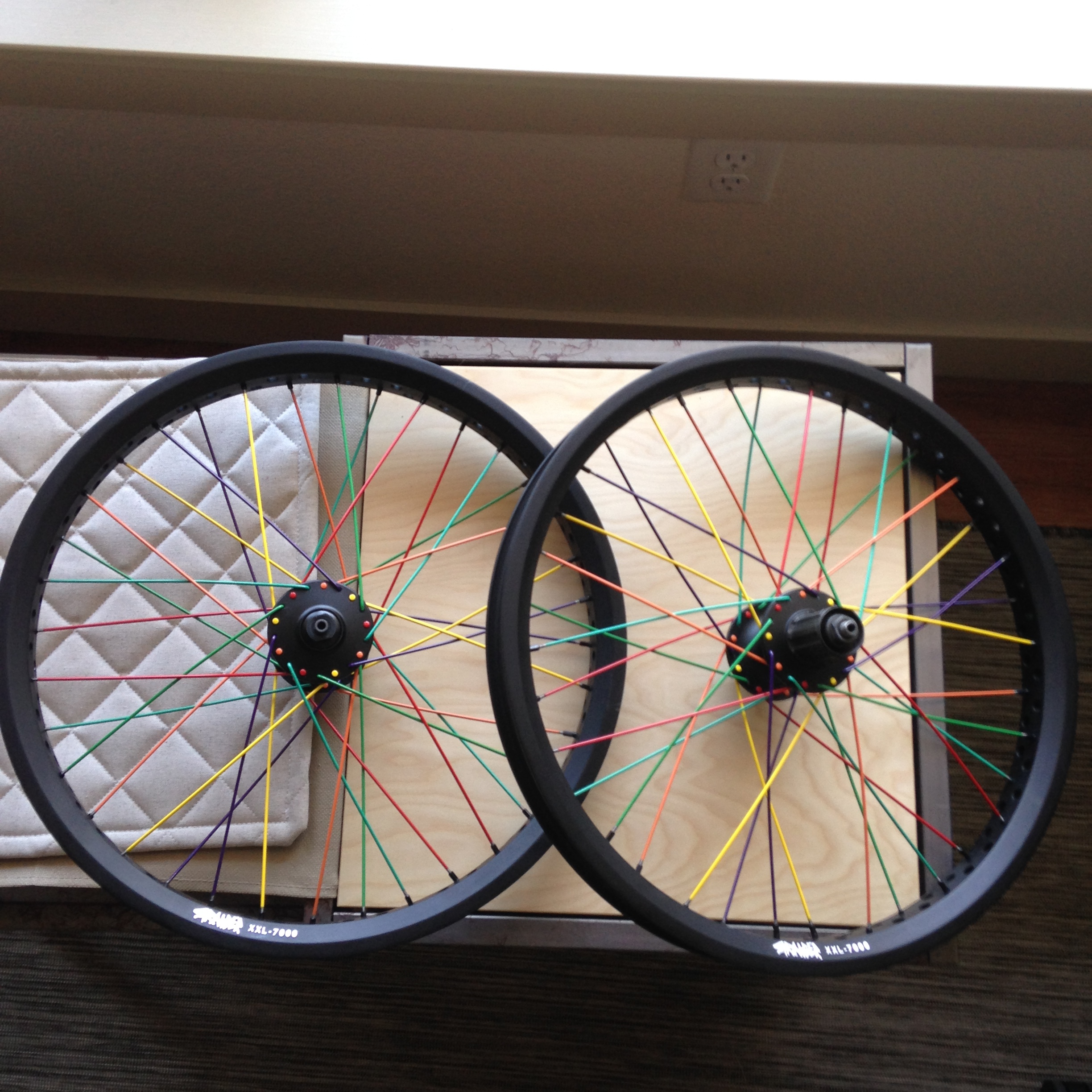

Laced up the new wheels for the Burro. Now to tension and true!
if this isn’t paired with the kmc multi colored chain on a sw8 20” fixie, it’s badically all for naught.
tbh it’s a little more rasta than I’d intended.
googling colorful 10s chains now…
or do you mean bolt-on fixed cog w/ a kmc510? :laughing:

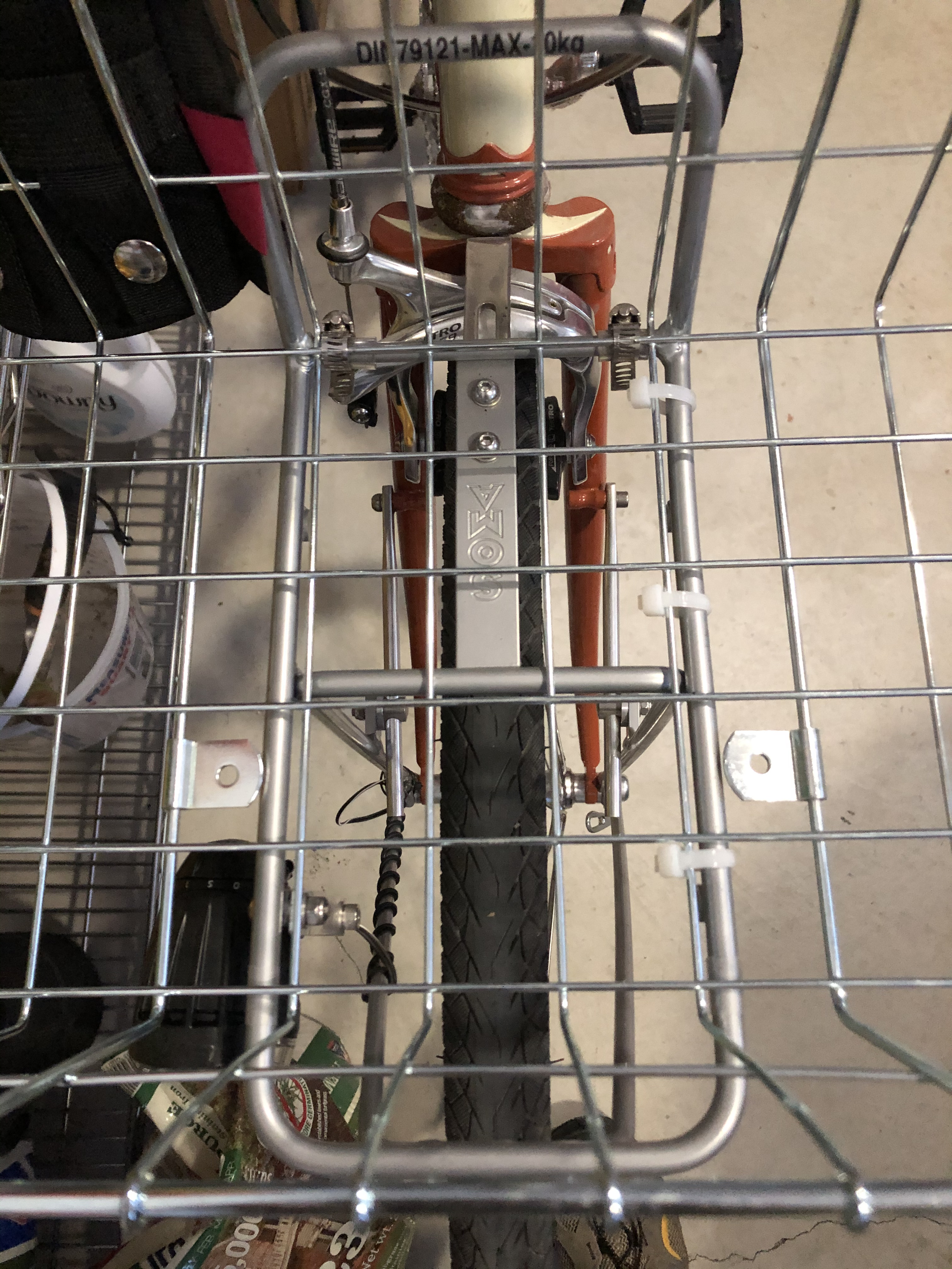

Also somehow all of the zip ties on one side of the basket had broken. I only noticed it because the basket was making noises it didn’t used to. Took me entirely too long to figure out that no I was not an idiot, this time, and had in fact zip tied both sides of the basket when I installed it.
White zipties die pretty quickly for me in that type of usage, they’re less UV stable afaik. Grant or Jan had a tip of using old cotton bartape to wrap racks to baskets if you wantedalternatives to big black zip ties…
Looked at the bag tonight and they are indoor rated zip ties. I never paid attention to that. I cut the same ones off another bike tonight to swap a 139 basket for a 137 and they were pretty brittle, as much cracking as cutting. Put on some black outdoor rated ones.
I found a local source for hemp twine, so maybe that’s the next step.
Each basket gets at least two hose clamps, so they’re really just helpers anyway.
Ah, didnt see those hoseclamps, yep that is an even better failsafe.
Yes black zip ties have UV resistant additives. If you had a bag in your basket you would’ve been fine for loads longer
Weird thing is that it always had a bag when outside, but usually not in the garage which gets a lot of light and warm in the summer. Garage has three high east facing windows that aren’t covered at all and a south facing garage door with translucent panels.

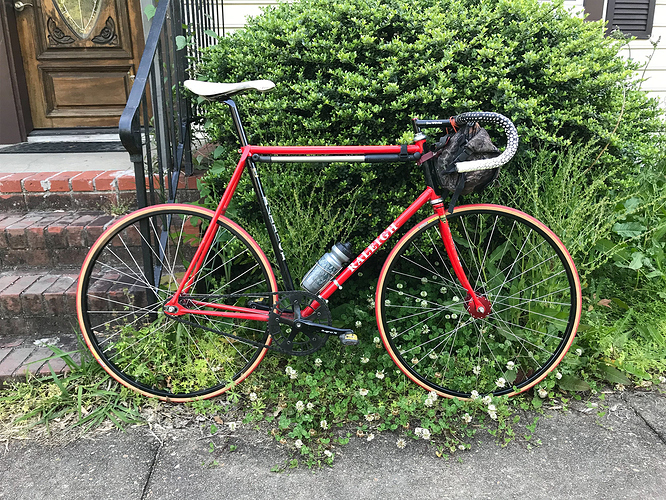

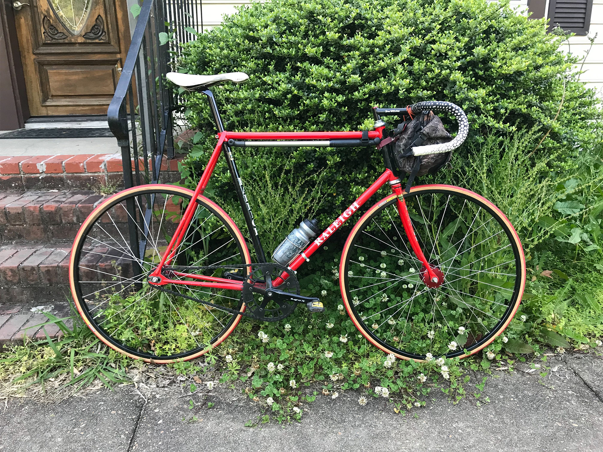

Changed a flat on the Tarck bike and figured I’d install a bottle cage and smaller cog while I was at it. It’s the small things, as they say.

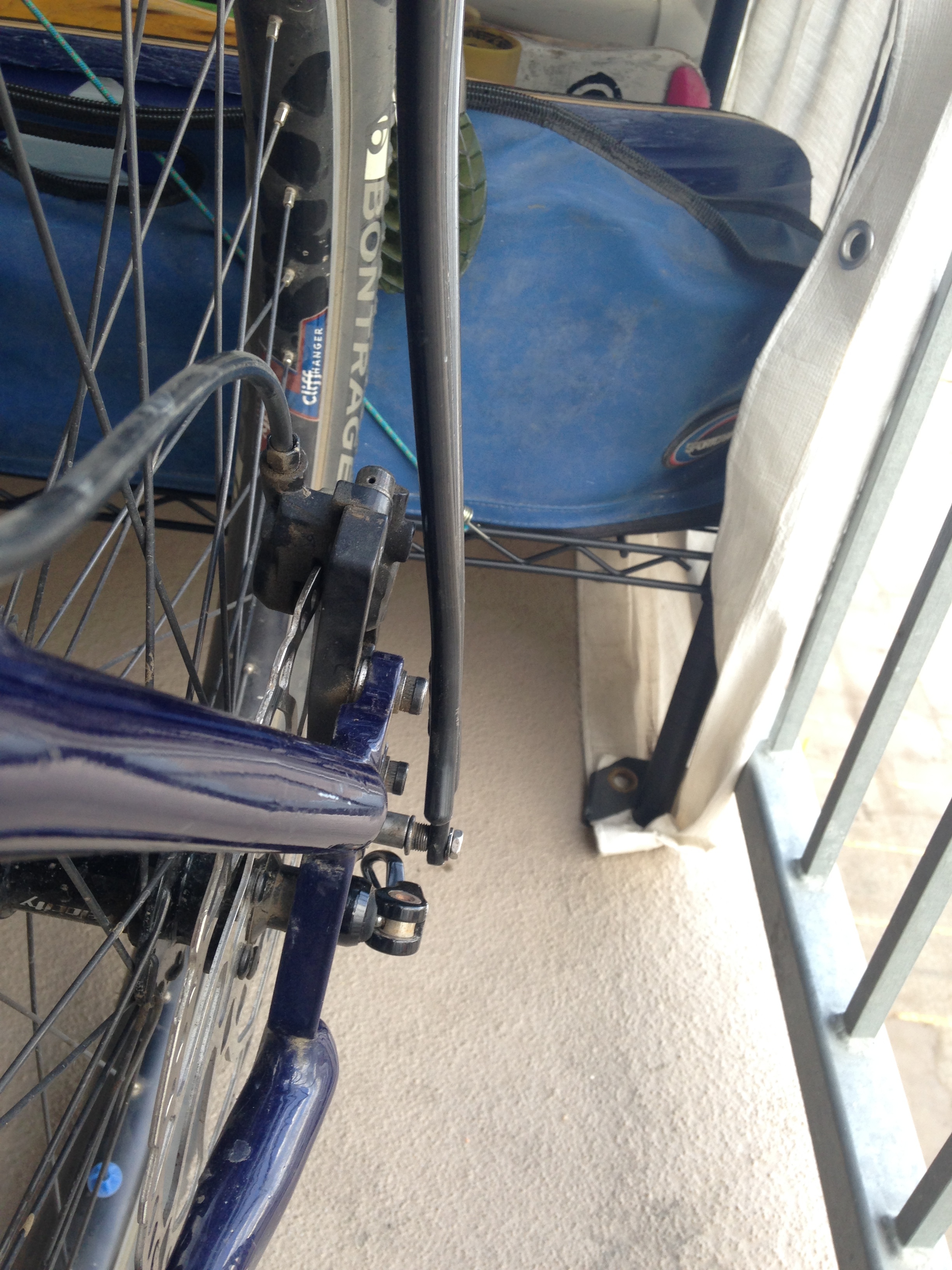

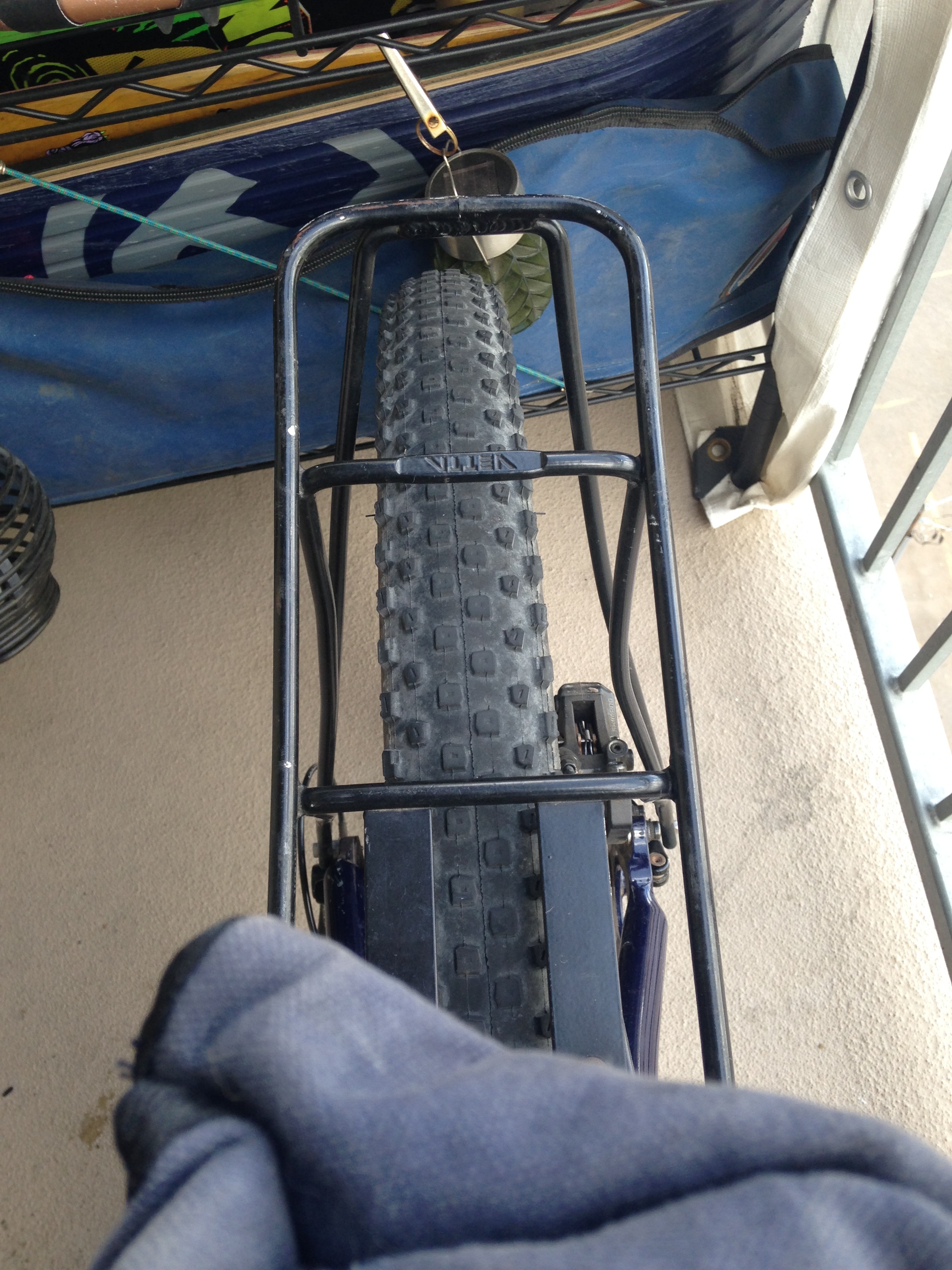

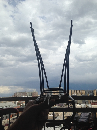

This rack used to be quite narrow. After a bit of persuasion it now fits the tandem and clears the caliper. Hopefully it doesn’t fold under load :grimacing:
