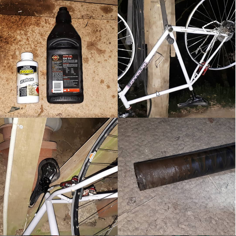

All of the above is done to avoid getting a stuck seatpost out of my sport touring bike, which has thus far resisted my best efforts (Liquid Wrench and twisting the saddle really hard). Going to try tossing boiling water on it next.
Do you want to save the seatpost? If not, use a pipe wrench to increase your leverage.
if you have ATF and acetone and access to the BB, pull it, mix the liquids 50/50 and pour down the seat tube, leave inverted for a few days

Ive used the following technique on two seized posts. Do the soaky bit, I think I used 50/50 acetone and some oil… thought it was fork oil (edit), but cant recall exactly… (I read about it on tarck somewhere) but the thing that did it, was wedging the saddle between two up-rights, under our house, and using the whole frame as a lever. Put a shitter saddle on the post, as it will get really munged by the forces. Do it like this and there is every chance that your post will still be usable at the end. Ive done it on steel and a carbon on carbon scenario.
