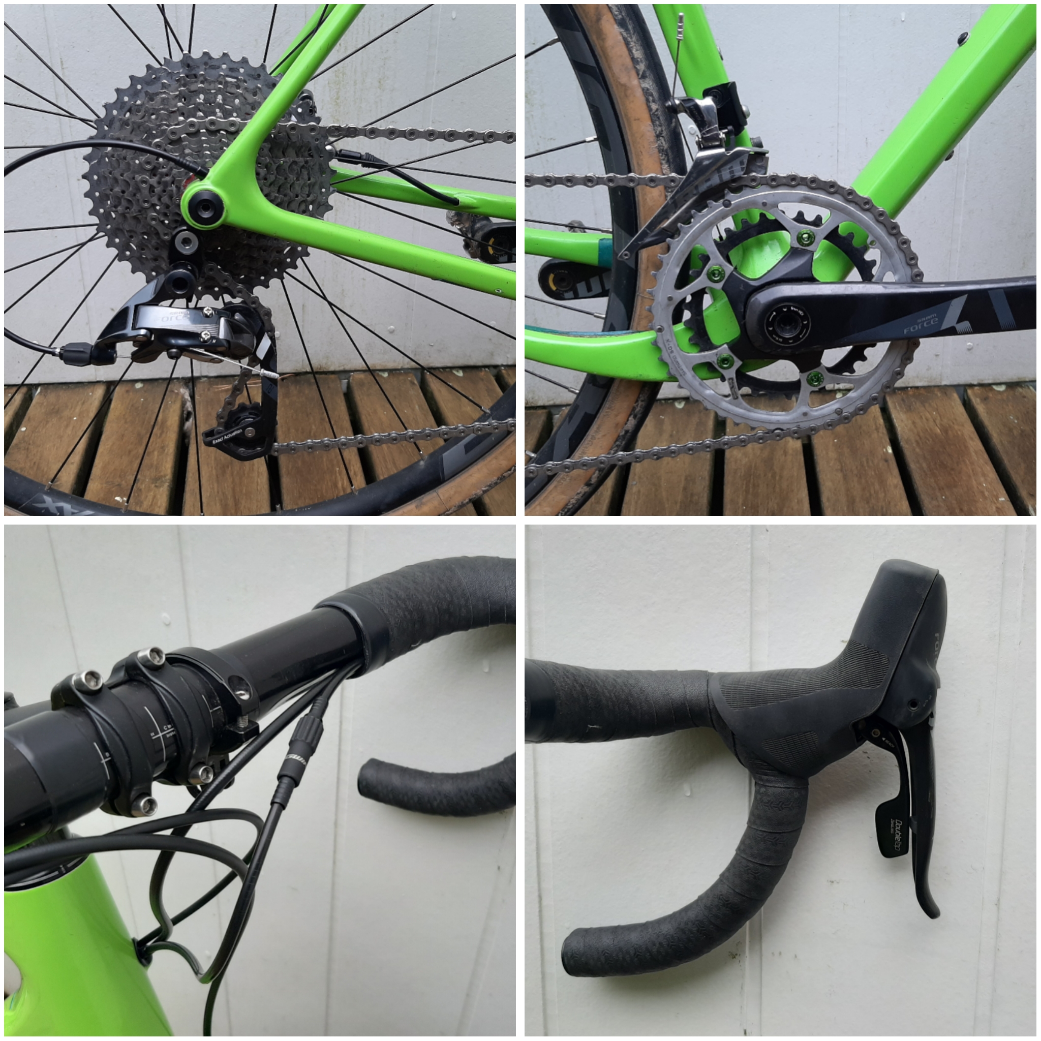

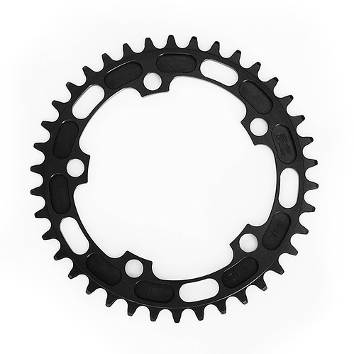

Open 2x is finally done. Can’t be many Opens rocking a vintage MTB chainring. Maybe I will swap it out for my biopace 46. Accidentally installed it all with an 11-42 cassette on the back instead of my wheel with the 11-40 on. I can cross-chain no problems with the 46 front and 42 rear. No rubbing anywhere, although that’s only in the stand, still not ridden it. I do like this tail-hook-lengther life tho. It would probably work very well with a 48 on the front with the 40 on the back. Little ring is a 34. Derailleur is at its lowest point. I have a chain keeper. Wondering if I should install it? This bike does lots of trail riding. Gonna order a new front ring from these guys I reckon.
Definitely run the chain spotter.
Done. I sure got no complaints with this Y’all derailleur. At this point…

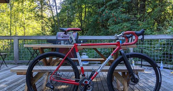

Got my Poprad mostly put back together.
New fork, new front wheel, new crank with the Doval 30/46 rings, new pedals thanks to Dr. Welby. Gravelking SK tubelessed pretty easy, although I’m worried the rear won’t hold air but we’ll see tomorrow.
I think my dangler is bent. I checked the dropout alignment and it was perfect, but the pulleys are way out of line. I can’t see anywhere on the body of the dangler that’s tweaked but I can’t figure out what else it might be. I think I’m gonna order a GX 10 speed to replace.
Brake adapters are making me mad. I could have sworn I got a flat mount CX77, but it’s definitely not since they don’t make one. I’m very confused by Shimano’s myriad of adapters.
So I thought I’d be able to finish this bike today but it turns out I need more doodads.

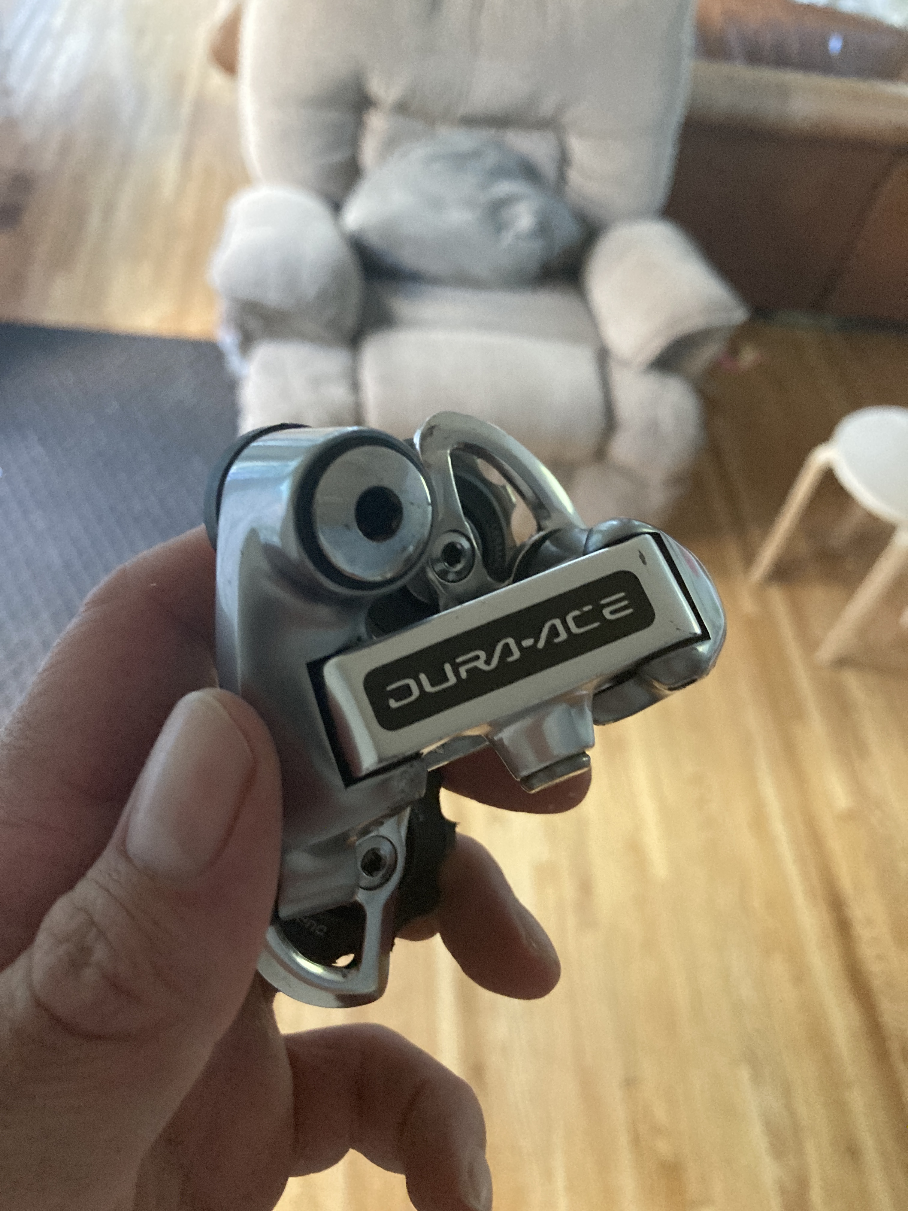

Wow this is some nice shit
For being thirty six years old
I think I still like suntour mk2 better but that shit is rare as fuck and I don’t wan to ruin mine
I can only hope someone says that to me next year on my birthday

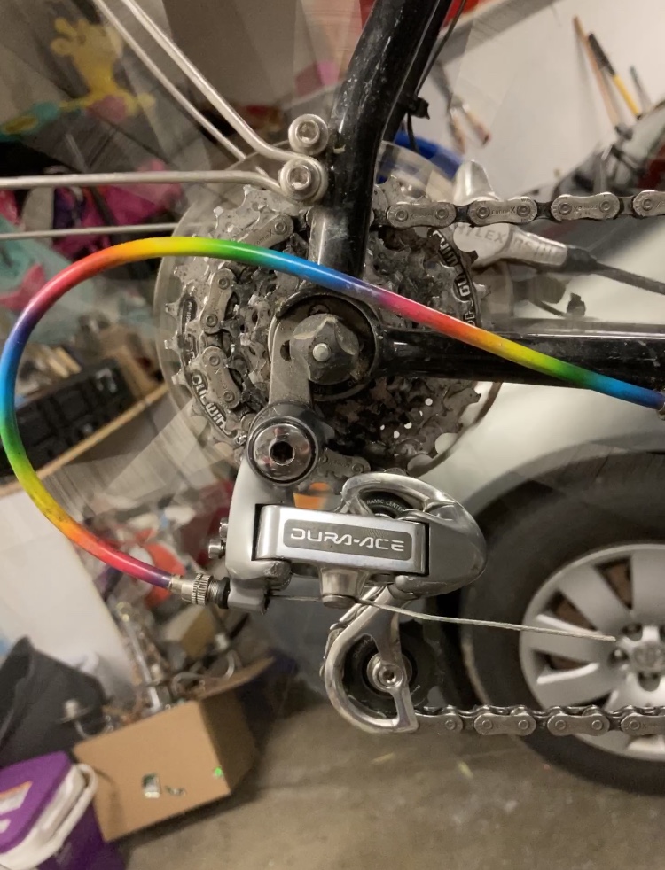

The one grantism I shall never abandon is using DT shifters for truly ludicrous drivetrain decisions
I’ve got that one too. I wish now that I’d looked after it better rather than just using it as a singlespeed chain-tensioner, but I’ve committed some serious crimes over the years. On our ride in the weekend I noticed the 4 of us all using completely different shifting mechanisms. One with friction DT shifters, one with Gevenalles, one GRX and my own Sram force with 2x gizzard donor.
