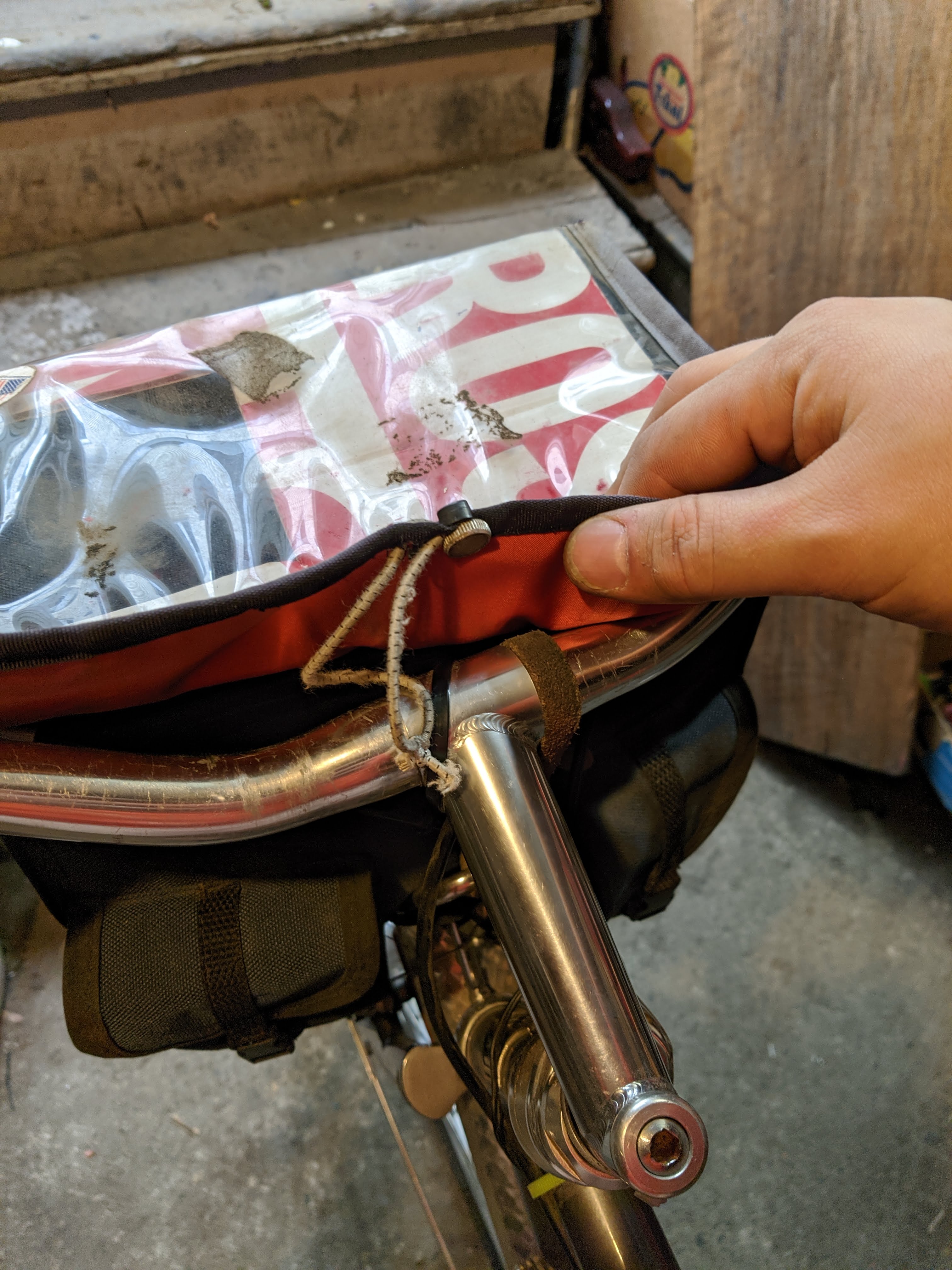

Also threw a magnet from an old bike computer on the flap of my bag, not sure it replaces the bungee cord entirely but it might.

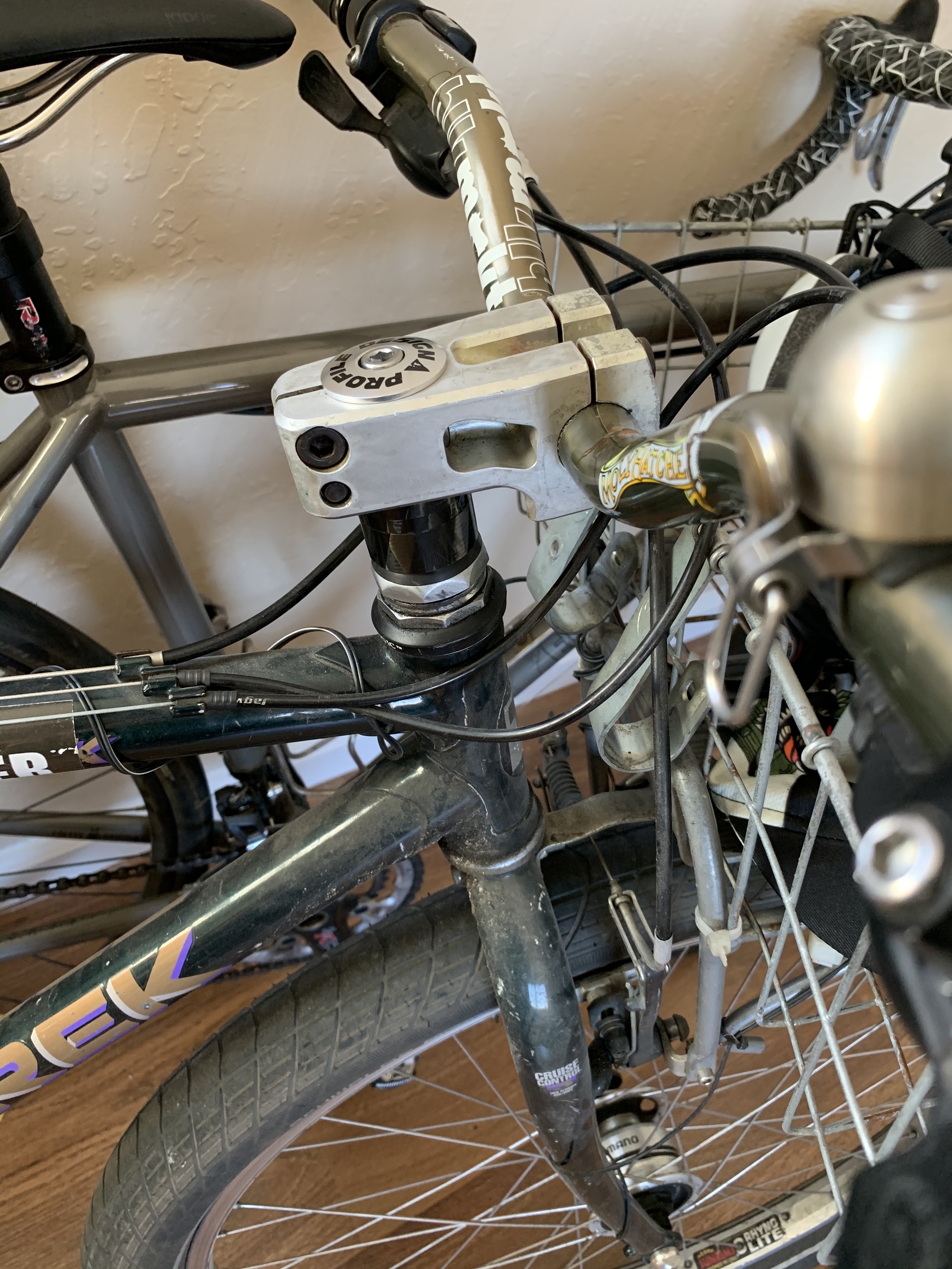

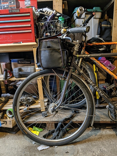

I found this stem in storage earlier this summer that my friend gave me years ago. He got killed by a car earlier this summer and it felt like I should take it out of storage for whatever reason.
Threw it on the commuter bike with a threadless adapter to replace the shitty profile 1 1/8" boner quill I had on there.
Spacers are cosmetic and are what I had in the parts bin. I probably actually need another 10-15 mm higher if I am going to keep the position about the same, but ran out of spacers. I guess I’ll see if I like that.
Now my bike is probably 2 lbs heavier but eh

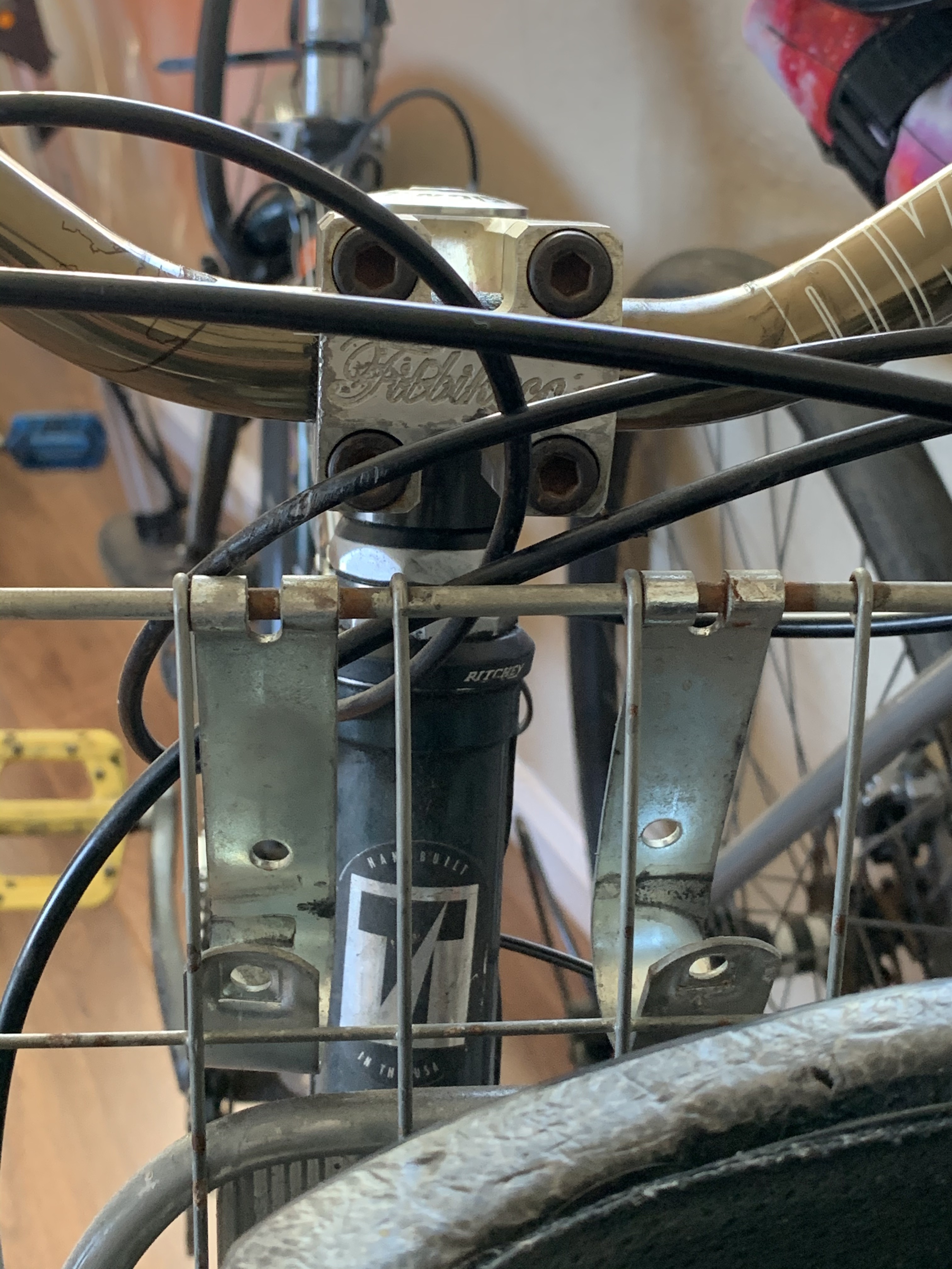

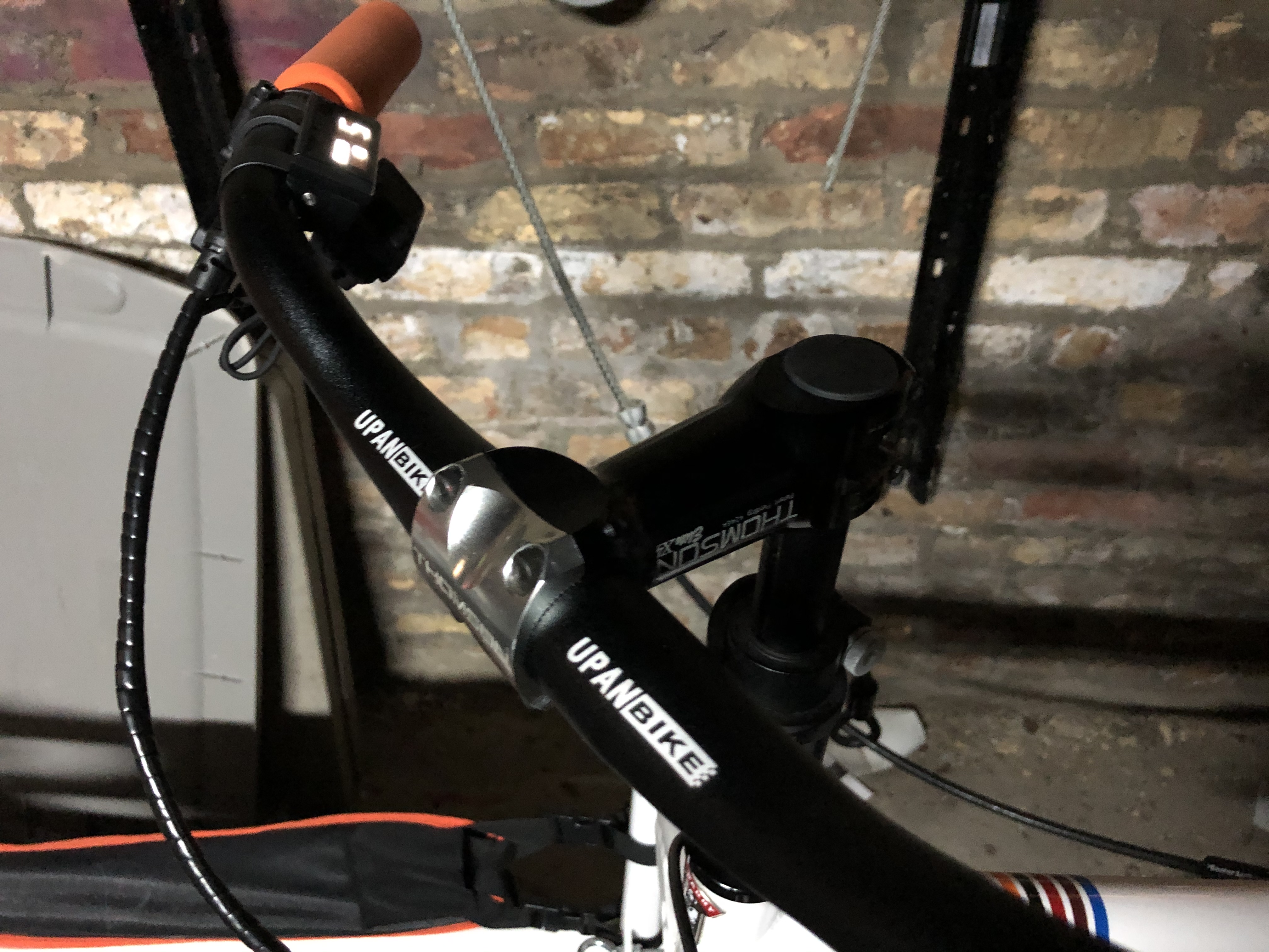

I put a stupid upside down stem on my Bullitt. Also some bars that are a lot like the noirette bars (which seem to be unavailable) but a little narrower with a little more rise.

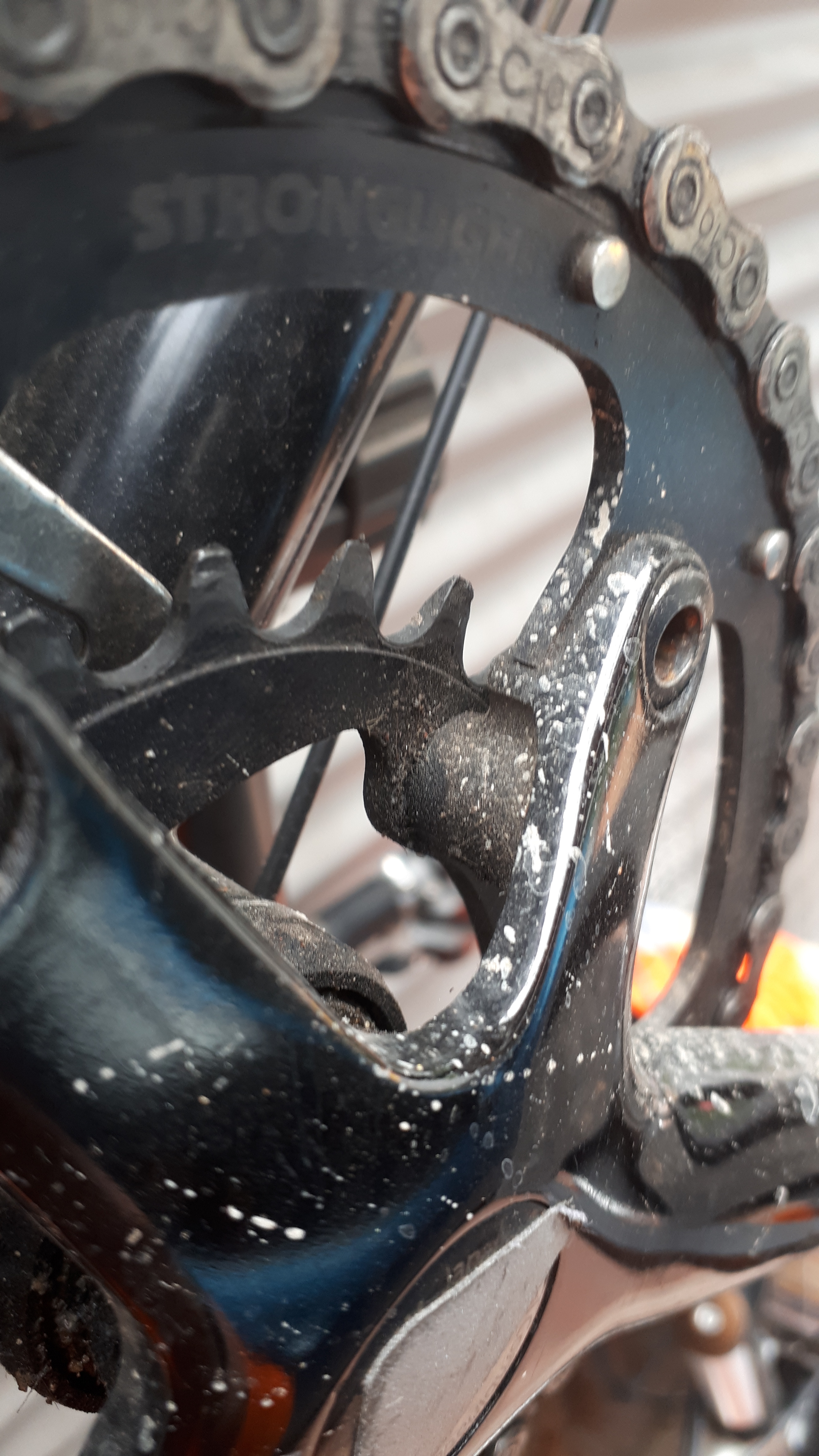

Installed some Japanesque Ideal Design Combination (aka Dixna La) nerd cranks on the endpoint. Frustratingly, they didn’t ship with the right spacers for me to install my 30t nerd ring, but I was able to get my old 46/34 rings on there.
It all bolted on no problem and then I didn’t even have to adjust the pusher. For some reason it even shifts better.
The low Q felt good to spin right away, but even just cruising around the neighborhood I could feel that my thighs are going to be rubbing the top tube a bit more like this. Clipping in, though, it felt like my feet were exactly where I wanted them.
FWIW, mine are fine without any spacers on the 74bcd, though mostly have been shifting friction so maybe there are issues I’m not picking up.
Hmm. It seemed like it would be too close to the outer ring, but maybe I am just imagining that. I’ll leave it like it is for now, since I probably just can’t be fucked to take it back apart for now.
this is what mine looks like if that is any use.
Huh. Maybe I was just being paranoid.

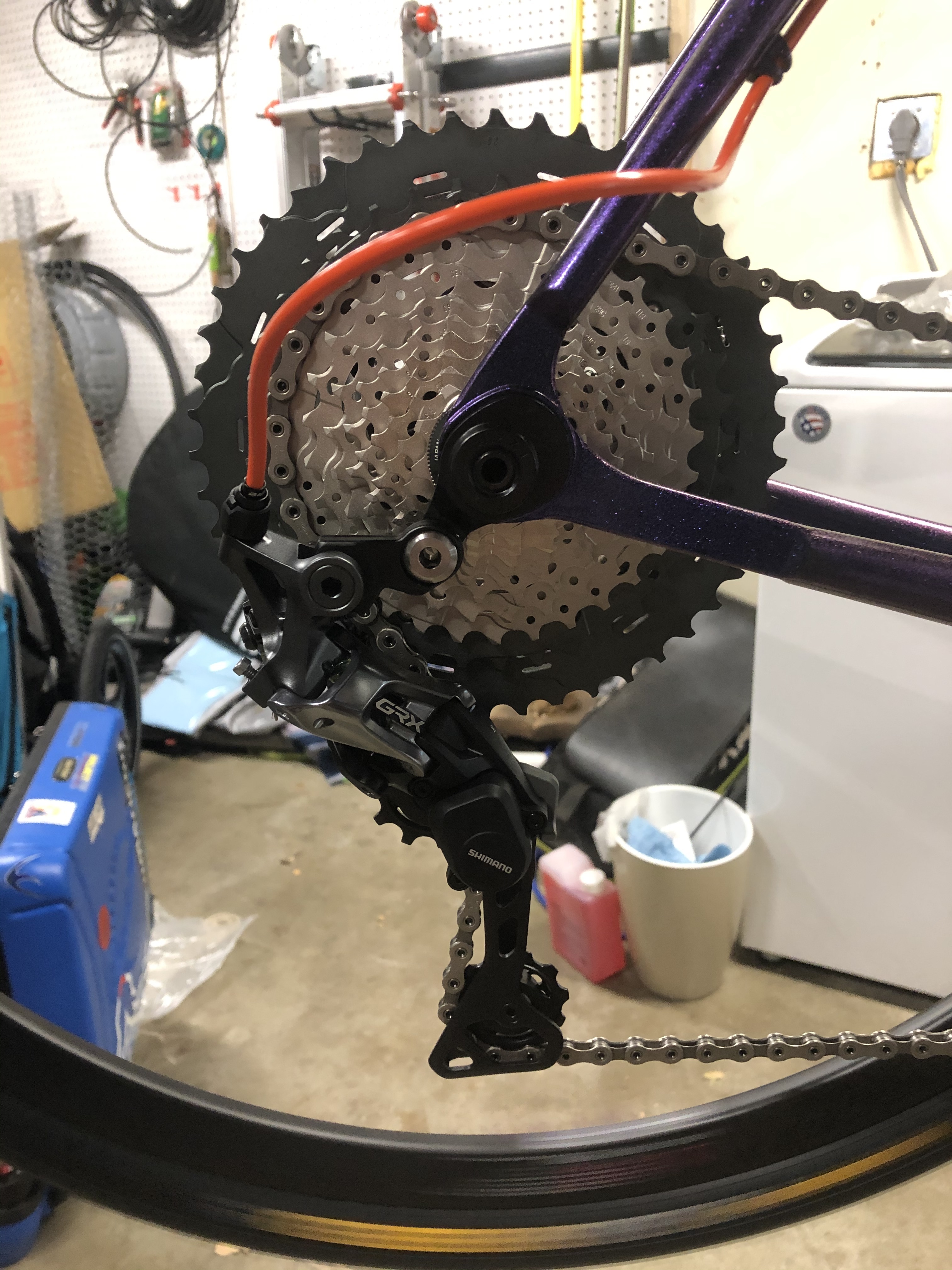

  • Finished installing the shift housing
  • Installed cables and adjusted shifting
GRX812 dangler plays real nice with a 42t. B limit screw only maybe 3/4 of the way in.

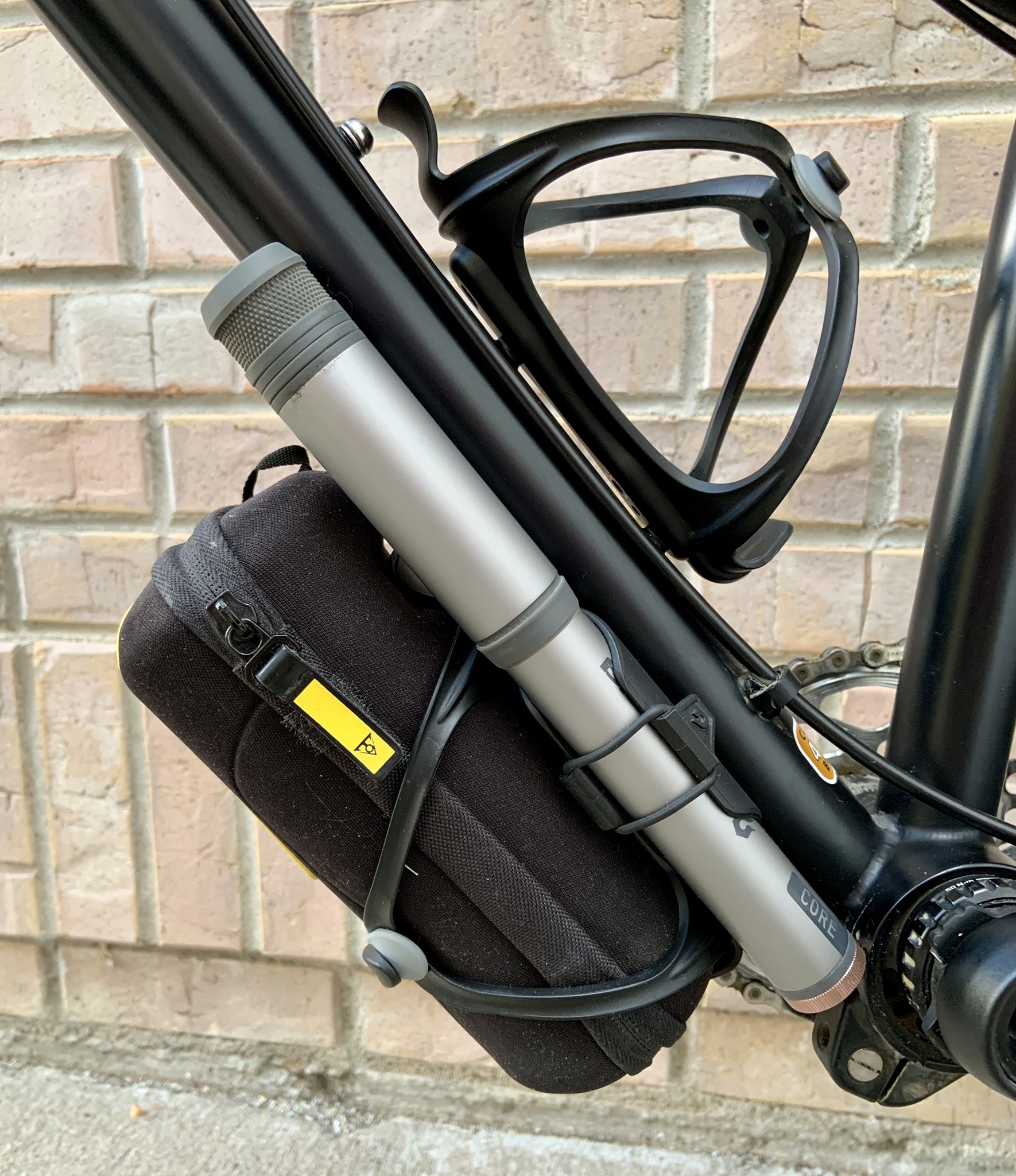

Moved tools/spares out of my hydration pack and onto the frame. Will eventually replace the lower cage/pack with a roll-top bag that straps directly to the downtube.
