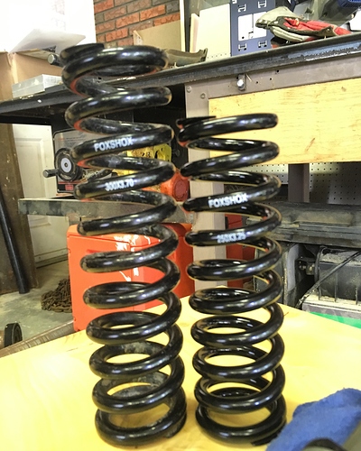

Ordered lighter coils for supās dh bike. She was a trooper and rode that thing for four days to get a feel for it. Still doesnāt love it (not as plush as one would want), but proud of her for putting up with it. Checked her fork spring and found some oil in there. Kinda worried, because only thing in there should be grease put on the coil itself.

Ordered a smaller coil spring, but was perplexed when I couldnāt remove it. Turns out someone managed to get the far too long 300# spring on there.
It took bike shop owners hydraulic press to free it since they donāt have any fancy coil compressor jawn.
Size difference between the wrong and correct length springs.
