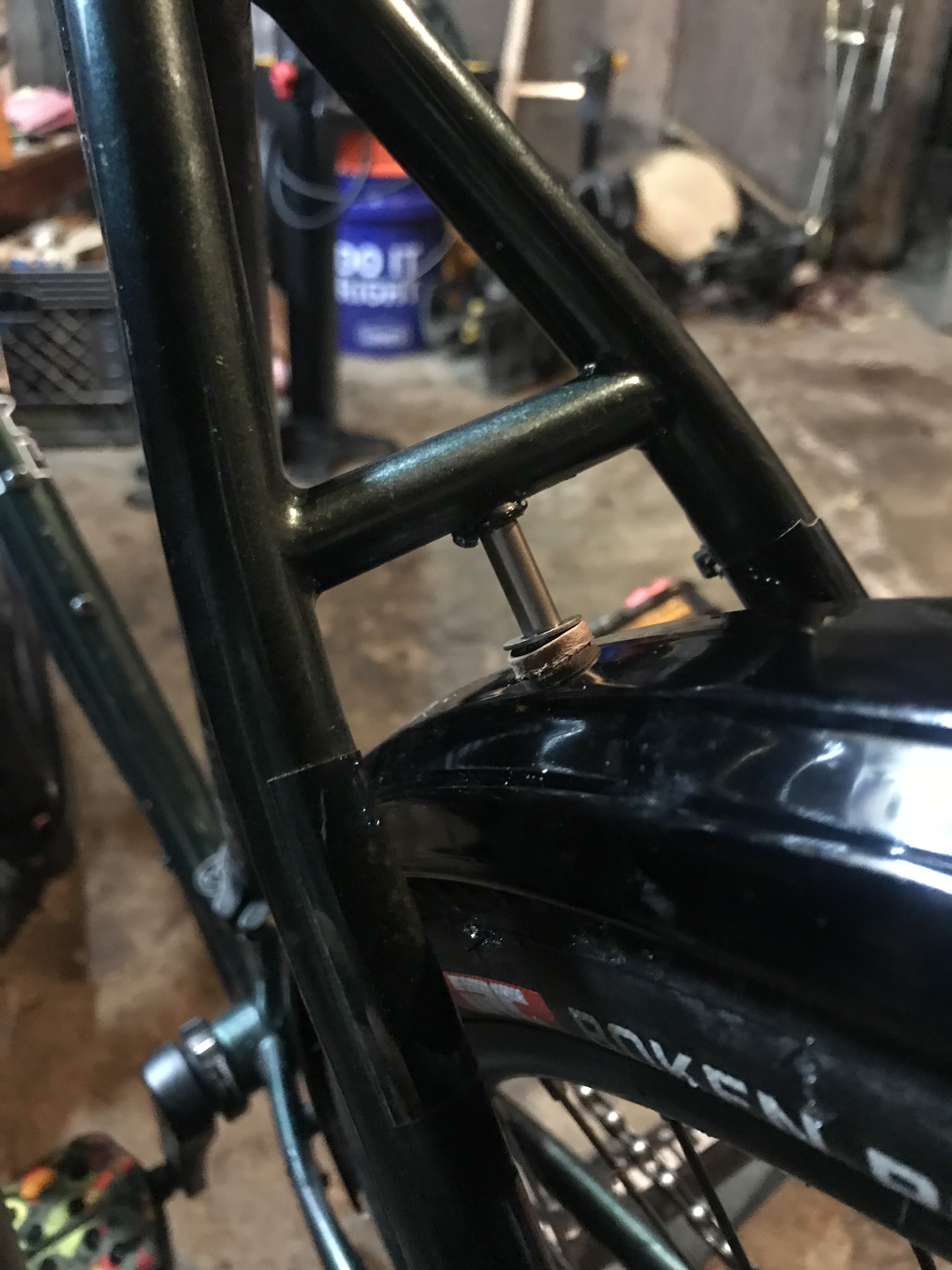

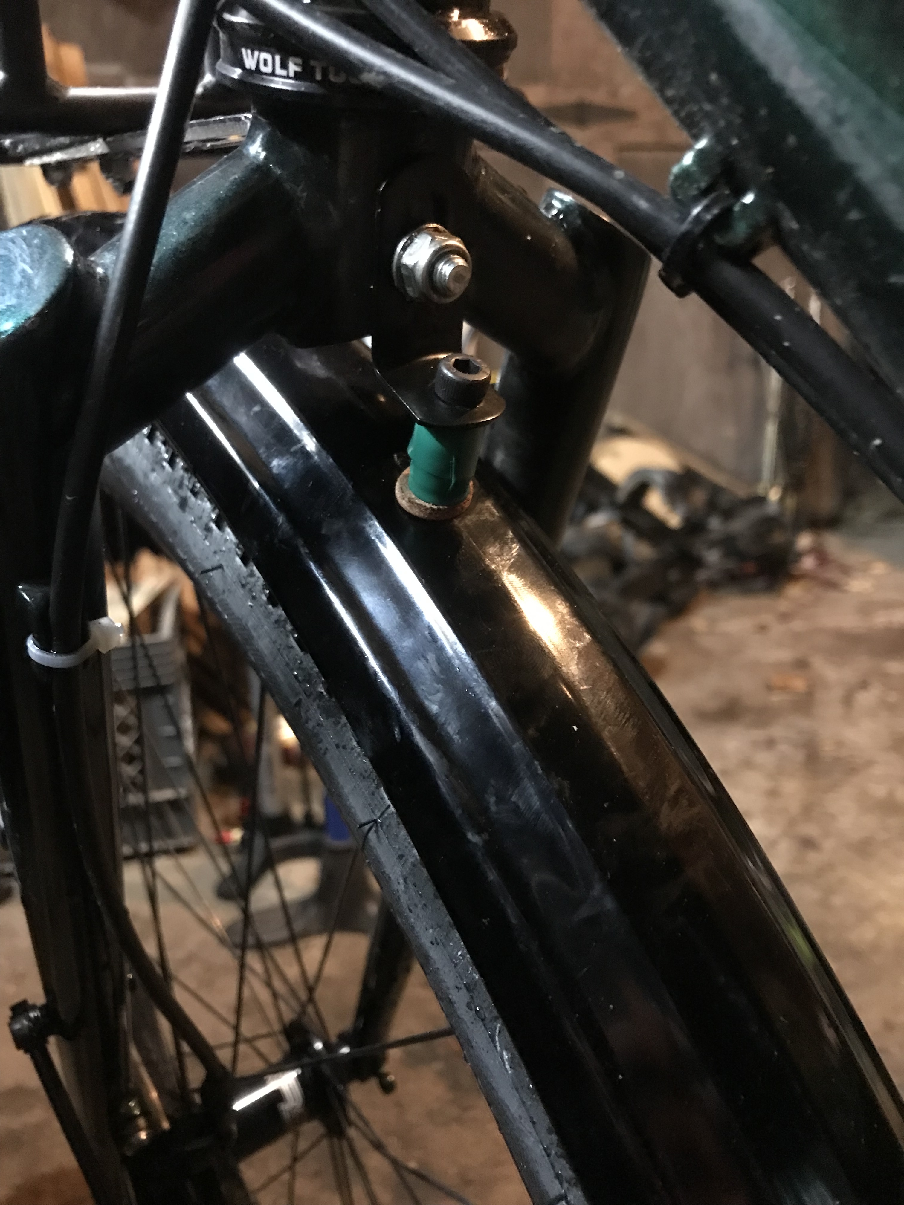

I bought some used VO fenders and spent 2+ hours Saturday wrangling them into my commuter and the fender lines still look like shit. Is there a way to get longer Daruma bolt, or a hack to extend the one that’s on there?
is the issue too much space between the fender and the crown because the fenders don’t fit into the fork?
How to install metal fenders, Part III: dimpling the fenders – Eléctricalités A.T. (wordpress.com)
No, it’s just jammed up to the top of the fork crown because that’s how long the bolt is, but then there’s a big gap to tire (endpoint fork).

longer daruma is just going to leave things hanging and rattling
never used it but that is what this is for
Fender Flute – Problem Solvers (problemsolversbike.com)

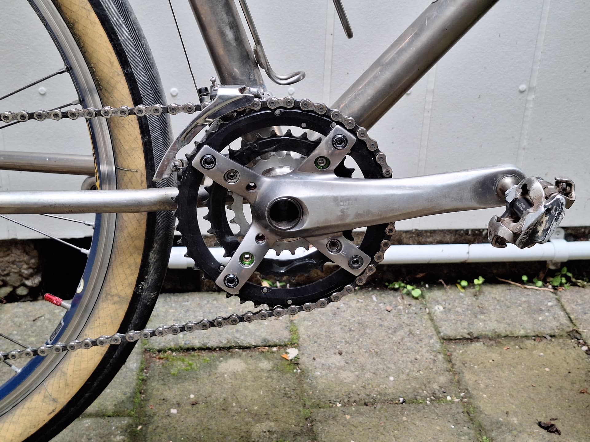

When I was given this 960 crank it was missing the middle ring, and being a typically dipshit XTR size, unobtainium. I actually managed to make a 104 bcd ring fit it relatively easily. Then I discovered the 22 tooth granny was terminally bent. Couldnt straighten it. Found an old 4 hole 22 and bugger me, it had the same bcd as the XTR one. Shimano dropped the ball there! Put it on the Ocoee and discovered the big ring was also very cubist. Was tweaking that and my sram 10 speed trigger failed. Went through my parts bin, only had two 9 speed shifters so pulled down the 10, cleaned it out to get the shifting back. Will resume outer ring tweakage tonight.
Longer bolt and about five valve stem nuts wrapped in electrical tape?
Or cut a stainless steel straw to cover the bolt with washers on either end?

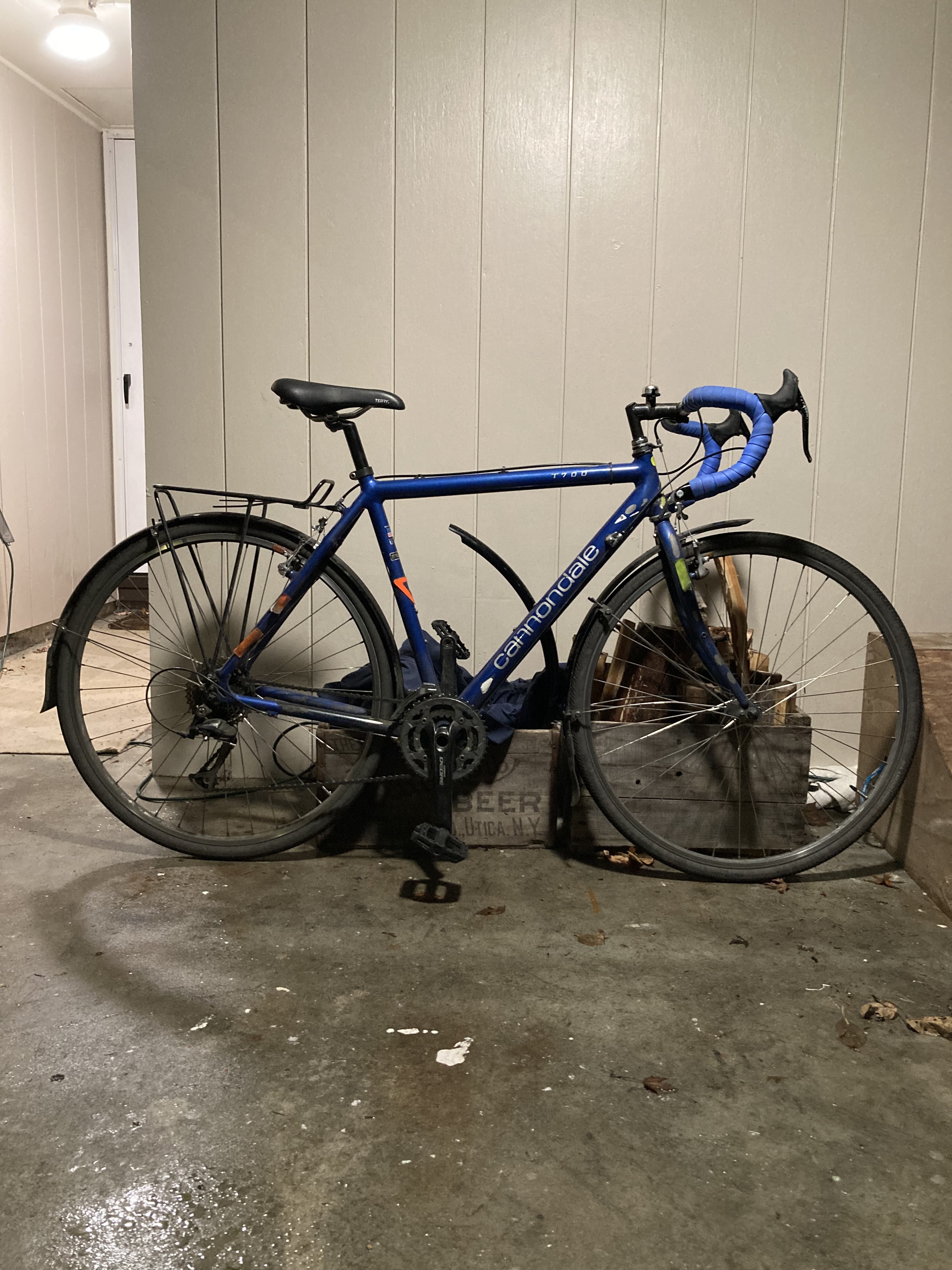

I went to the coop to see if I could get parts to put fenders on one of my bikes and came home with this for $100
The big question is do I build it up with a quill adapter and modern drop bars or build it as a townie with the 9speed Deore stuff I have laying around. I have a rando rack and a basket waiting for something.
Risers and fenders for a fast townie atmo
another vote for fast townie
