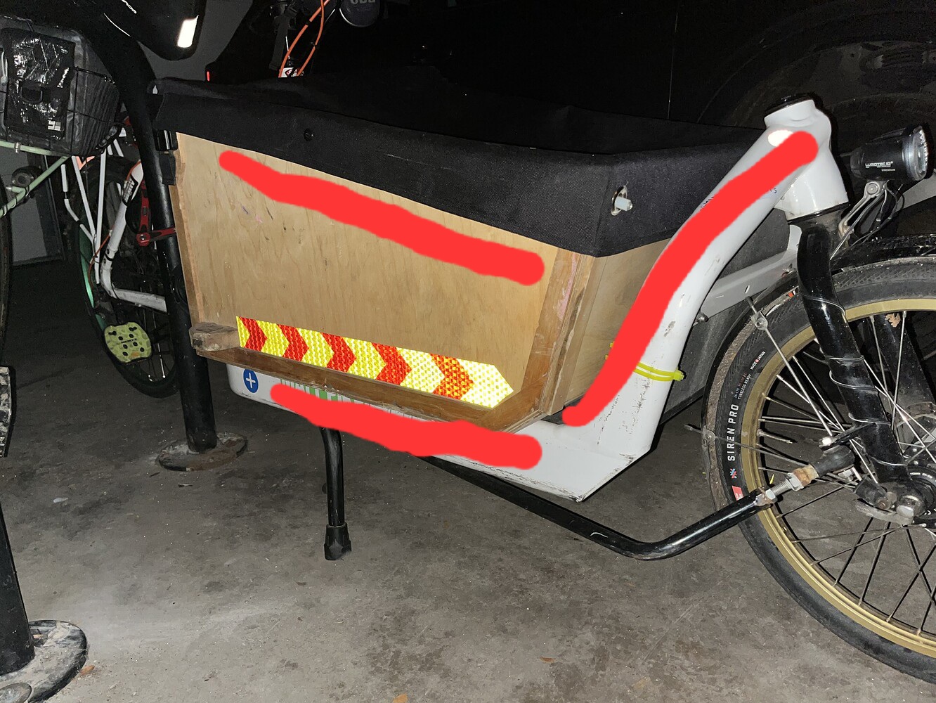

That width is good, gives you room to do this:
Then add the reflective spokey dokes.
Spoke things are ordered.
Should I just go hog and make my bike look like a European ambulance?
You can put all the tape on your bike you want… And you’re still invisible.
I know Todd, but I’ve gotta put my fear and anger somewhere and I figure that reflective tape is a more healthy outlet than street fighting.

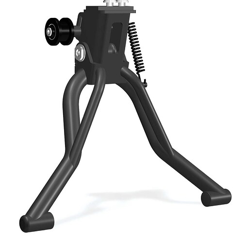

Installed the kickstand and panniers on the Boost. Getting the chain roller installed and adjusted was some fiddly ass work. Even though the roller is some kind of hard rubber, the chain is kind of noisy going over it when the bike was inside, but I couldn’t really hear or feel it on the test ride. The kickstand motion is pretty stiff right now and needs to be moved into either position.
The new kickstand let me easily adjust the rear caliper and give the rotor a little truing.
Next is to figure out some rubber or plastic feet for it. Not sure what to do there yet because it has weird feet.

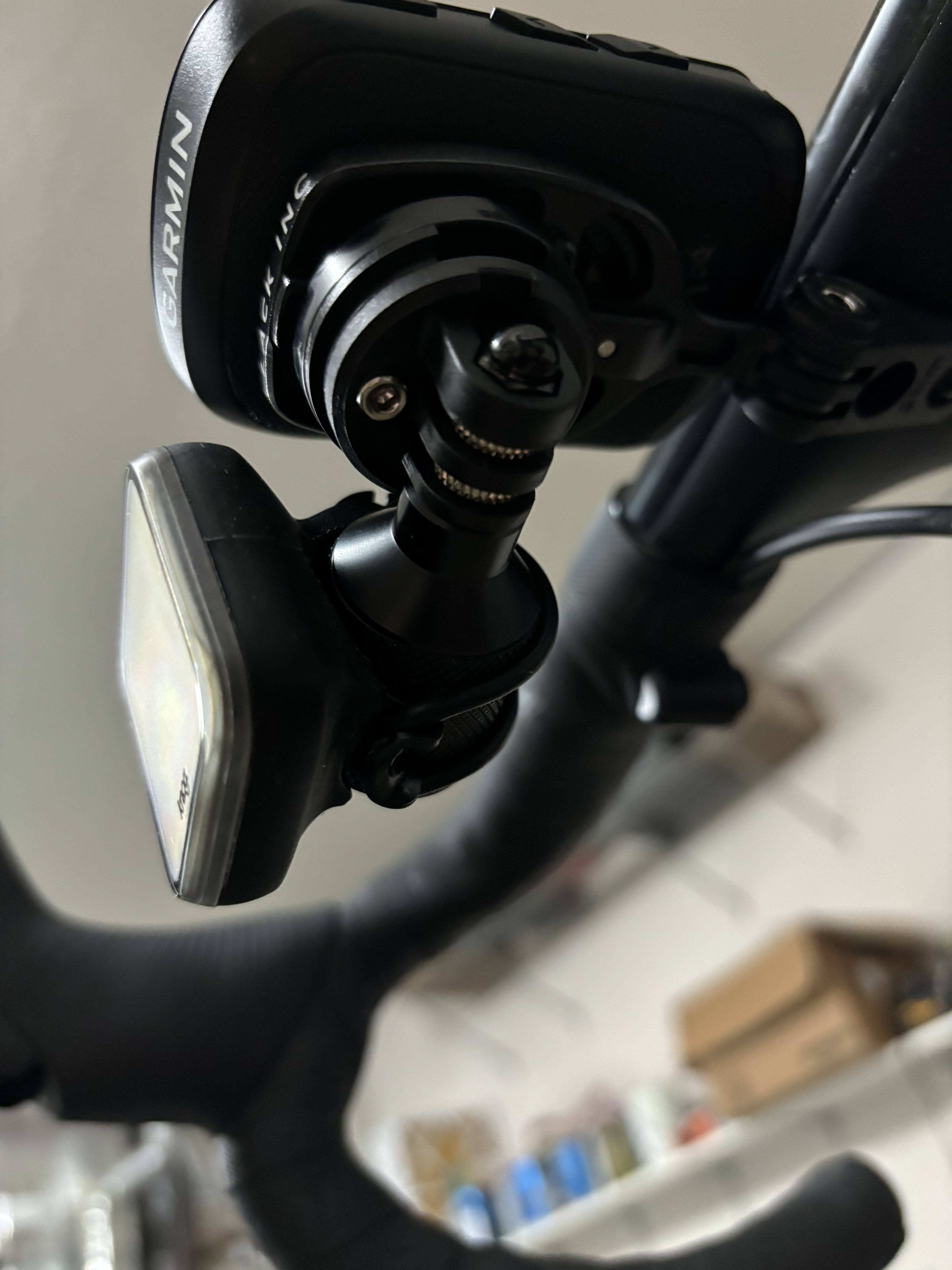

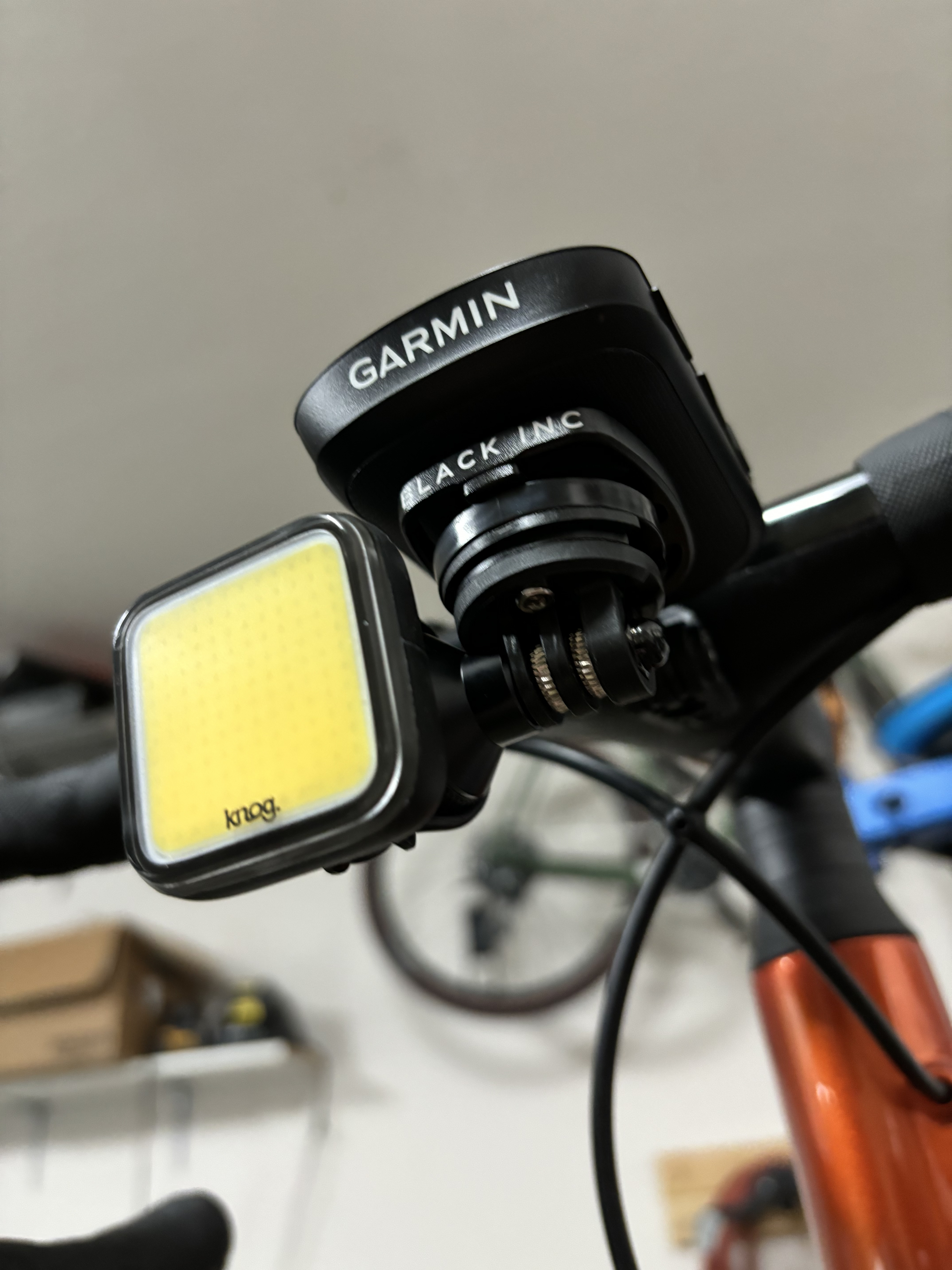

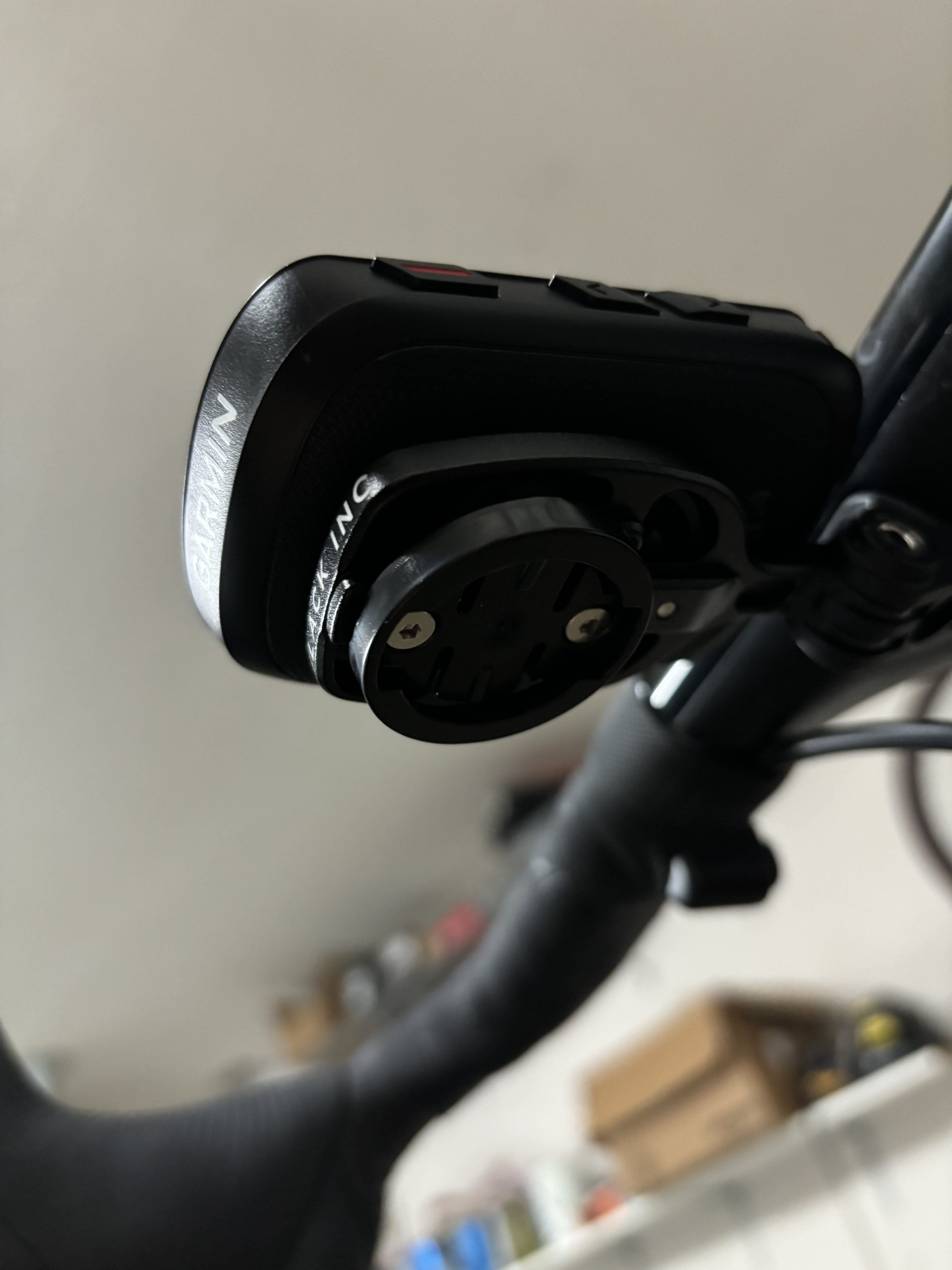

Revision 2 of my light mount. The Black Inc computer mount has two sets of holes for the puck and they go all the way through, so I mounted a spare puck on the bottom and used a KOM Cycling TG04 to mount the PDW Light Nug. I used some Presta valve stem nuts to space everything out.
This moves the light further away from everything and makes it into a little quick release job too. Unfortunately the light has to be removed to charge so the quick release functionality is not super helpful.
Slice some short sections of rubber hose lengthwise and glue them on.
Oh that’s a good idea because the inner diameter wouldn’t need to be too matchy like with a more rigid material.

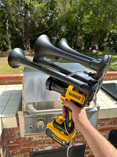

Might I suggest:
reflective tape is still probably a safer bet
no, a train horn is perfect

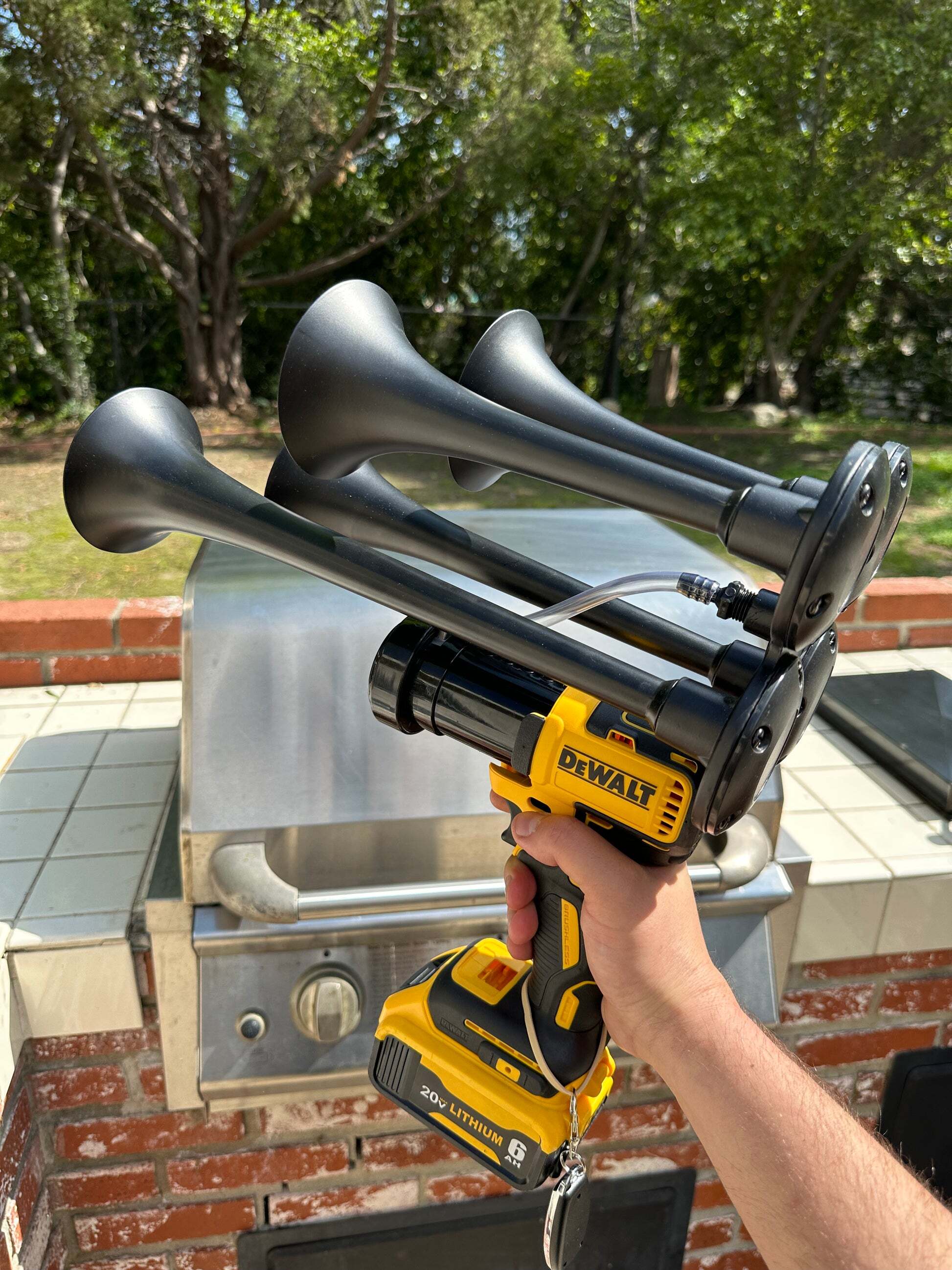

130 fucking decibels.
130 gecs is way louder than whatever 100 gecs you’re blasting in your lifted hillbilly truck
